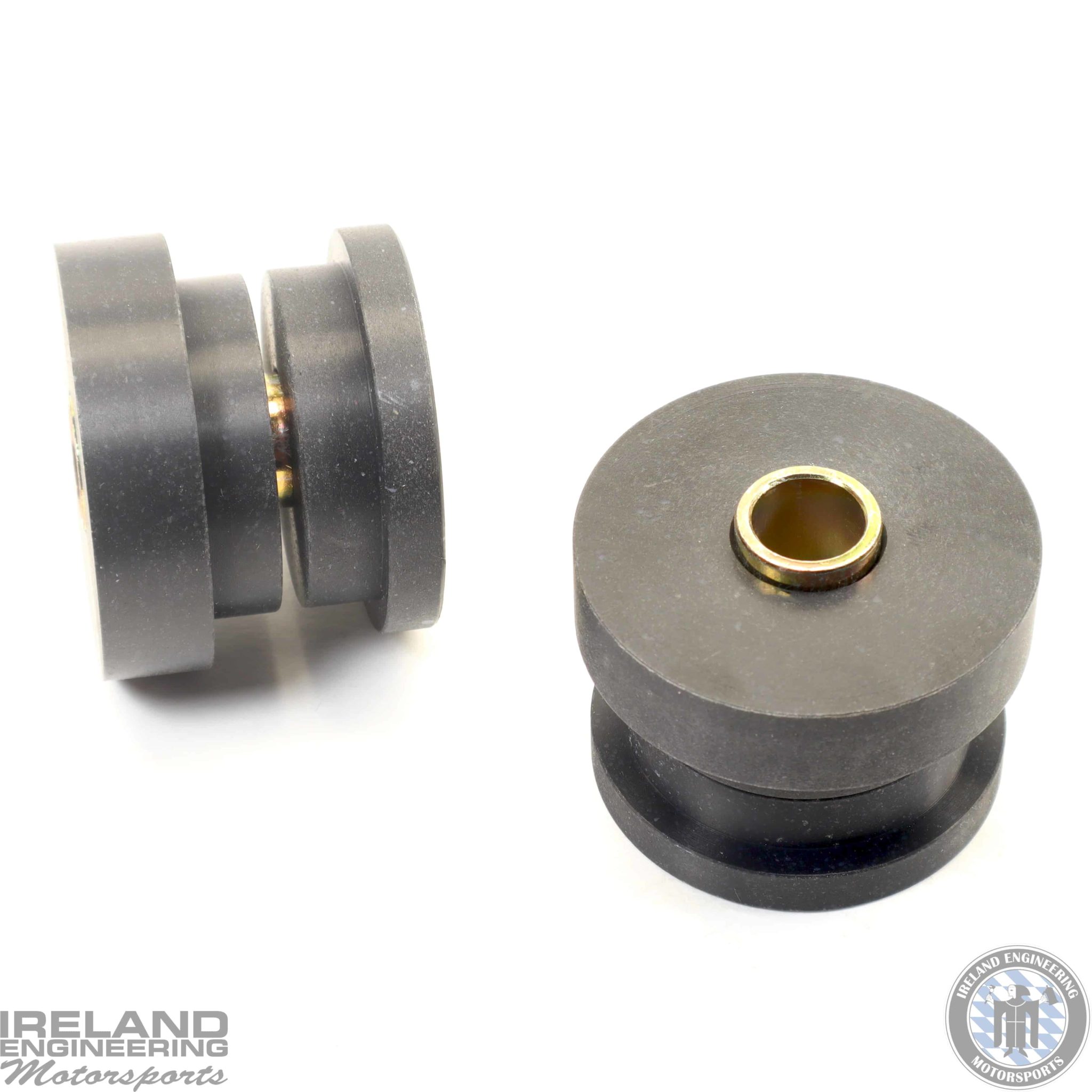

Don has recommended another source for the tension strut bushings and they don't appear to be available anywhere that I can find? Any other sources? I recall a post with someone using a polyurethane from a UK company...
Weld the crack and then have them bend the hooks back in shape. I bent them with heat and a long crowbar. Repaint. Coupeking used to sell the hooks, don't know if he still does, I bought a couple thinking I'd need to replace one, but gave them to other members because welding was the way to go for me.
Thanks all and to Drew, I can't wait for that. I was always jealous of Chris Macha's undercarraige (that sounds terrible) and zinc plated stuff. I also found a few obscure sources on eBay in Europe that sold some OEM bushings (FYI original part # is 31121116587 but is superceeded by 31121123552, apparently). Bimmerworld also sells them for $93 for the pair but sources in Europe. I will probably get this done after the Vintage in mid May where I plan to visit Chris Ohmes and Tom Baruch to get help installing replacement tie rods and centerlink. A few months from now my car will be driving like new, I hope.

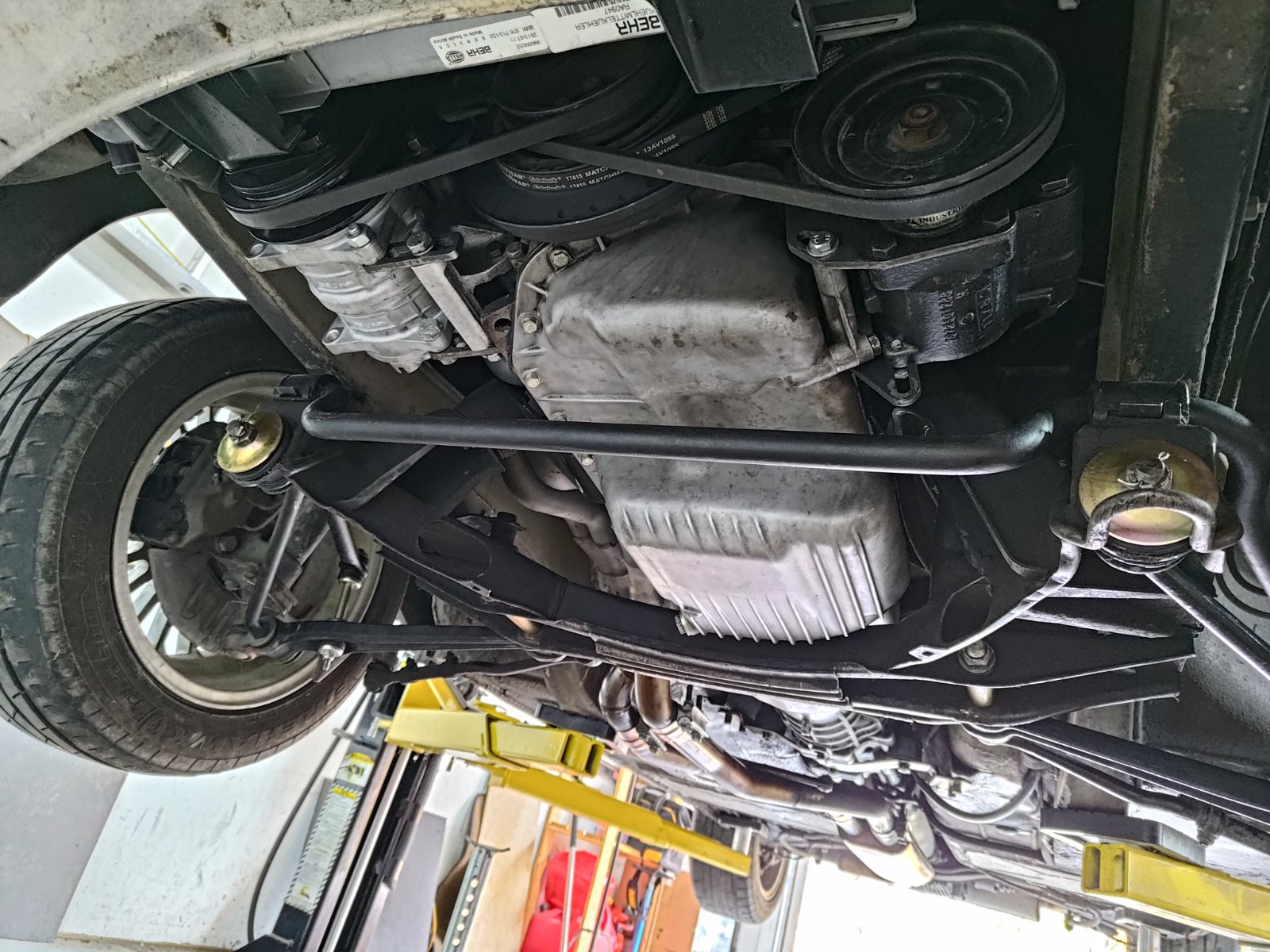

I decided to go ahead and replace my forward tension rod bushings as well as the large cupped washer. I bought both the stock and "motorsport" harder bushings from WN. I ended up installing the motorsport version as the ones I removed had a similar durometer to the stock ones from WN and were actually in good condition.
I also had some damage similar to what you described, I assume my car bottomed out as well at some point in the car's history. In my case a previous owner just cut the tiedown off on one side.
I never had any for / aft freeplay in the bushings / tension rod, however I did see a surprising amount of for / aft compliance in the bushing itself which is much less now with the harder bushings. Hopefully the weather will cooperate next week so I can test the theory. I'll post what results I get.
BTW Installing the bushings was "fun"...

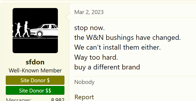

Wayne…. It is listed for both cars I guess… but as the above poster mentioned there are two… one regular and one harder. Both are available from WN.
There are several old posts about these parts that I had forgotten about.
In this one Don mentioned that the W&N parts are impossible to install.
In another one I haven't found he has a video of how easy they can be installed.
