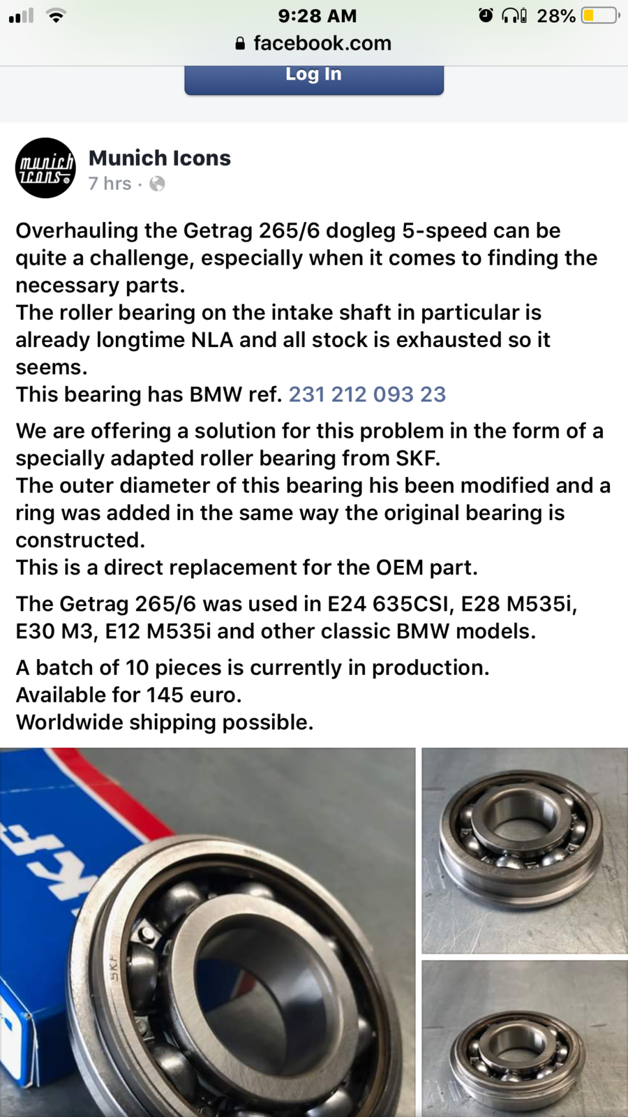

Saw this on Facebook, they are reproducing this bearing for those wanting to rebuild their 5 speeds. NMNA
What has me worried......
They don’t write the part number correctly and the describe the tranny completely wrong-
Wrong discription..
No such thing as Getrag 265/6 close ratio OD.....
Their post is wrong and right. The bearing they are showing is for the 265/6 (23 12 1 209 323), and is rather complex due to the step in the outer casing, as well as being NLA. If they are in fact selling a replacement for 145€, I would consider that a pretty good deal. The bearing for the 265/5 (23-12-1-205-197) is still available from BMW for about $85.
Well their heart is in the right place. We all know what it is for. The price seems fair.
I’ve been following this shop on FB. I sold them some parts recently. I think that their scene points are tight and they have mad instagram cred. Someone from BE will need to chime in on their restoration and fab skills.
FYI- going rate for those bearings NOS is 380.00
None of mine are for sale. Pure unobtanium.

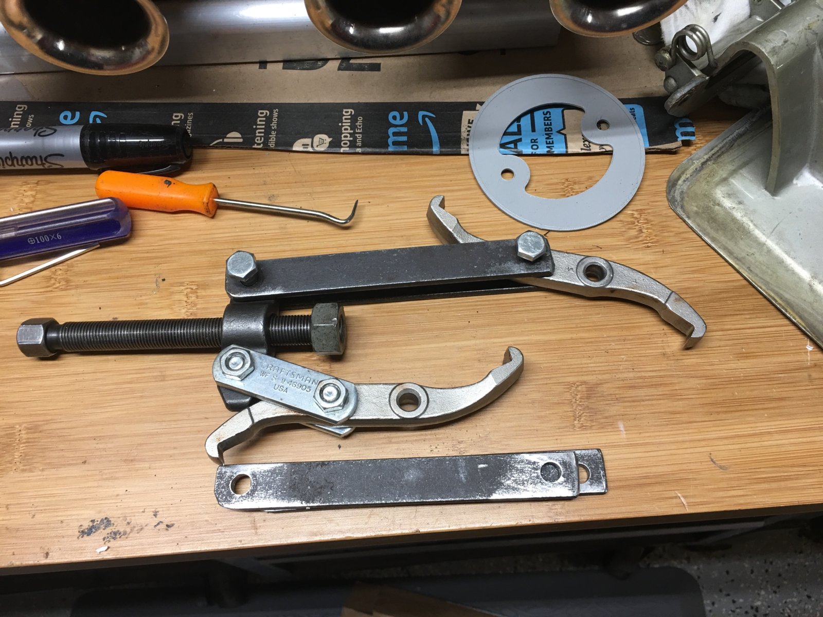

You are correct @Henrik. I don't have specific working knowledge of the G265 internals, and perhaps should have avoided commenting. In retrospect, like most days I didn't put much brain power behind my response. While the comments and videos may be common sense for some, I suspect that a good bit of folks on this site have never pulled a race or bearing from a rotor, let along a transmission. Some may find the video useful and interesting. I wasn't trying to dismiss your efforts or speak out of turn. When I rebuilt my O20 5spd I had to make a number of special tools, including a case-splitter and extend the jaws on my puller. Most two jaw pullers have little bars that serve as the pivot point. If you make the longer you keep the teeth on the jaws straight, providing better engagement and the ability to reach otherwise inaccessible components. This is also common sense to some and likely still inapplicable to the topic at hand, but perhaps helpful nonetheless. Likewise, avoiding an angle grinder on gearbox internals is common sense to many, but posting a disclaimer is equally helpful.
