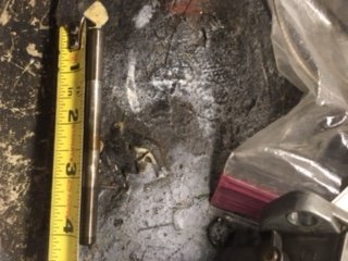

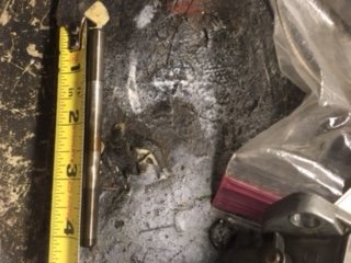

My car was running perfectly , did not start it for a week and then it would not start. Runs for a sec if I prime the carbs. I have pulled the lines and they are clear from the gas tank to filter, filter to pump input and on the output side of the pump to carbs. I cranked for 30 seconds a bunch of times and I got a little gas only. I pulled the pump bar which measures as you see here. I just don't believe that the bar of cam would be an issue all of a sudden. The fuel pump is a NOS Pierburg AG (the name is on it, not ground off) but I also tried the original pump which worked when I bought the car and a new spare I had, all with the same issue. No gas delivery. I just am hesitant to shave the spacer since this was abrupt and not a gradual thing.

Hoses are brand new, picture is of push rod, gas is fresh, car ran beautifully last week. All filters are new, tank was Por15 treated a few months ago by me. I can pull gas to the filter with suction so metal line to firewall it fine. Gonna go gas from an external can at the filter level and go from there.

I had read a bunch of posts and one spoke of grinding down the spacer block so that is where the idea came from.
