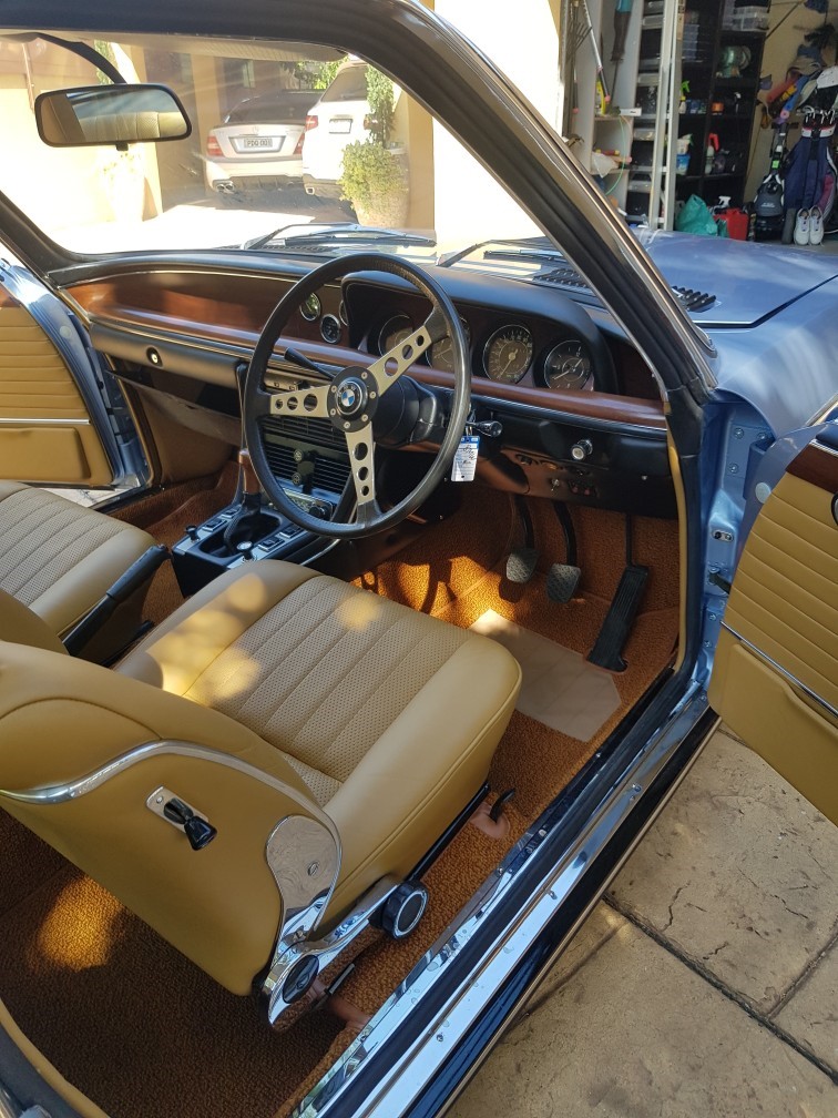

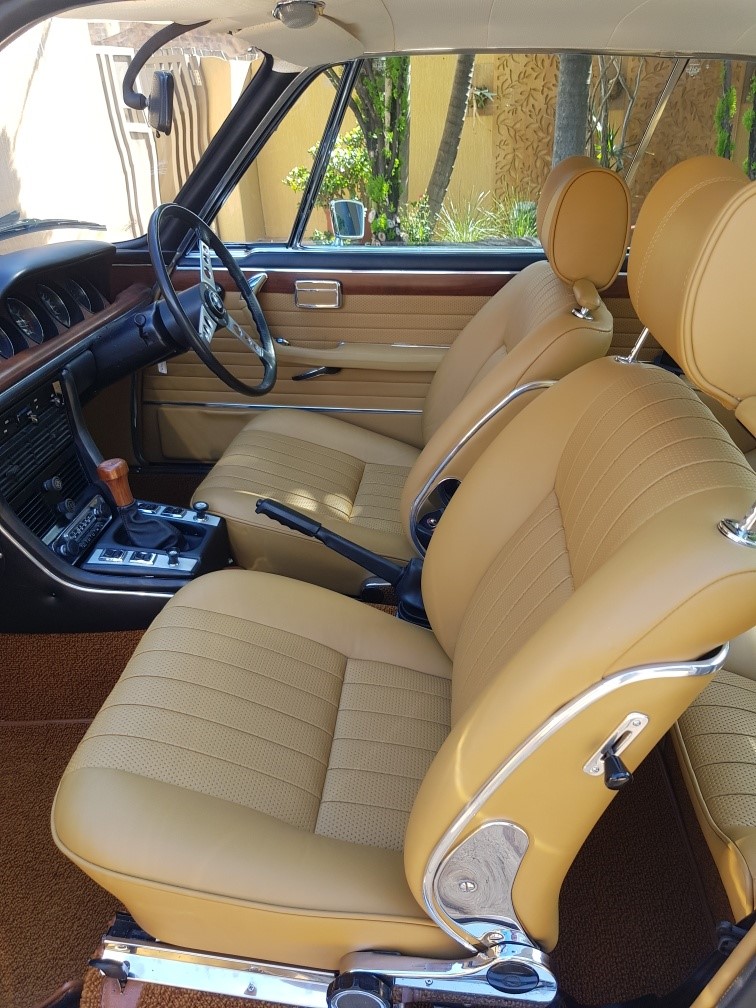

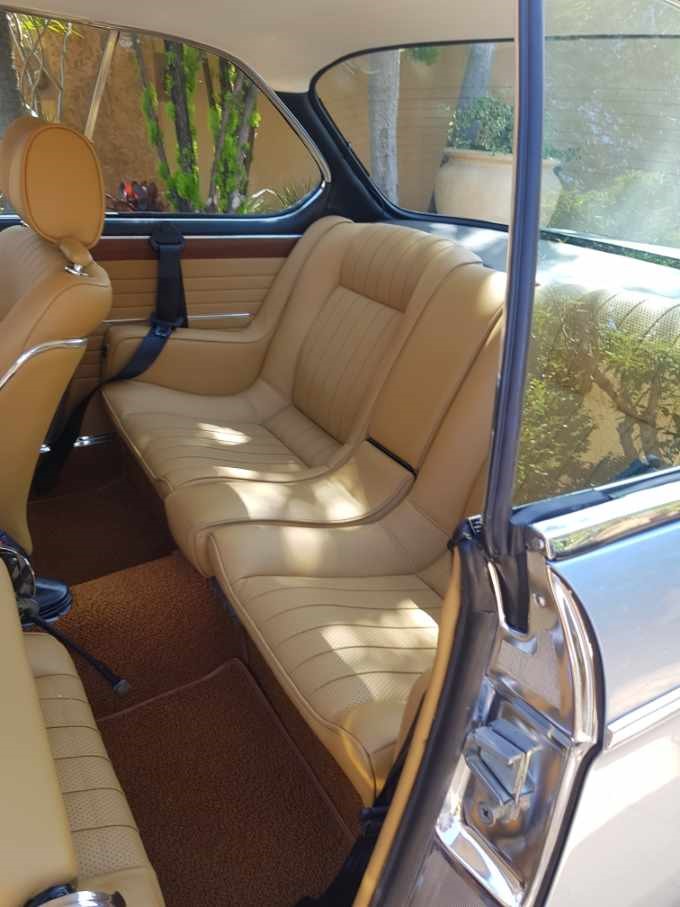

Long time coming - new rear seats, roof lining, carpet, front and rear glass in. Sigh of relief with the new front screen not causing problems, though he took a few goes at it.
Had to make a few minor compromises but I think it turned out quite nicely. Yes I deleted the rear ashtray - which was not a compromise.
Replica basket weave embossing is hard to see in this shot. When I get the car home I'll take a few more.
Now to work out an aesthetic seat belt arrangement.

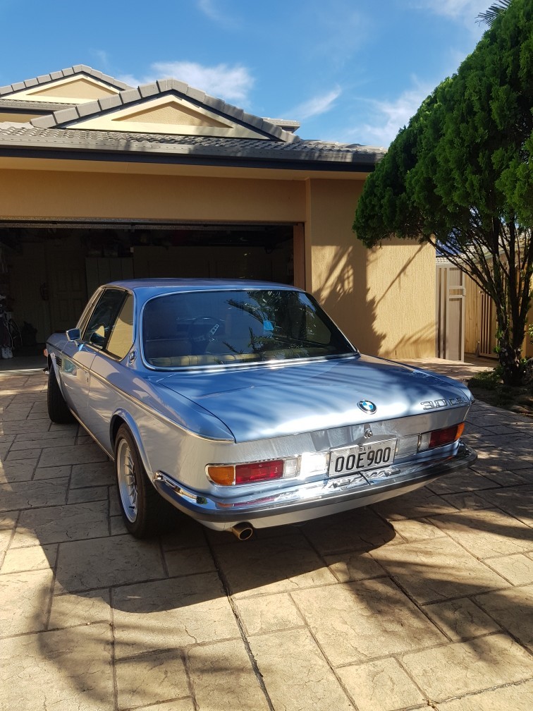

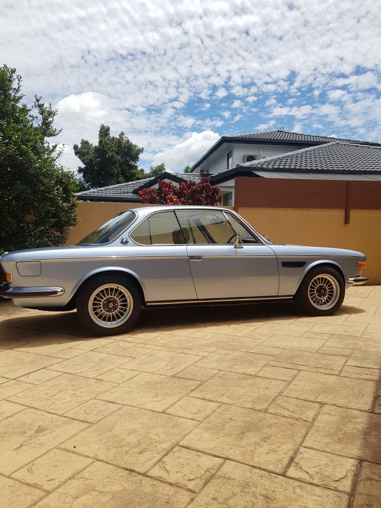

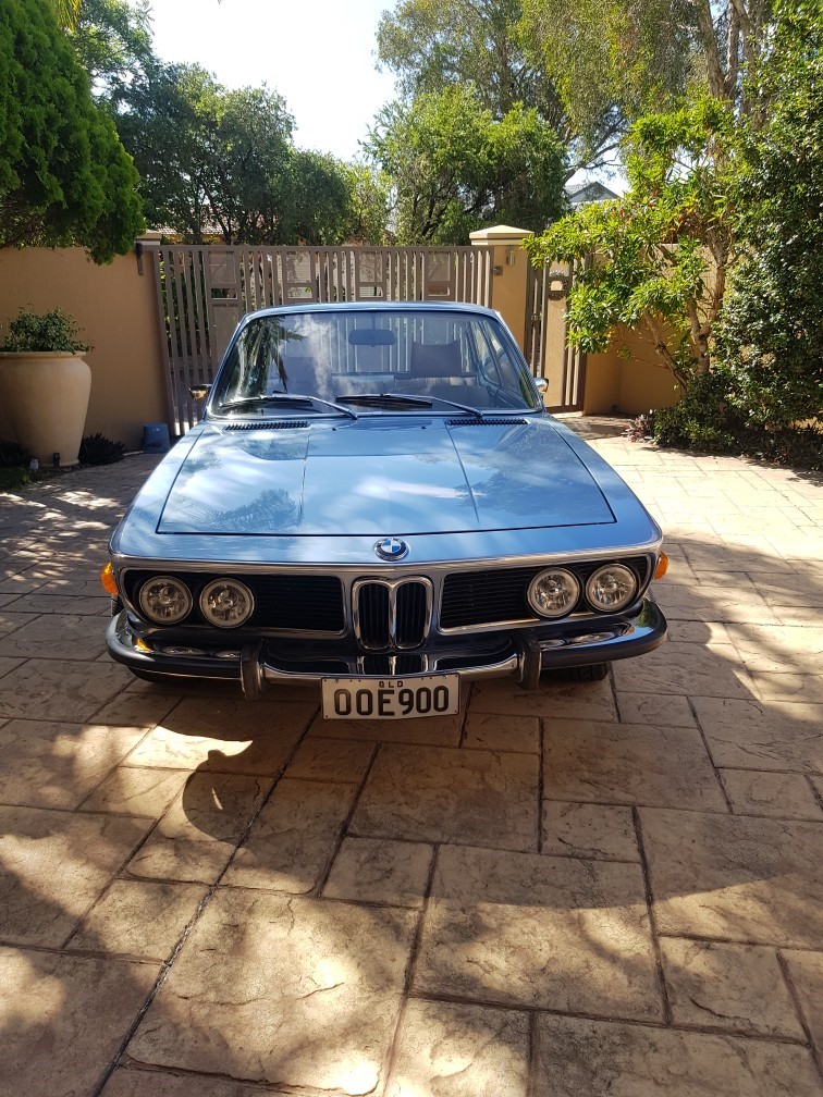

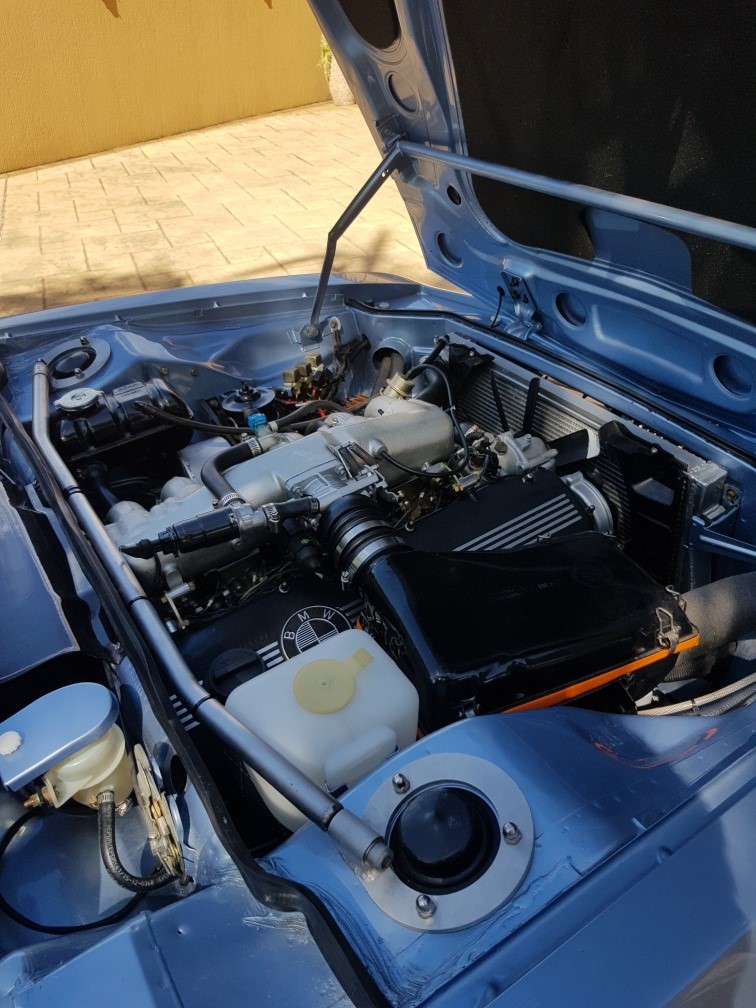

Time for a regular update. Car is finished, though I suppose they are never really finished.
It's the usual M30B35, 5 speed Getrag, Carl Nelson suspension resto mod. 400+ hours on the body plus blocking and Glasurit Fjord. Engine fully rebuilt with the assistance of Don. Not a Don here in Oz but THE Don. 10:1 forged pistons, Scrick 284, big port head. HD Ireland Engineering rockers. Fully sequential Link engine management. Custom built headers / extractors / manifold / whatever. New just about everything from W&N and others. Most of the reused parts have been refurbished. Reconditioned LSD.
Dyno - 192.3 RWHP at 5200 rpm and 225 FtLb at 3750 rpm.
Given the time period I have forgotten much of what was done and spent.
It was always meant to be a project - "Build a car". I can't even remember why I chose to do an E9. Perhaps a picture reminded me of them?
Anyway here it is. Some pictures -
