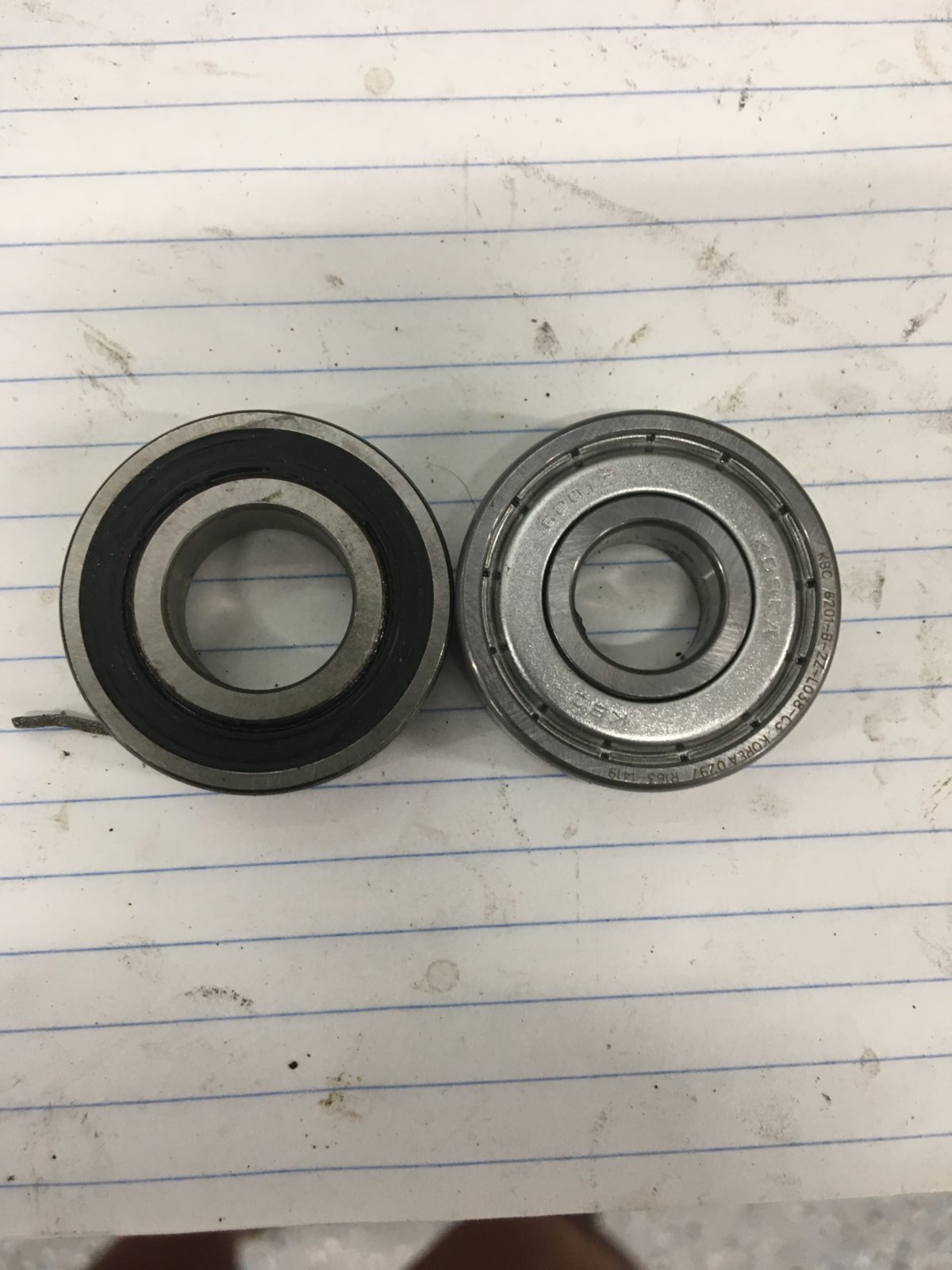

When we first bought the 2800CS there was what I thought a lot of transmission noise from the ZF transmission. After pulling the trans I found the pilot bearing was wrong and too large for the pilot shaft (pic attached). Hoping this may have caused the noise, a new clutch, throw out bearing, etc was installed. The noise is still there and reading this post it sounds "normal". The other possibility could be the wrong pilot bearing caused the front transmission bearing to wear.

Is there any consensus on what fluid is recommended to quiet the beast? Thicker fluid, STP, witches brew?
While we can live with noise we certainly don't want total transmission failure.
