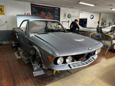

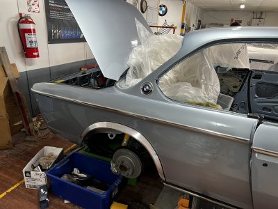

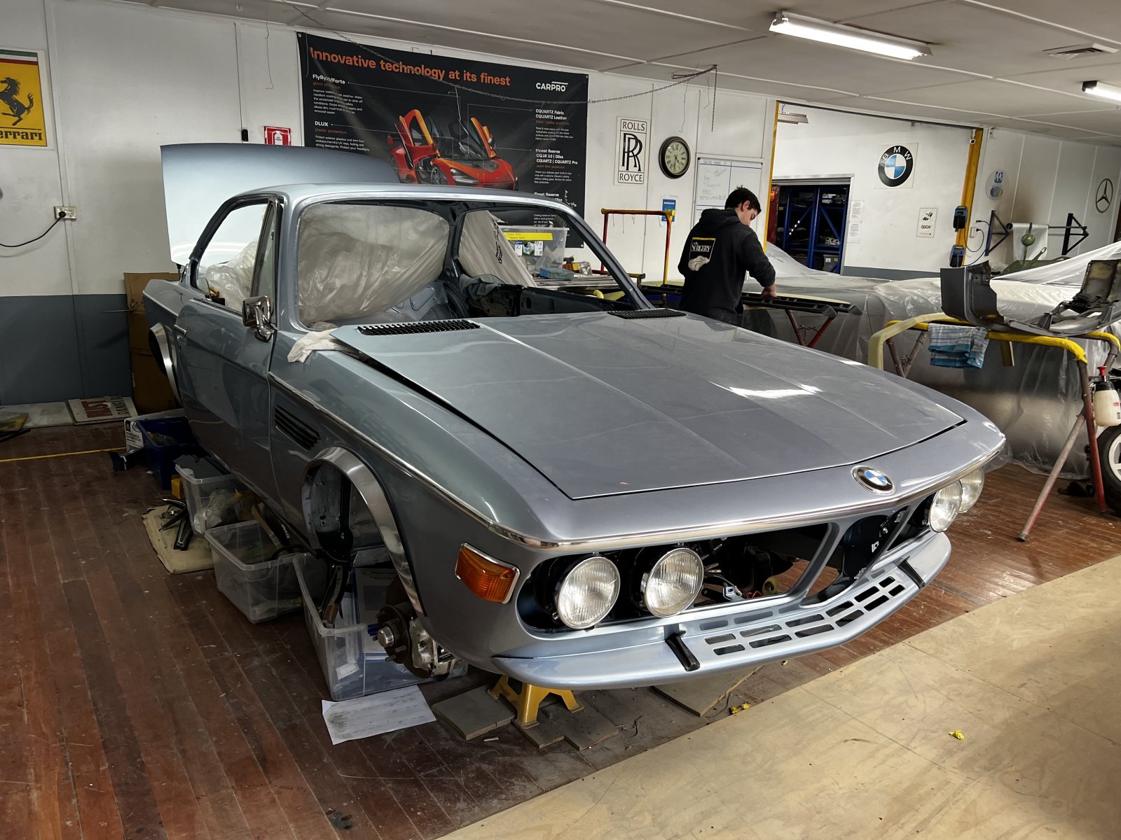

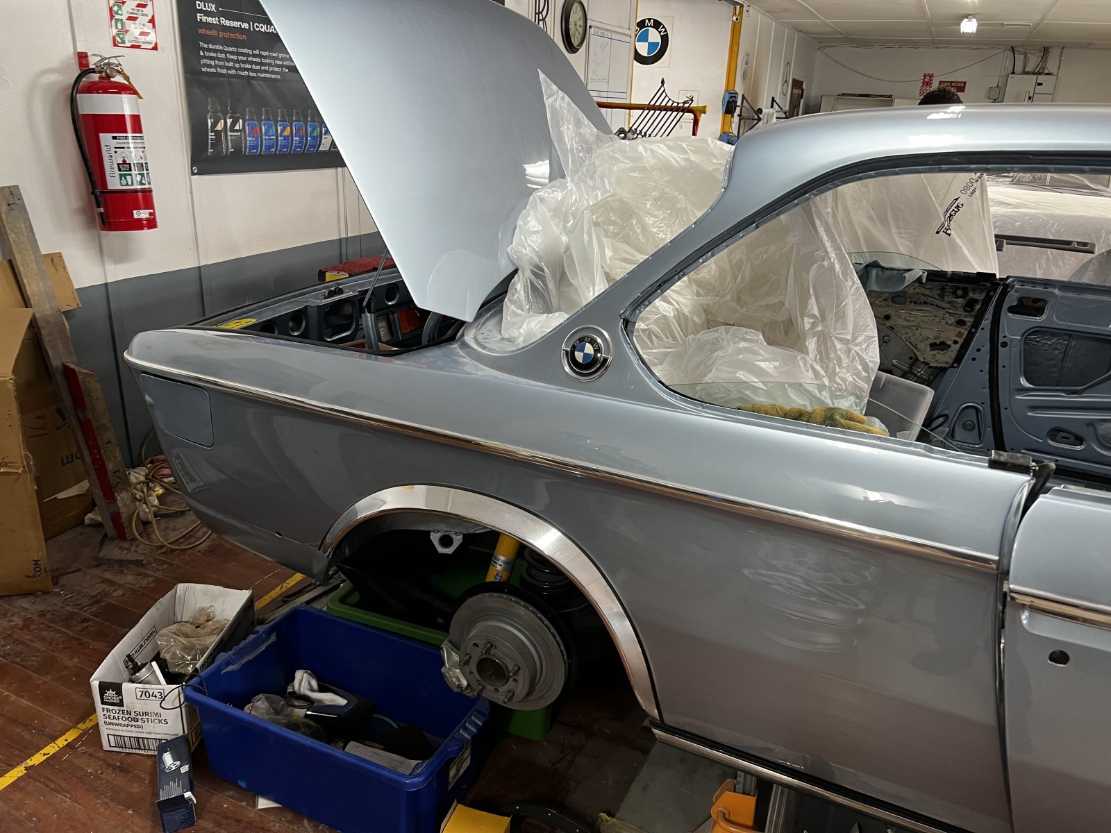

Latest restoration photos added purely because it is SO pretty it hurts!
