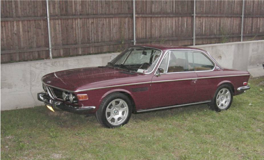

Nose is too high
yes Steve's car has a good look to it w/ the 215/65's ... but i know he really yearns for a set of Alpina 16's
Probably a little of all of those suggestions! I have read other's measurements here and the drivers side typically is a little higher. Will be curious to see the after measurements.
A full or empty fuel tank would easily make and 1/8-1/4" difference. Perhaps the measurements should be taken with a full tank and a person sitting in the driver's seat.
My couple is a little off because the battery was moved from the left front corner to under the right rear seat (to add to the fuel component effect). So combining a new style rotary AC compressor, an aluminum radiator & relocated battery probably removed 55-60 lbs from the front end - hence the front is a bit higher that I would like.
i would say that you are in need of some 8" wide rims w/ 225/50-16's on the back. everyday when i back out of my driveway ... i see the car sitting in the garage, and it now looks so much better with the wide rubber on the rear shoes. it handles quite a bit better too.
I don’t believe the wheels I’m running are available in 8”, only 7” :cry:. To me the popular turbine and basket weave wheels are just too hard to keep clean, these are a piece of cake and I don’t have much money in them so I’m pretty happy with them. I do have wider tires on the back which helps but yes, I think 8” rims in the back would probably look really correct. ~ John Buchtenkirch
Hah - yes I have Alpina envy but I only need 14" to feel adequate! Some day when all my other maintenance and cosmetic issues are done (ever?) I will treat myself to a nice set of vintage alpinas.
