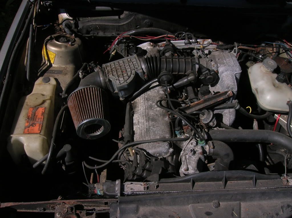

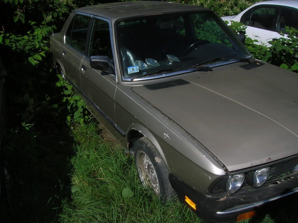

Just picked up a 1986 535i 5 speed parts car. I'm planning on yanking the engine/trans next weekend after I get some maintenance done on the VW.
Should be an interesting time. My uncle that works on E30's mostly said that the speedo drive cable is in the rear differential for the E30. Can anyone confirm that on my Bavaria? If so that would totally rock. I could put the 5speed in it then!
Pictures of the 3.5 to come soon. The 3.0 is still not moving. I'm pretty well given up on it. I really wish it would come around. Then I could build the 3.5 to turbo specs. All in good time though.
Stole all of these pictures from garethashenden (ultimate bimmerforum), who I bought the car from, great guy! Its currently not as complete as in the pictures but you get the idea.
Your Bavaria has a mechanical speedometer. The 535 (and E30s) have electronic speedometers driven by a sensor on the differential. Those differentials are not easily interchangeable with your Bavaria.
Ah okay. Good to know. Maybe I can find someone that wants to trade my 260 for a 265 lol. The engine bay looks pretty messy in the 535. I'm not sure if it's just because it was partly taken apart already or if someone put in aftermarket wires in to support amps/speakers/fog lights. We will see, hopefully gunna pull the whole engine/trans (best to keep them together right?) this weekend.

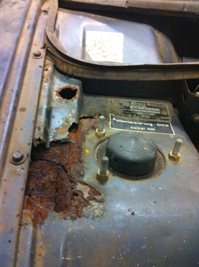

I direct your attention to this picture:
http://i189.photobucket.com/albums/z246/gunmetalgreen/BMW Bavaria/cee30de4.jpg
And now allow me to ask a question -- are you proficient at metal fabrication? Do people regularly compliment your finesse at welding 20 gauge mild steel? How is your work on an English wheel?
If your answers to these questions are "very", "every day" and "better than Ron Fournier", I will resume my lurk and enjoy watching as you resurrect this Baikal jewel.
If your responses were more on the order of "I made a dustpan in shop class", "no", and "English what?", then I have a further question -- do you have $10,000 that you would happily pile in the middle of your driveway and set on fire?
If the answer to that question is "no", then you need to do the following -- STOP WORKING ON THE ENGINE. IMMEDIATELY.
Before I continue, let me provide some context. I started wrenching when I was in my early teens, working on tractors and other equipment on our family farm (contrary to rumors, I am not old enough to have driven a plow behind a stegosaurus). I successfully used an Italian car for a daily driver for the better part of a decade. I have owned at least one of every BMW variant built between 1969 and 1988 (and a smattering of newer ones), using most as regular transportation. When I left the US in late 2009, I cleaned out my garage and sold/donated/junked enough parts to build 3 complete M30 engines. I'm currently restoring a Land Rover Defender that lived in the Orkney Islands for the last 6 years. The pile of rust created when I cut the rot out the Land Rover frame was deep enough to bury a mature Labrador.
I say this to establish that I am not a nancy-boy checkbook mechanic who trembles at the sight of a rust bubble.
On an e3 (and even more so on an e9), rust is like a ****roach -- see one, you have 10,000. The condition of the front shock tower says all you need to know about the condition of the rest of that car. If the shock towers are gone, then rockers are certainly gone. There is no unit left in the unit body. I love e3's, so it pains me to say this, but that shell isn't worth saving. You'll invest another 100 hours getting the engine running, fixing the brakes, and dealing with myriad other mechanical issues. Then you'll set forth with a light heart on your inaugural drive, and innocently cross a set of railroad tracks at 19 mph. You will later wonder how it was possible that something which appeared so solid could disappear in a whirl of blue and orange dust, leaving you sitting in the middle of the road surrounded by a Dali-esque arrangement of BMW mechanicals draped in Tobacco vinyl.
Here's the good news -- you have what appears to be a relatively original and unmolested e3 parts car. Ignore the sheet metal. How are the front seats? The dash top? Look at those rear fender covers -- not a crack, not a hole! Do all you can to keep them intact. What I can see of the bumpers and brightwork looks good. All glass looks good. You don't have a gold mine, but you do have a pile of parts that someone will want. And you're on the east coast, where most e3's that are not in the hands of enthusiasts are in junkyards, stripped to the bones.
Alternately, if you want an e3 (and who wouldn't?!), you have all the parts to take a shoddy but less rusty example and make a nice car. And a shoddy running one can be had for a quite reasonable price -- a fraction of what you'd spend trying to save the one you have.
PM me and I'll give you the email address you need to join the S6R mailing list. You can bounce options off the members there and decide how to proceed.
Now, STOP WORKING ON THE ENGINE. IMMEDIATELY.

Since you have the car and if in a moment of lucidity you make the difficult decision that the gross national product of any third world country (Canada for instance) would be required to make it perfect (or even good....decent....ok...) then my advice - taking a cue from Tony - is to take the car apart. Inside and out. Top to bottom. That includes the engine, trans mission and rear diff. See how everything works and what is worn out.
Separate every component, undo every nut and bolt, drill out every spot weld and create two piles - one of useable and valuable (you won't believe how the sum of the OEM BMW pieces is worth so much more than the whole thing currently is) parts and the other pile that is .....rust. Put the cleaned useable parts aside and sweep the rest of the pile into a dust bin and toss it.
You will also learn an incredible amount about how these things are put together and have a prefect starting point for a resto rebuild reconstruction of a less porous chassis.
Or just continue on with the valiant attempt to make this car work if not right.

If it wasn't for that really nasty looking patch of rust on the inside of your fender you could consider just driving it the way it is but that rust isn't gonna hold together for long once you hit the road. As for parting it out,there doesn't seem to be much of a market for used Bavaria specific items as you can buy new cheaply.They made 9 times as many Bav's as coupes and I guess there are lot's of parts left in warehouses.Check E-bay for what stuff sells for.Parts that are common to coupes and Bav's include most everything under the hood,trans,pedal assembly,the headlight buckets and grilles,center grill,side marker lights,inside and outside rearview mirrors,various electrical relays under dash,inside dome light,heater assembly and blower,NOT center console and climate controls,front armrests,seat rail "chrome"cover,trunklid toolbox,roundels,wheels,rear brake calipers,headrests,nuts,bolts,chrome trim screws and probably a few other things I can't think of right now.Try starting with an ad on this site,e-bay and craigslist.Try not to take stuff off car until someone requests it,easier to store stuff on car then you know right where it is.Good luck and check out E-bay for running Bavarias,they sell for a lot less than coupes.
Thought of a couple more,door ashtrays,front door panel map pockets,all four doorjam door latch catches,rear axle shafts,various front suspension and steering components.
