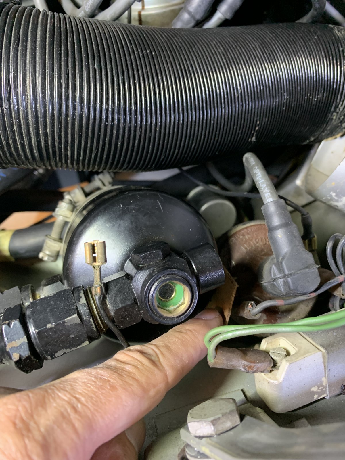

A while ago we heard briefly about an intermittent engine cut-out occurrence. Have the grounds, electrical connections wrt ignition (and fuel hoses while you're there) been examined/tidied?

Happy ending. Terry Connors to the rescue it was a shorting issue. This was the issue I had posted in the past and had not gotten around to figuring out. Cardboard provided a temporary fix.Tomorrow I will move the wire further away and get rid of the cardboard

I was installing a new red Bosch coil yesterday and for the label to be visible, the positive terminals are next to the AC drier. I thought at the time that this could be a bad situation. What I believe to be, the original coil had the negative terminals next to the AC drier. Which way was the original orientation for the coil?
Edit: According to the Blue Books the positive is towards the drier so I removed the middle spade which was too close to the drier.
