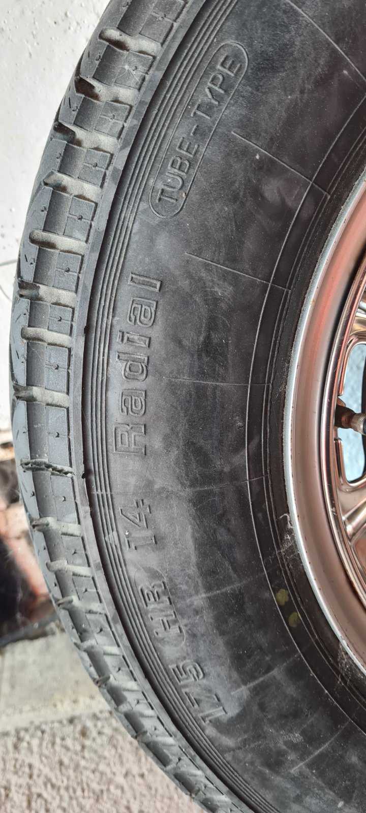

I know there are no issues running them without tubes, my question was really why were the factory using tubed tyres in 1972 when tubeless were presumably more the norm by that time ?. Photo shows my original Continental spare.
The stock wheels have a rim noted as H2 which means it has a bead to retain the tire without a tube. However, my V.69 2800 and IV.73 3.0CS handbook both note well-base rims with tubed tires although the 3.0 says radial as well.

The fact that the wheels are H2 makes it even more odd that they left the factory with tubed tyres. Even the most basic Mini was fitted with tubeless years before this.
