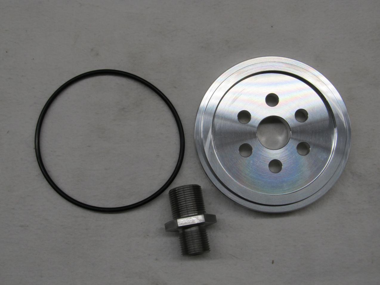

Hi. I have the original style Oil Filter canister that bolts from the bottom; such a PITA to change. After some struggle, I eventually used a small bar clamp to compress the canister to the oil mount then used a zip tie around the bar clamp and canister to prevent slippage. Made it significantly easier to screw in the bolt. Not sure if this method had been mentioned before.
Possibly simpler than removing the mount with canister.
a photo will certainly help to understand
A shorter bar clamp could clamp to the top of the mount. Mine had barely enough purchase on the lip but the zip-tie held things taut.
Hopefully useful to someone.
