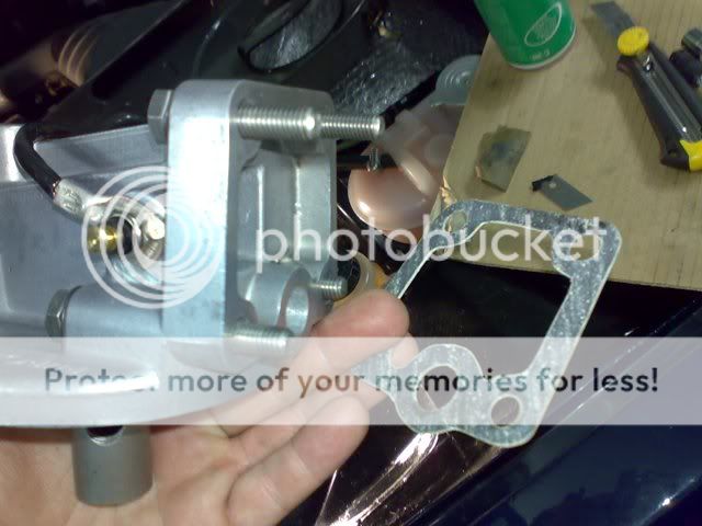

do not put anything on the gasket, you dont need it, the gasket will do its work, the only issue is if you find difficult to install the gasketin the almost vertical wall of the engine block, in that case there is a product to position gaskets that you can use (the one i use is from loctite)
anyway in this case you dont need even that product, because you can guarantee the position of the gasket easily if you maintain the gasket in the filter support with the four bolts, then you will not need anything

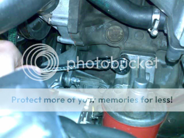

Thanks I have all my original parts and will attempt this, this weekend. I already surveyed and loosened the bolts that mount the housing to the block. I was a bit afraid that I might shear the bolts. They were tight but they loosened up OK. Got too dark so I'm going to get into it tomorrow. Will let you know how this goes. It actually seems very simple and straight forward.

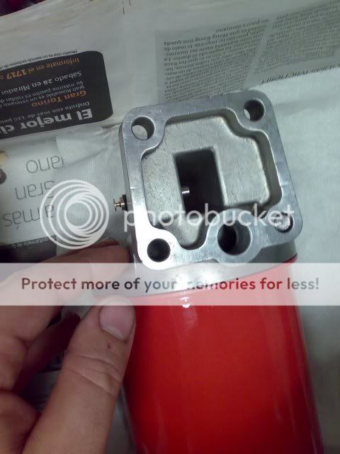

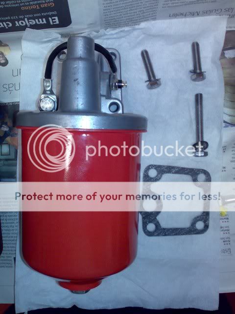

congratulations on the bolts, yes i had the same fear, but they went ok, if possible change them to new bolts (i did this with stainless steel bolts), if not now, measure them and buy them for the next time
i do not have a detailed pictorial this time, but hope this will help
(be aware that i did a peculiar installation of the oil-temp sensor in the original filter support, so you will see this odd thing there also)
good luck !

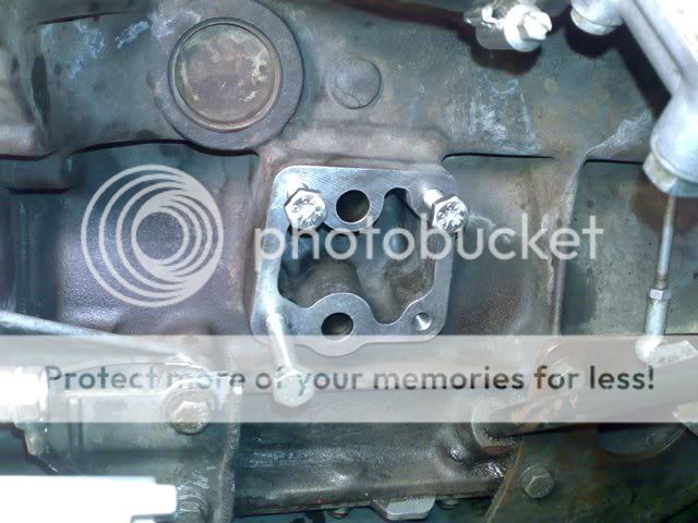

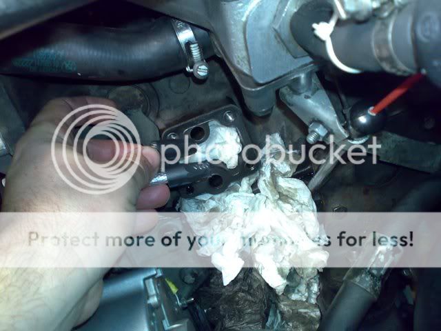

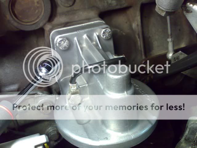

these are two rubber caps i prepared for avoiding dirty and pieces entering the engine while i was cleaning out the old gasket (can you see the old gasket there, glued to the engine block?)
surface cleaned and finished, and a test of the easyness of the introduction of the bolts (check the length, they are different)

OK just finished. Followed all of deQuincey's suggestions. Thanks very much. When all said and done. This really is quite simple. Everything is rather easy. The most difficult part of all of this is the gasket. As deQuincey say's it now baked on! At first glance it does not look like there is even one there. But after careful inspection and a bit of probing it was in fact now part of the block. It must have taken me over an an hour just trying to scrape the thing off. If the next time I change the filter this is not baked on, this change would definately be a snap to do. The only thing else to look out for is that the gasket between the canister and Filter housing needs to be carefully watched when your putting the canister on. It's a bit loose. Maybe just on the one I got but make sure it does not get pinched as you tighten the bolt. Otherwise a piece of cake to do. Thanks again deQuincey!

So De Q, I am asking for a few of your secrets
How did you clean up the manifold so well?
I tried to do mine this weekend and did not get it anything like as clean as yours.
Also, is there a trick to spill less oil on the engine when you remove the manifold? Whilst I did not spill a great deal of oil using the De Q method, I did spill a similar amount when I change the filter the normal way by unscrewing the canister only.
Lastly, I see that you painted the canister red, it looks great. Is it any special colour? Did you do several coats of primer to flatten back prior to putting the top red coat on?
Thanks as ever.

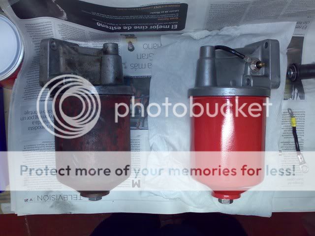

clean the support, when i come to engine parts like this, with internal holes and complex shapes i avoid sand blasting, debris will easily go inside
i used masking tape to close the delicate internal areas, and used steel wool and autosol ( a similar polishing paste will do)
oil spill, even by removing The thing from the support there is an oil spill, but i minimize it by using a plastic bag, once the bolts had been a little bit loosed i put the plastic bag around the canister and up to the support
i recall it is hell rot from bmw motorrads, primer, plus two layers, all in spray cans, PU paint bi component with catalizer included in the spray can, it is harder and lasts longer than conventional sprays, it is expensive though
