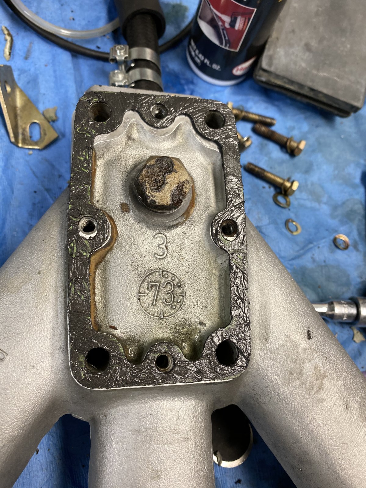

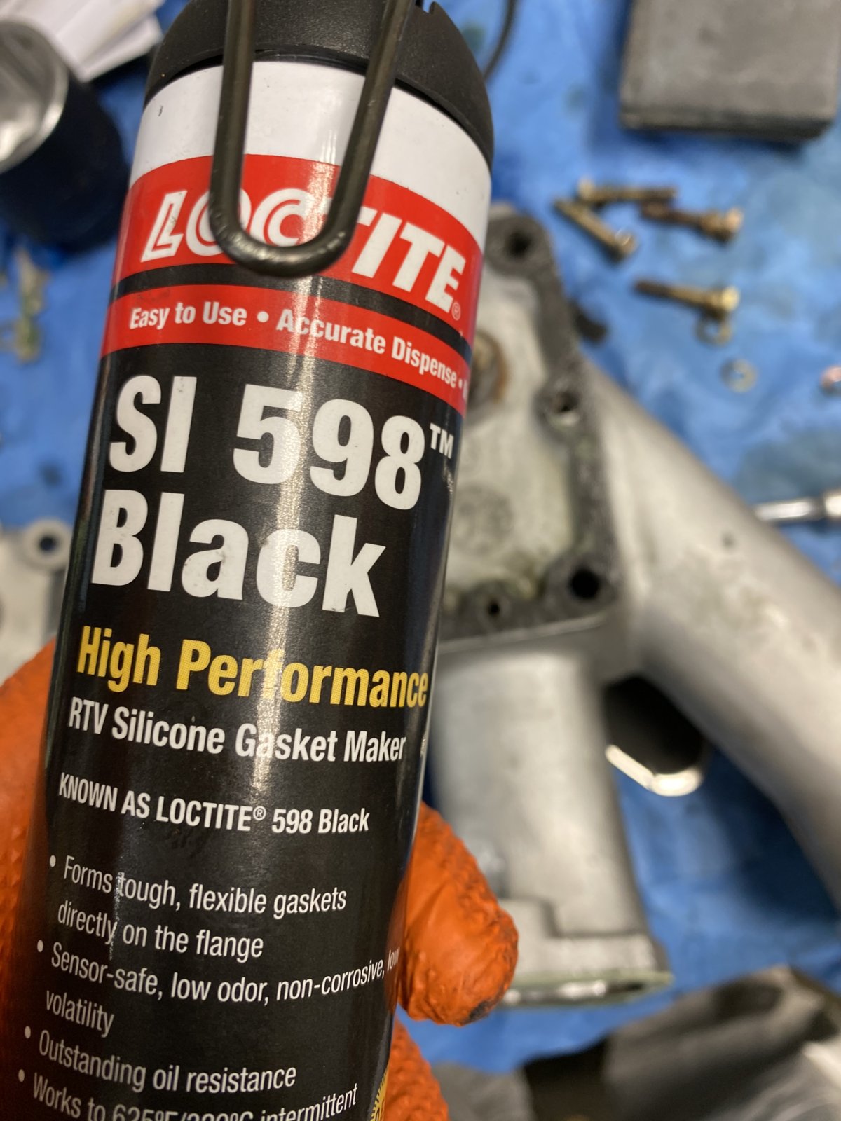

After trying many sealants over the years, I have settled on Loctite 598 for gasketed joints. What I like: To date, 100% effective against leaks, pressurized can makes dispensing easy and accurate, not an acetic acid cure (hate that smell). I've used it on cam cover joints that sit below the level of resting oil --always submerged. No leaks.
I apply it on the gasket and smear it down to a light coating, tighten fasteners hand tight and finally after a few hours (partial cure) fully torque down. Here it is being used on the intake manifold coolant chamber:

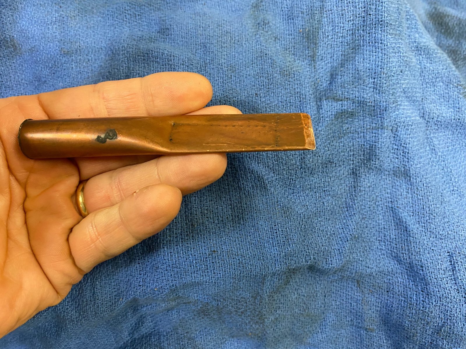

Before you say: "... but the RTV/gasket is a bit** to get off without scratching my beautiful aluminum head/cover/flange..." consider making a copper scraper as below. Softer than aluminum but with a sharp edge; it will change your RTV scraping life forever. I bet Steve could even do it on the kitchen table with one hand tied to his cabernet goblet.

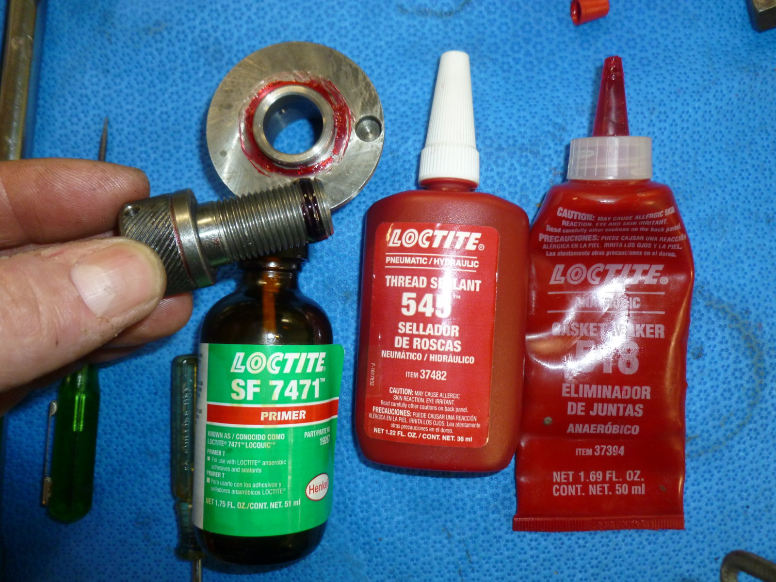

For ungasketed, well-fitting flanges I use Loctite 518. It will fill a gap up to .25mm. And for pneumatic/fluid threads, Loctite 545. I feel it more reliably seals than PTFE tape. The shown primer is not required but can speed up or improve bonding depending on the substrate.
