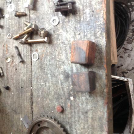

Lift engine and install wooden blocks above motor mounts
My set is about 1 1/2 inches high.

The blocks...
