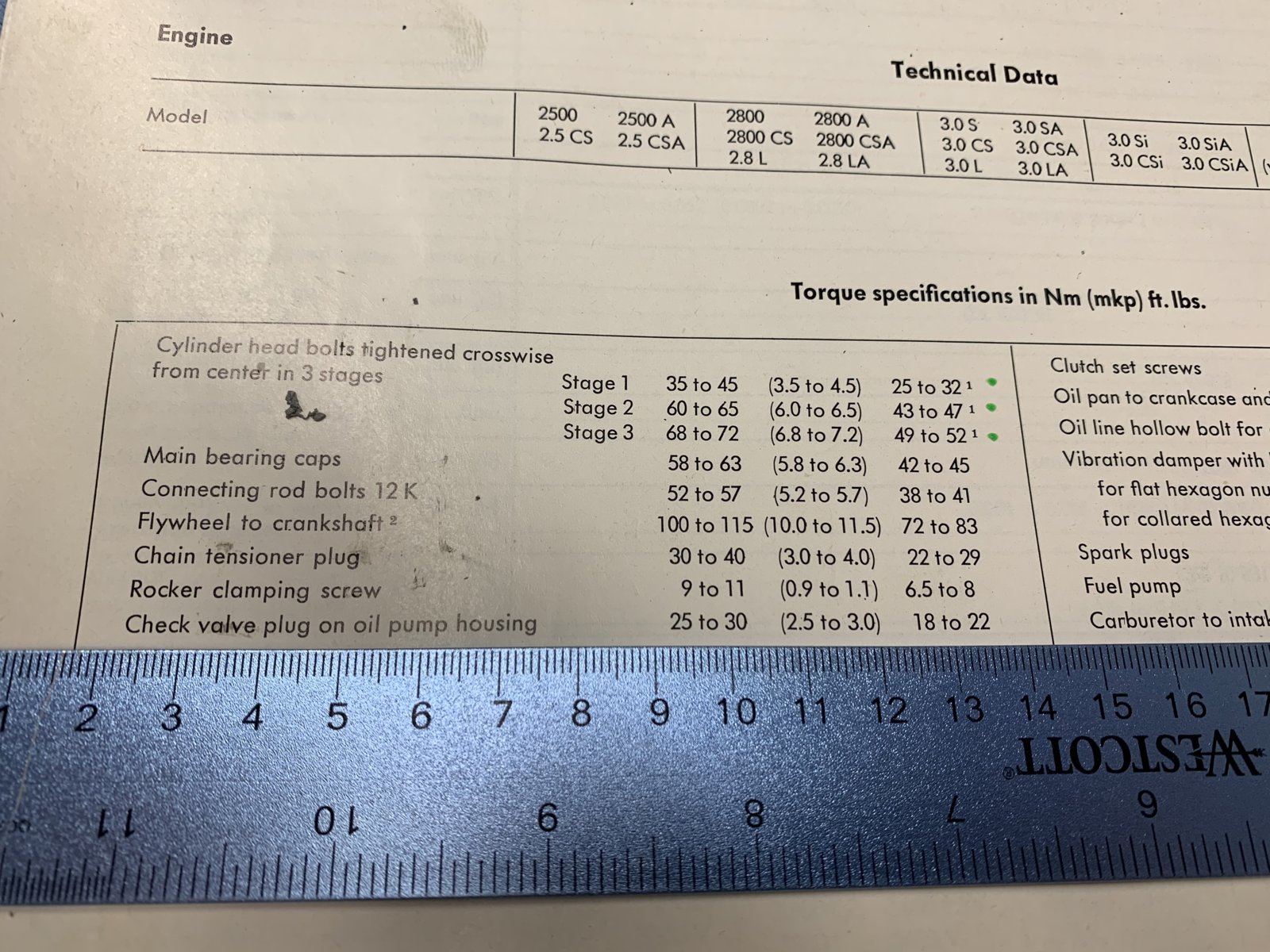

Hello! I’m in the midst of a rebuild of an M90. Due to various circumstances, we acquired another oil pump in excellent condition to replace the one that contributed to the failure of the previous rebuild. It is from an early M30 and has a threaded plug vs the circlip for securing the pressure relief components. I’d appreciate if anyone could share the correct spec for securing the plug.

In case anyone needs the info.
