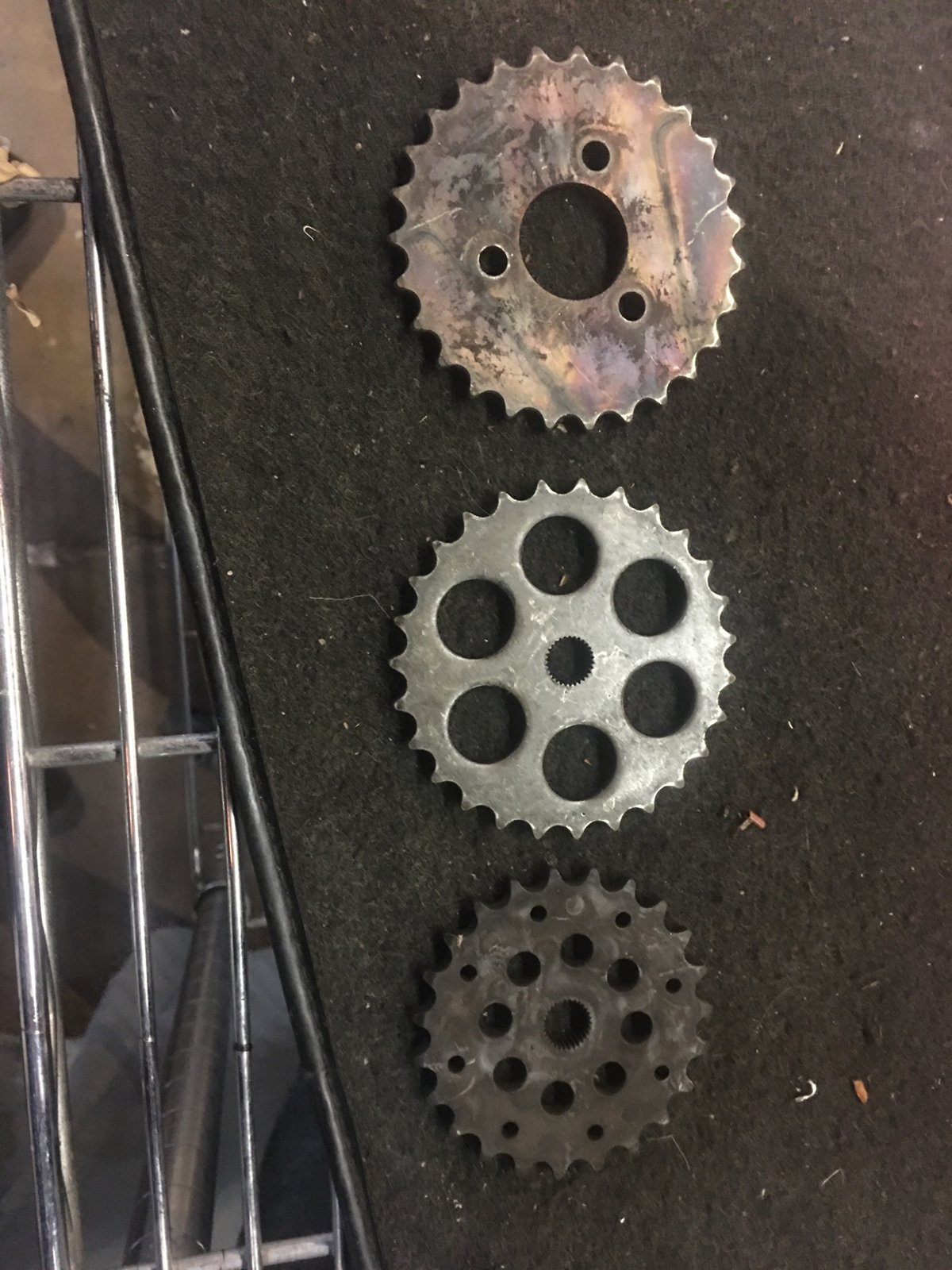

later pumps have splined shafts so plan on a new gear.

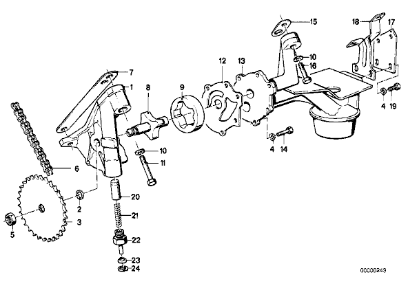

I wasn't happy with my oil pump pressure. Pumps at time NLA
I did some research and did some measuring with machine shop.
Decided to replace this $4.00 part.
#12
INTERMEDIATE PLATE11411714755
Made a huge difference.
Gary
#12
Gary

Yes it did and was too thin. This allowed for less pressure as this plate sits right next to pump impeller. Maybe oil was going past the side?
My built M30 runs 30-60 psi.
