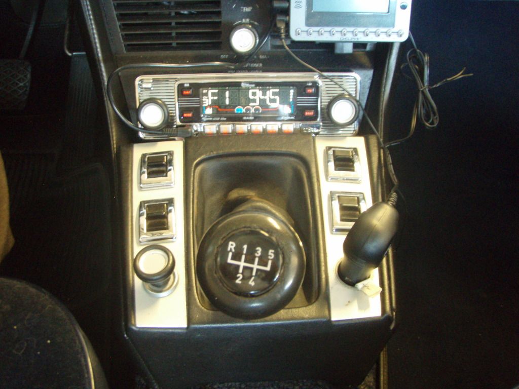

But relavent just the same. Here's some shots of my setup. The radio is brand new technology with XM port, MP3 port, and several AM/FM bands
Radio from Becker autosound U.S.A. I think it's like a two man band, it turned out I ordered my radio from the owner.
http://www.beckerautosound.com/
http://www.beckerautosound.com/Classic/retro%20replacement.html
Check out the knobs! Can you tell the difference?

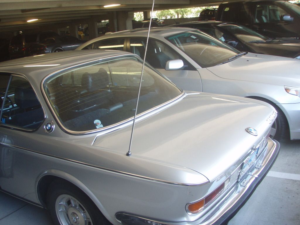

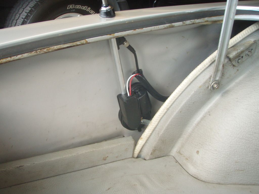

The electric radio antenna is Hirschmann OEM also. I think this was one of the original mounting positions?

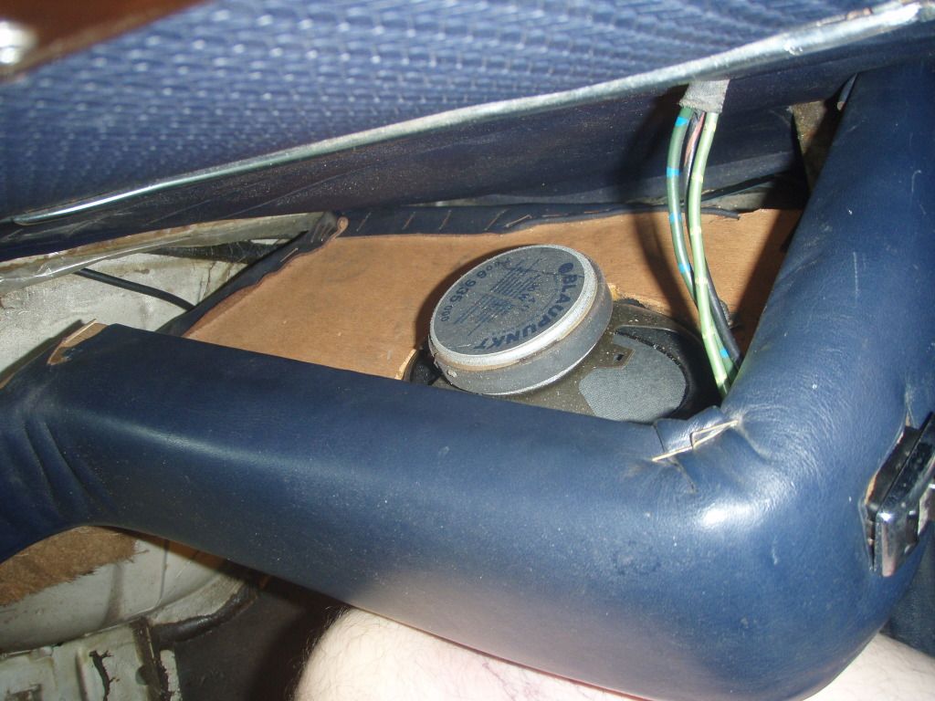

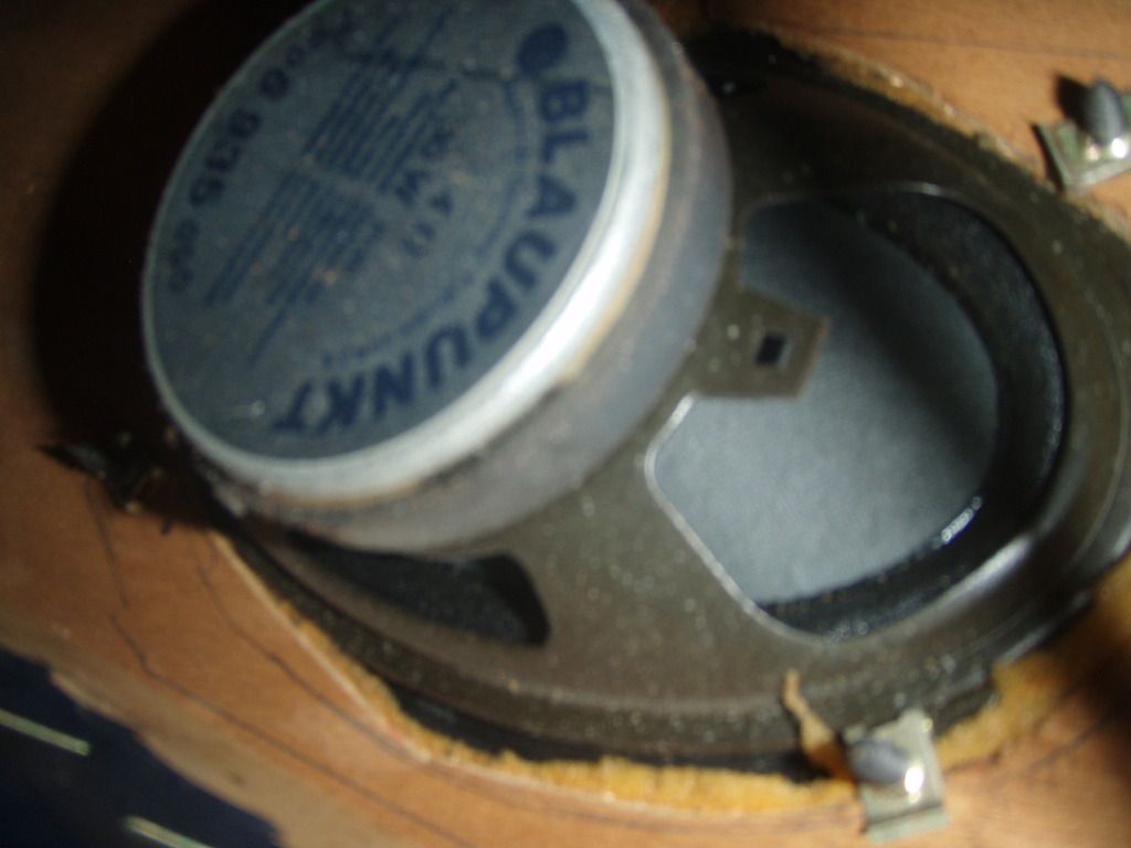

Next stop is the speakers. Figure out why the ones in the rear arm rests aren't hooked up. (looks like I could clean up my trunk a little too :oops: )

These are in the arm rests in the back. No holes in the fabric. Not hooked up for some reason, will investigate today
