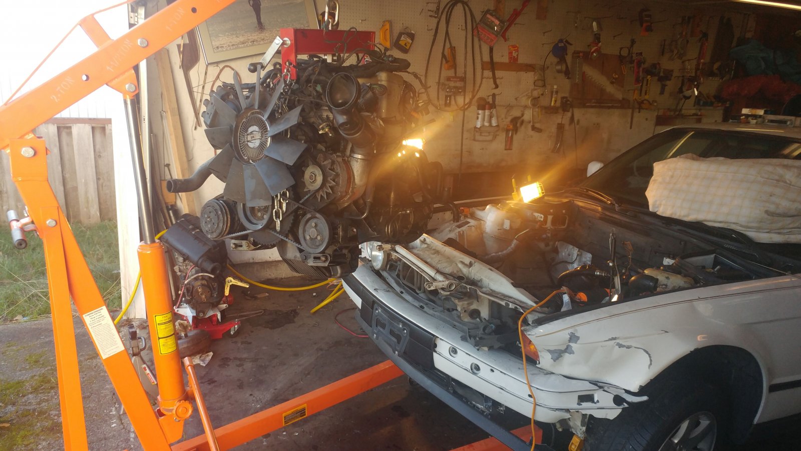

I got lucky and found a running/driving E34 535I w/90k miles for $500USD.
