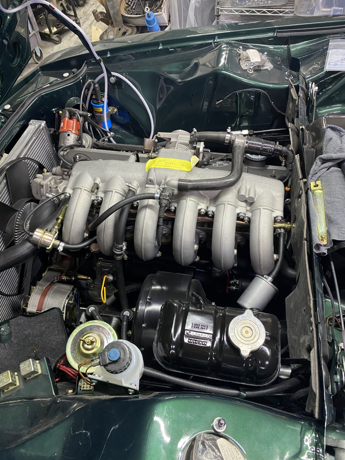

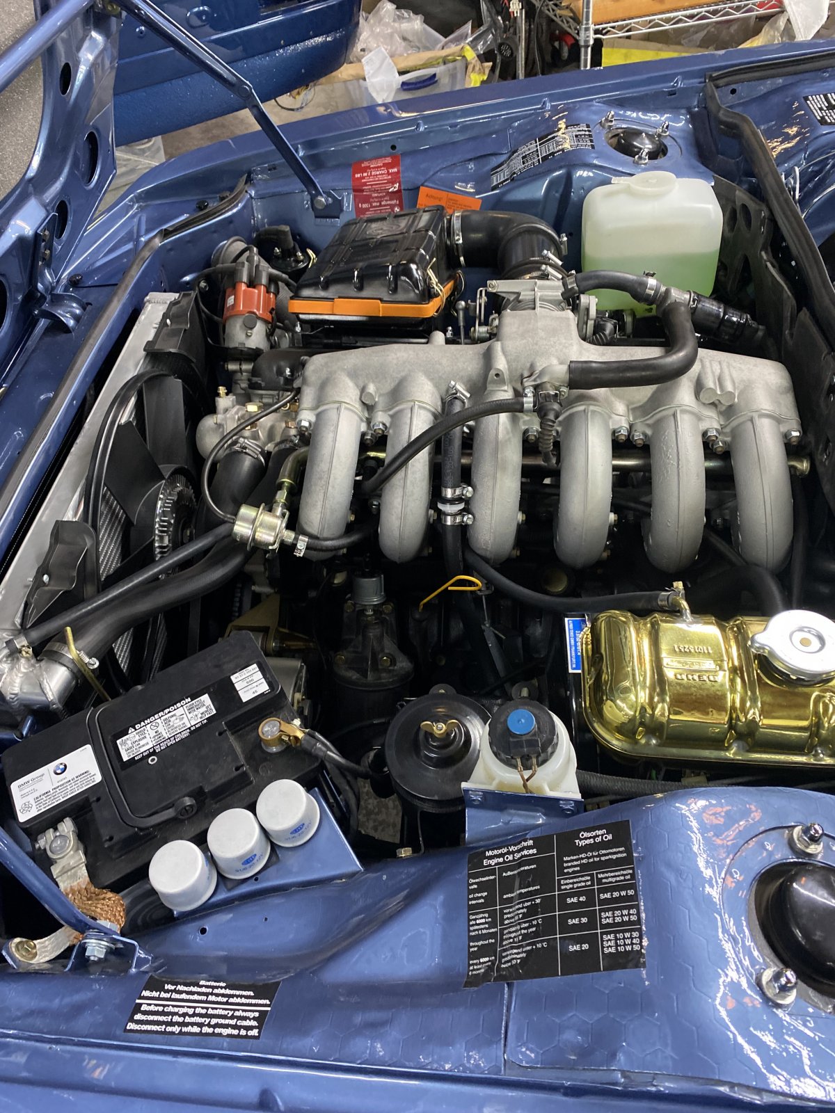

I had wanted a CSi -but was not liking how the early Bosch EFI systems were getting harder to work on (both in terms of parts availability and finding the people who know about them). That is when I settled on going Megasquirt for my new motor. If you look at my set up - it appears to be a stock CSi. But, under the skin - is a new Megasquirt brain controlling everything. FYI - The last pic above is of my car in Don's shop (after the M90 install - with the CSi look).
SFdon did everything - but there are other folks that also have done them. Sven (up here in Seattle) also has one on his car that he did on his own. There are also other EFI systems that are out there I think that are similar - but I went with what SFDon uses - just because....
