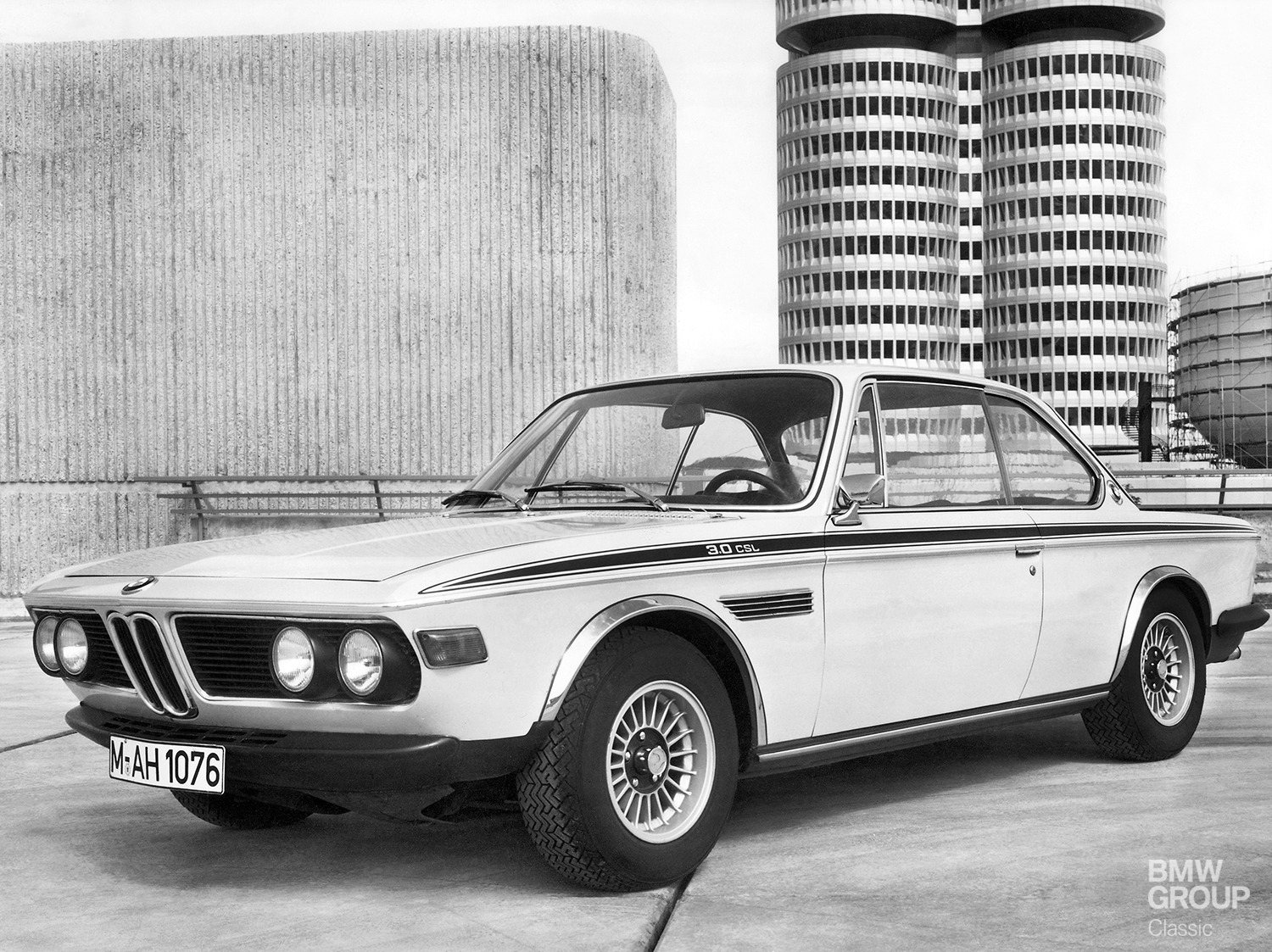

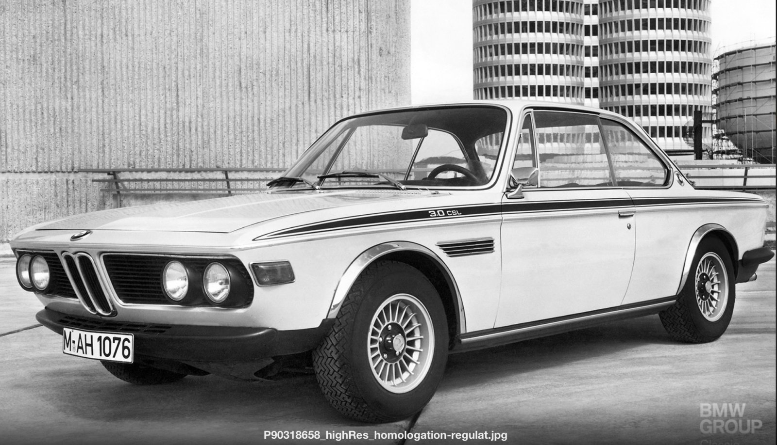

Hello Dougal and Keshav,
here is a paicture of an early CSL, probably a carburettor car and Jochen Neerpasch's company car. The picture is from BMW. The car is parked, where today the BMW World buildding is. It is on Pirelli CN 36. No phto shop. This picture biased me to have the Pirelli on my CSL too.
Michael

Oh that is double cool.
So do you think that was OE?
right so the first of the E9 fitted CN36 and then they changed onto XWX. dont suppose you know when that change took place?

The photo on your first "Betriebsanleitung" on the left is a copy from the photograph I posted above, and shows the Pirelli. M-AH 1076 was one of the first CSL, a pre-series company car. M-AH 1071 was even before that and had no stripe.

oh Michael, thank you very much
your photo is proof of what we have been saying during all these years,
meanwhile big mouth still repeats …xwx, xwx, xwx,…
will never shut up, maybe that can photoshop a parallel reality in which is right
