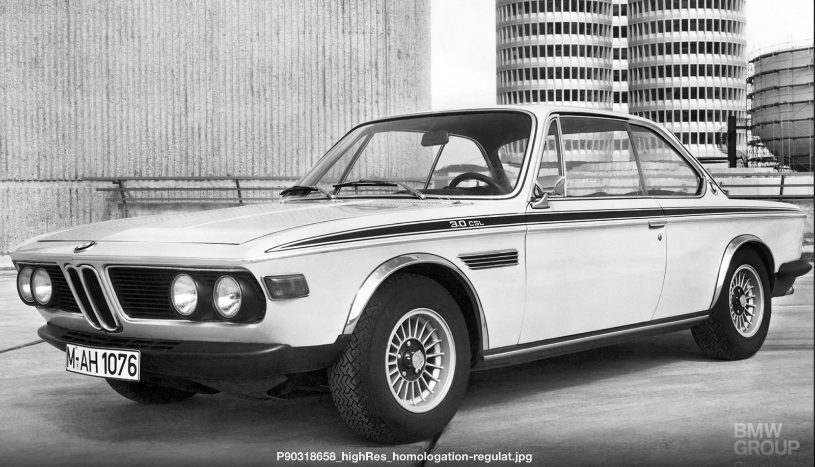

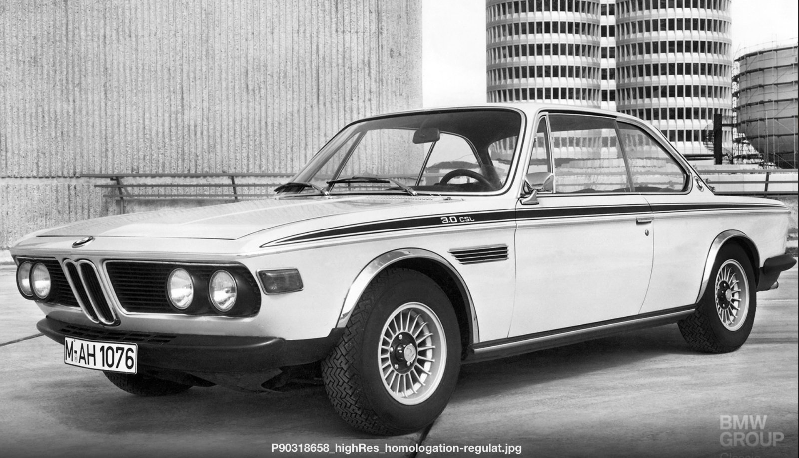

How cool is this, scaffolds yet in the welt building…
That must be late 1971 / early 72. The scaffolding is around the BMW museum, and it was gone during the 1972 Olympic games. The CSL is standing on the roof platform of a BMW-parkinglot, which was torn down many years ago and replaced by the BMW- World building in the same place. The CSL is interesting too. It has crome grills on the fender, and the aero cover underneath the front axle, which was believed to add two kph to the topspeed.
2 kph ! That is a serious difference
Maybe that is why that under engine cover is made from such a lousy material; it's pressed paper with a painted coating. Hardly durable, but enough to claim reaching 210 km/h?
In recent years a modern reproduction was available. I have it on my car, and it fits very well. Without it, it looks like something is missing, at least to me. And for those who want it original, as on the picture I posted, it is nice to have. I did not want to have the huge air dam. But everybody has a choice. And the entire car was not expected to last longer than 12 years ...

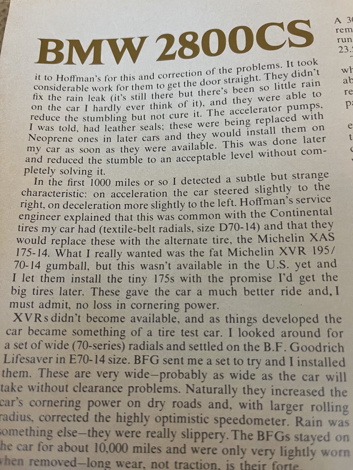

This is from Ron Wakefield review in road and track of his new 1971 2800cs. He states he hated the continental D70-14 that it came with it new and replaced them with Michelin XAS 175-14. This article outlines his entire tire drama.
