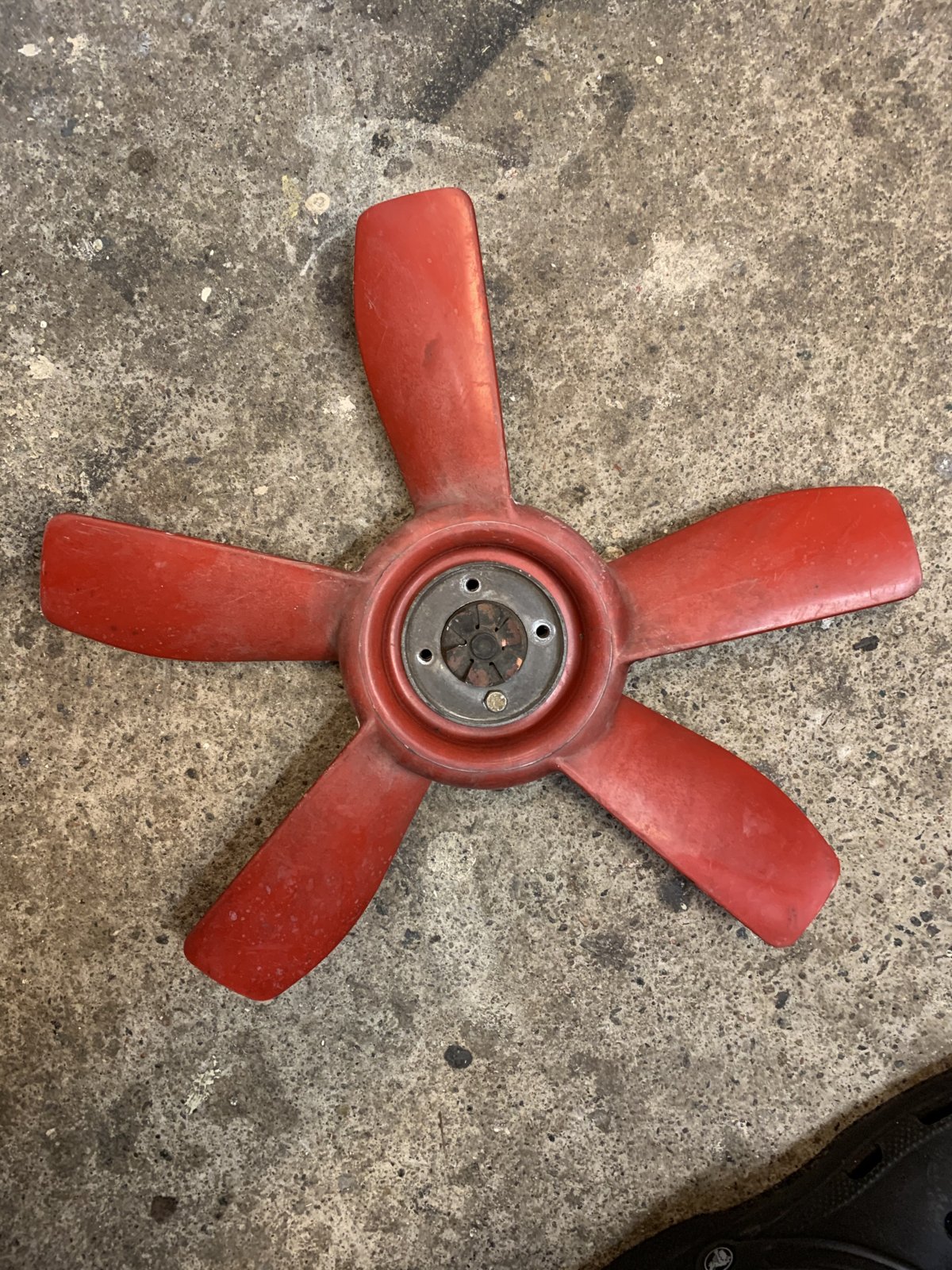

Where can I find a new fan-clutch suitable for this beautiful asymetric fan?
E9 1975 CS
Best Regards/ Coupe

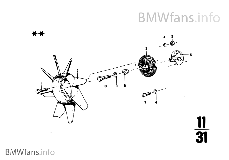

Fan clutch 11 52 1 251 821 is discontinued and no way for a second hand --too risky.
You should change for symetric fan and visco coupler commonly used as option
Marc
With the newer viscous clutch you need the mount with four bolts and one center bolt and a new fan that fits that water pump with the square/symmetrical mounting holes on the impeller. The newest water pump is different and that clutch uses the impeller and fan pulley with rectangular arrangement, not square, and has one large 32mm mounting nut, they are not interchangeable.

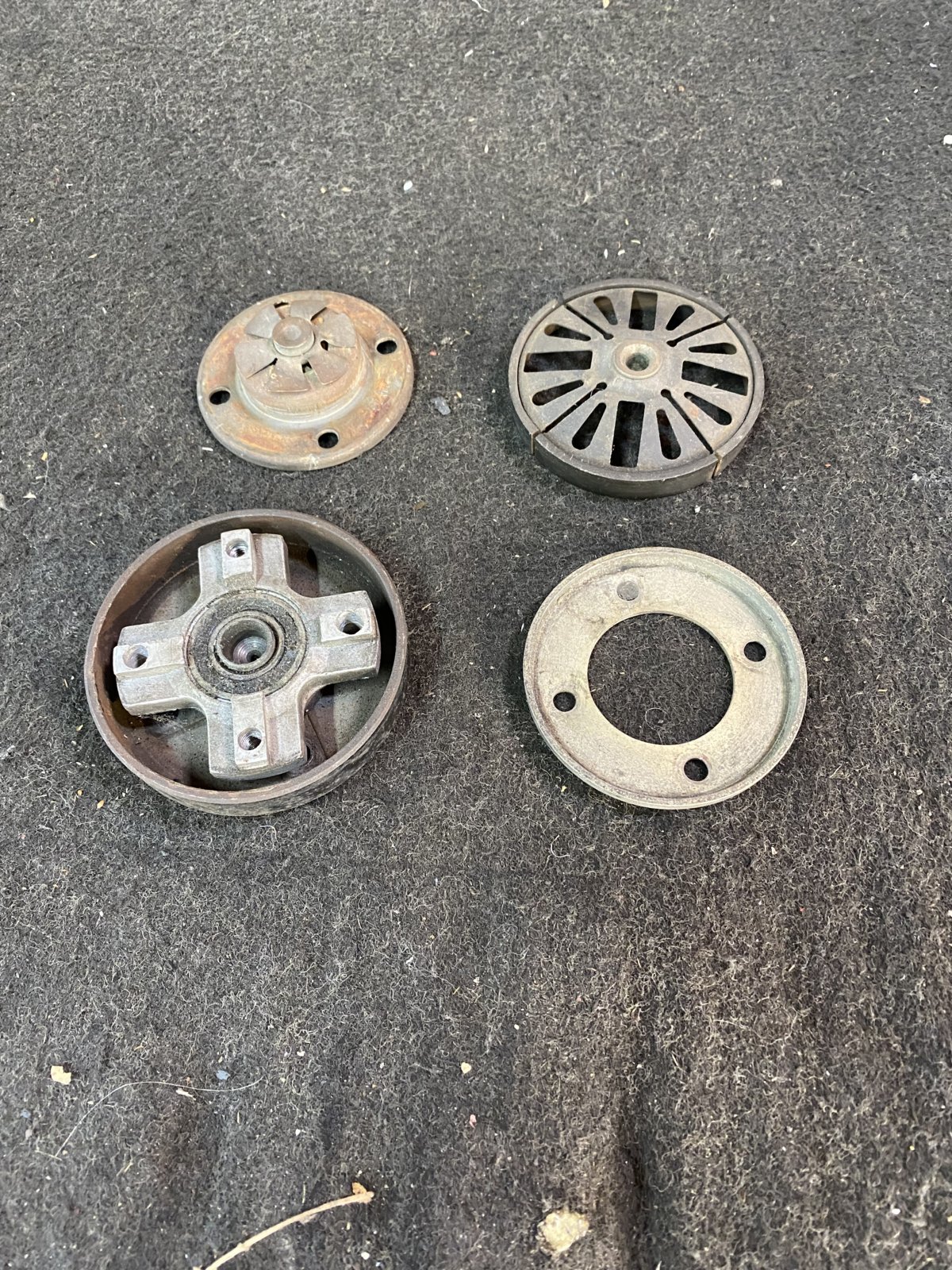

You know how to shim one?
How to shim it:
Better off with 2nd Generation

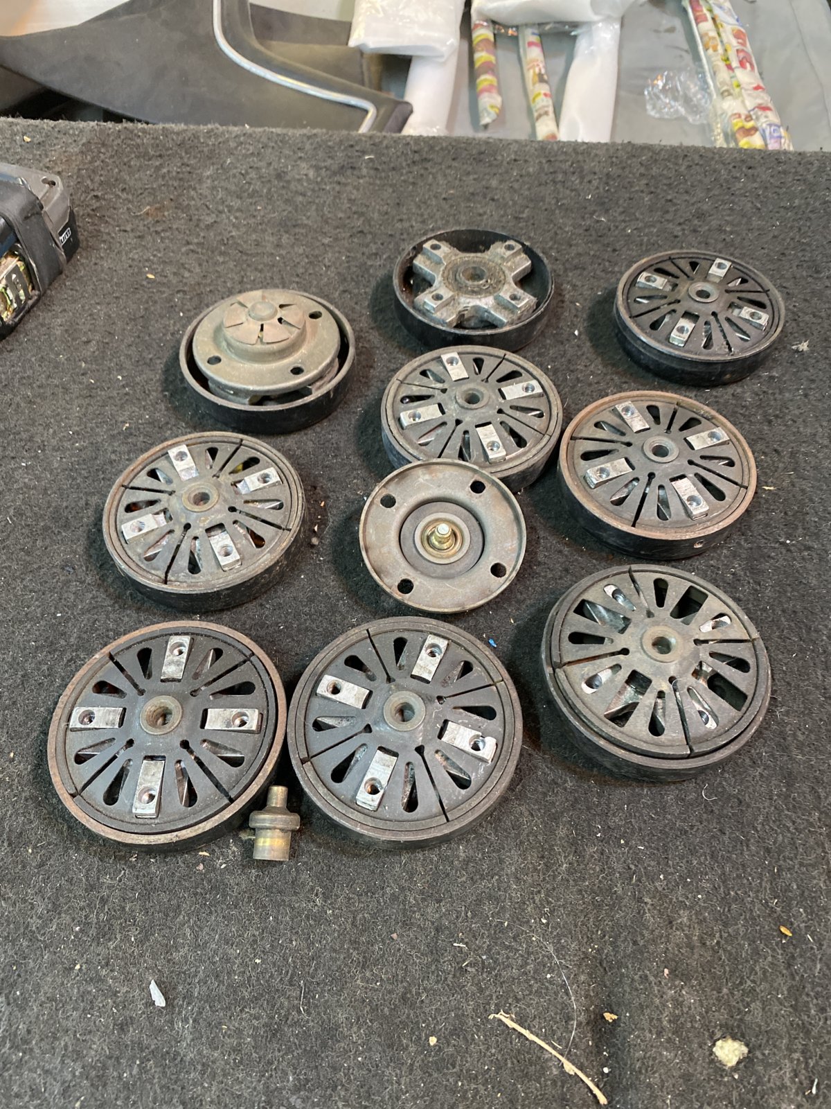

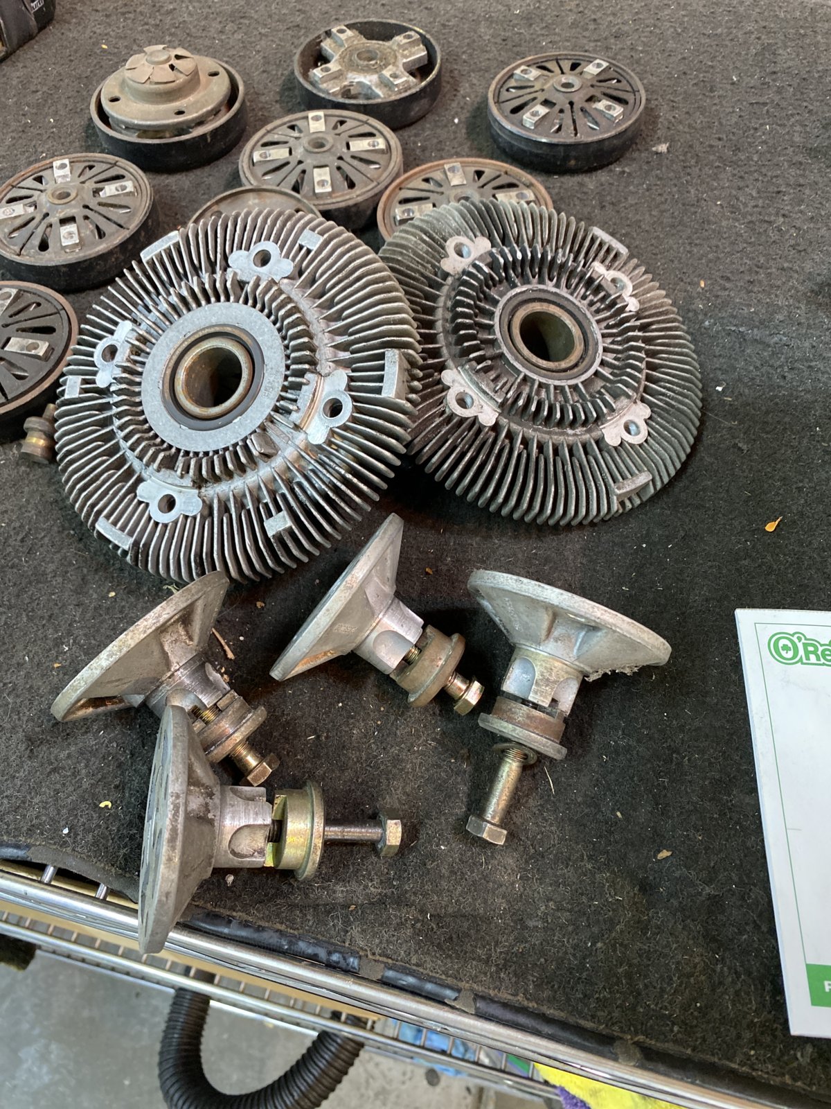

That’s not all the parts….
You need all 4 parts.
If you want the set- 100.00

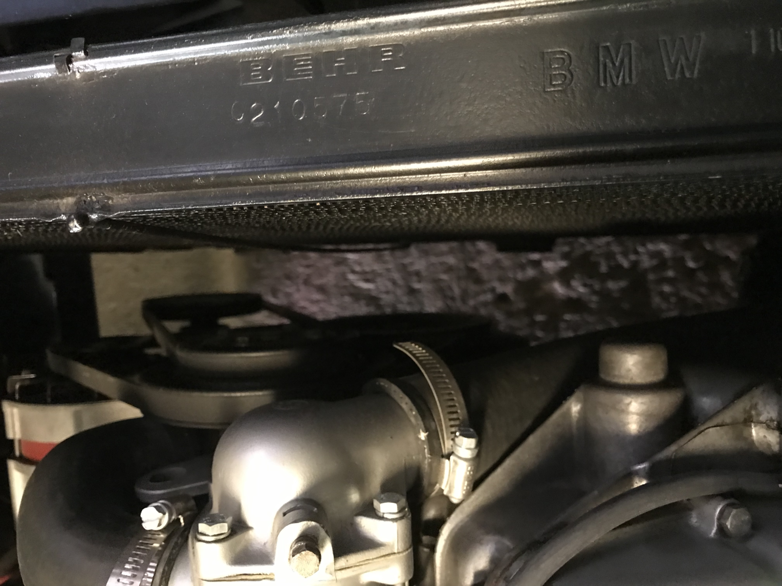

I have been running without a clutch/fan for 35 years. Never a problem. Just use an aux fan from an a/c car, comes on in traffic when temp gets too high, cools everything down, shuts off. Did replace its bearing a few years ago, so it is quieter now. And the radiator is now a triple core unit for that extra capacity. Where I live, temps are not like Florida, of course, but we have been getting much hotter the past couple years.
