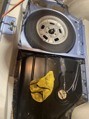

Found another picture from my initial detail/documentation showing the original foam under the jack if anyone wants to go haywire with recreating minute factory details:

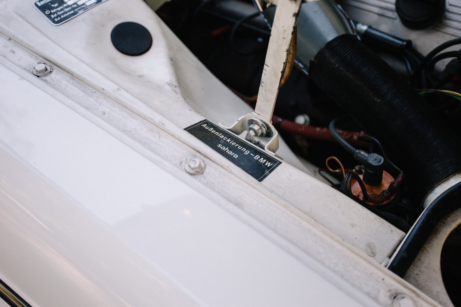

I'm all for originality, but as a mechnical engineer, I do find it a bit strange to paint fastners.
I guess the real question is: Why did BMW use fender bolts? Why is a fender bolt dished? I don’t know the answer.
I do know that with the exception of a few cars, fenders almost always use these bolts, so much that they are called “fender bolts/screws”. There are plenty of exceptions, but most cars have painted fender bolts/screws. I don’t know if they are designed this way in purpose, but a fender bolt retains paint much better than a standard hex head bolt. :) It sure seems like when you find a bolt on the body with a dished head securing a painted part, the bolt was likely painted also.
Does anyone know why fender bolts have a raised lip?
With all that said, I think the e3 didn’t use fender bolts:

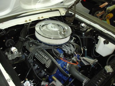

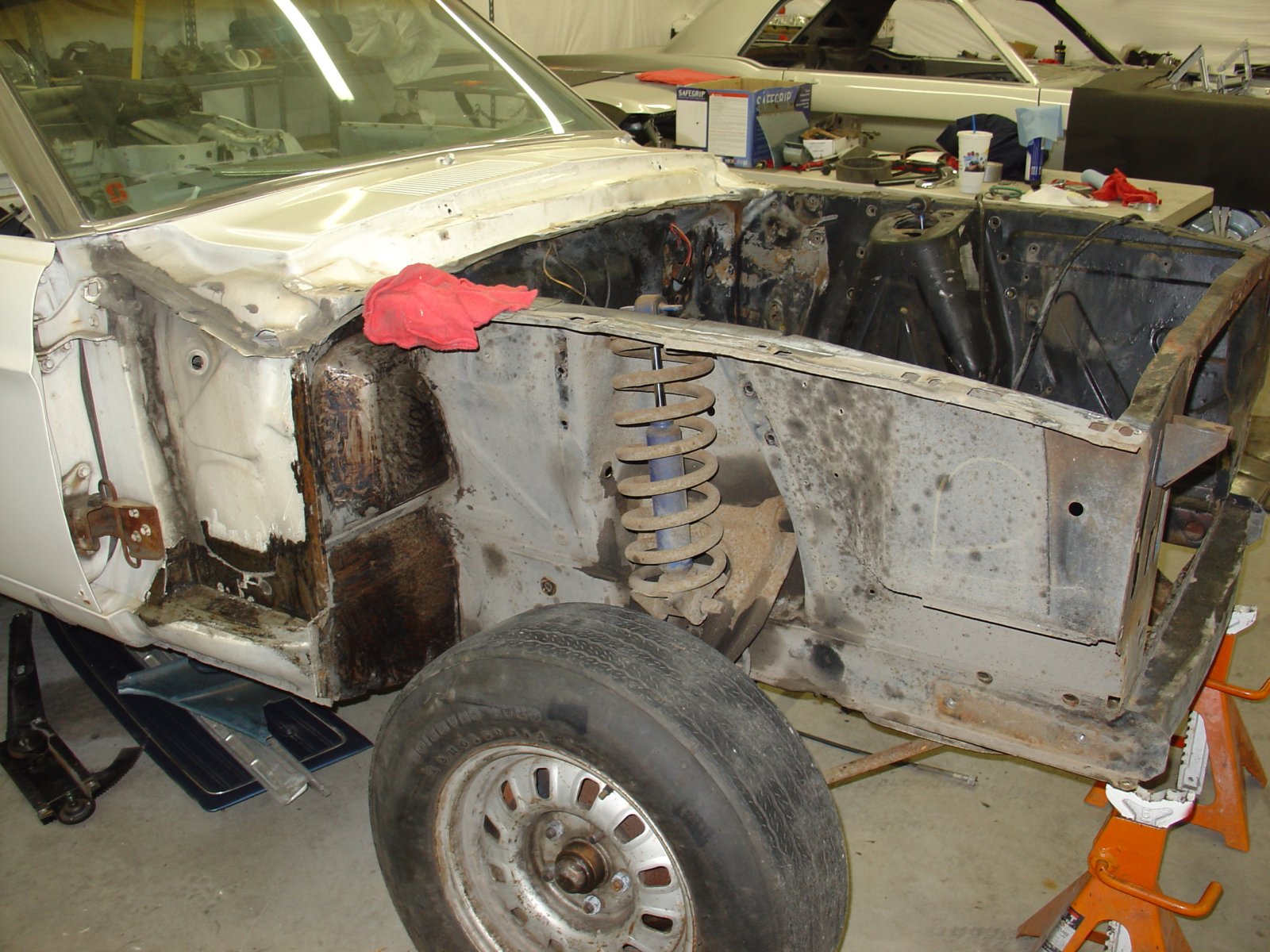

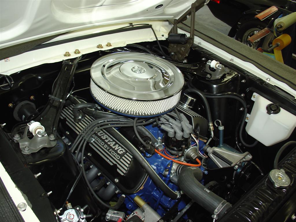

On a side note - the front fenders on my 1968 Mustang have unpainted attach hardware (bolts). See pic below.
I had the car restored in 2005/2006.
Before I had my car restored, I was at the 'Mustang Round-Up' in Bellevue, WA to do some homework on who could do the work - and just have fun.
I was talking to one fella who had his 1967 Coupe on display. He and I were talking right when the judges came through to judge his car.
I stepped back and watched the spectacle. The 4 or 5 judges spent 20 minutes discussing what the correct color anodize was for these very bolts and the implications of such highly important features. They got to the point of not only discussing what the color was/should be but also - was it supposed to be flat? Satin? Shiny? Jeezzeee....
The rest of their judging time was equally obtuse... Blew my head right open - and I left the area wondering what I was getting into....
Witnessing that - I made a personal vow to never show my Mustang in any MCA judged show. The shop that did the restoration on my car was disappointed at that (for they would have appreciated the exposure showing my car would give them) - but - they did understand why I would not want to go through that BS.
For my car - I am on the fence with how I will 'show' my car that is coming up on delivery from SFDon... I really don't care about originality (in this trivial way) - but I do want to have fun with the car. Will see how my time with the E9 goes moving forward....

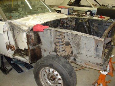

Below - For the Mustang, you can see the before (with fender removed) and after (with the silver anodized bolts shown).
The reason the Mustang has unpainted fasteners is that the hood, fenders and some other smaller body items are painted off the car and then installed. So, makes sense to not have fasteners painted.

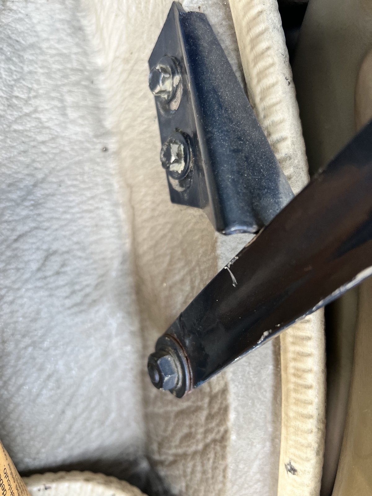

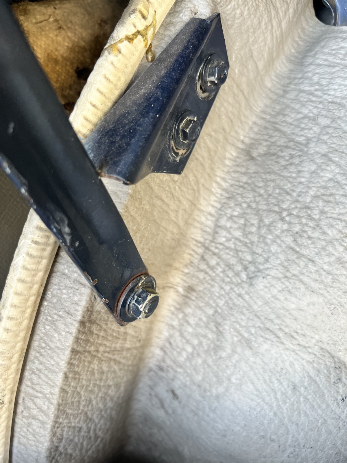

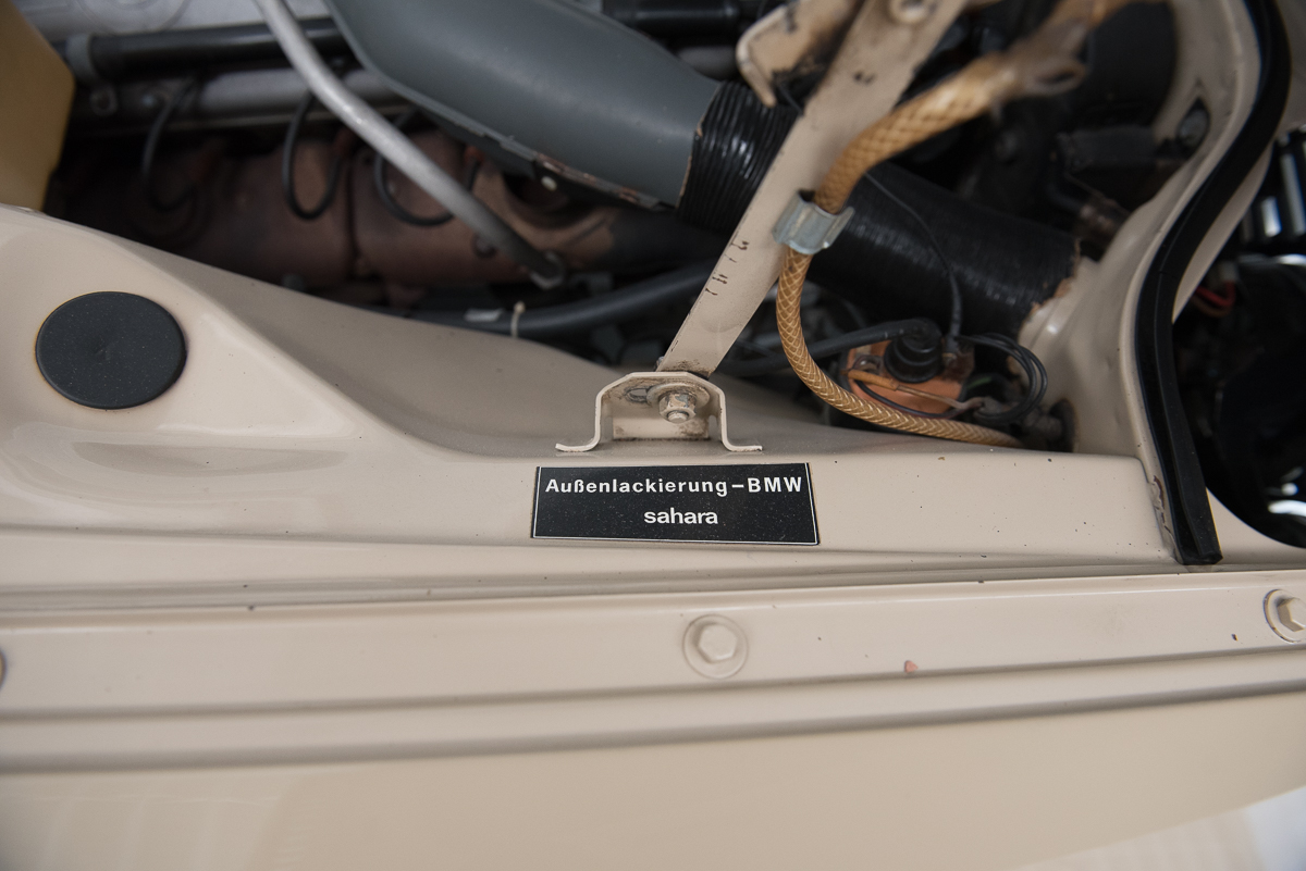

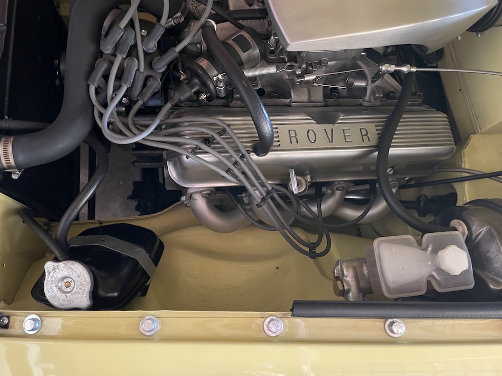

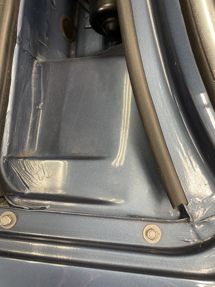

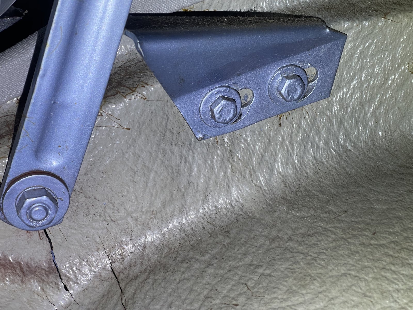

painted by hand after installation is my vote

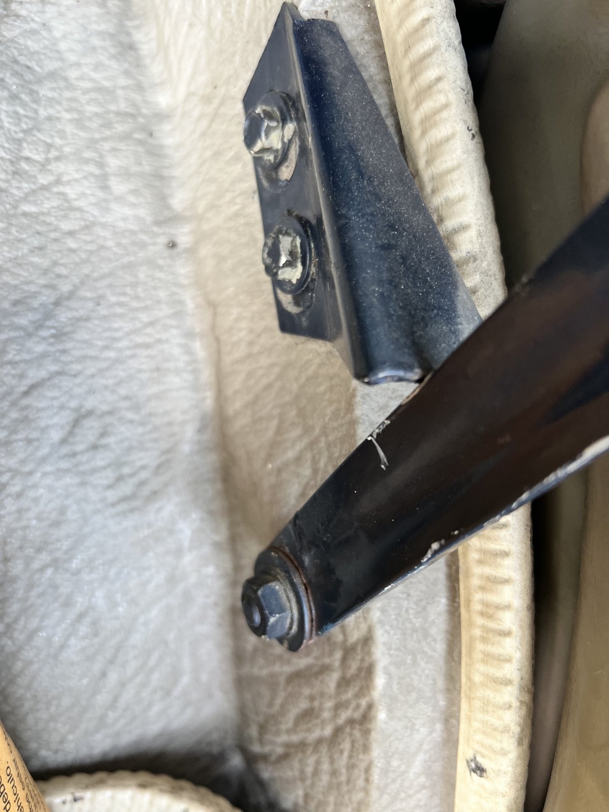

It looks like they painted them installed, did the final installation then took a comedy paint brush and slathered paint over them after they were done.
Note the slop on the wheel well cover and the less than careful brushstrokes above the bolt heads and washers as also seen on other examples above.
On seeing other examples almost identical to mine, I have to agree with Erik and Christopher on this.
This is how it was done at Karmann.

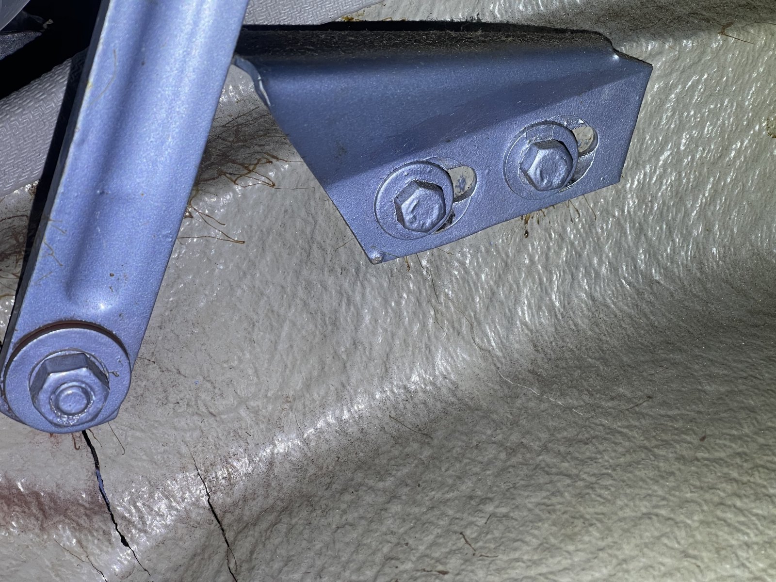

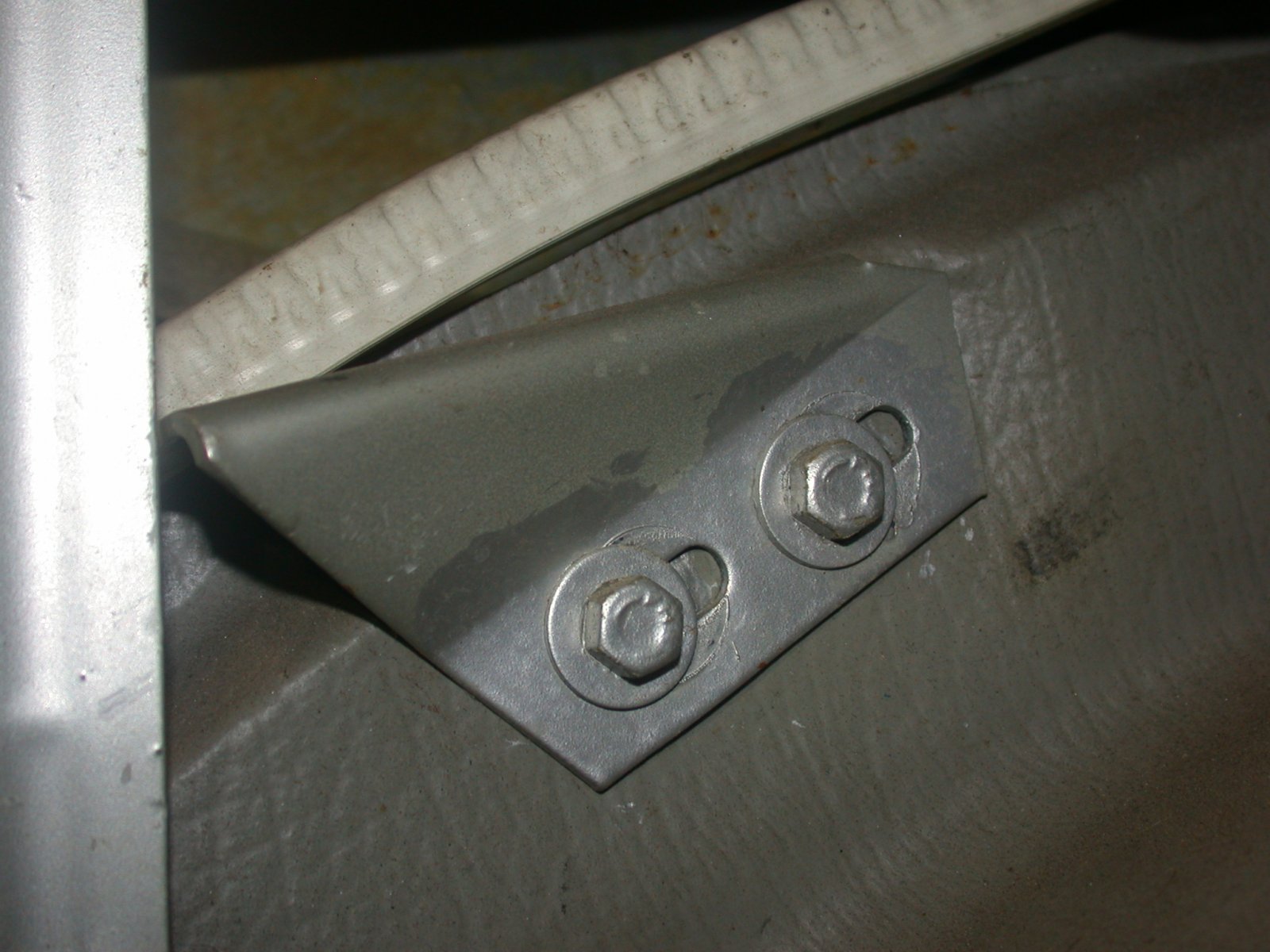

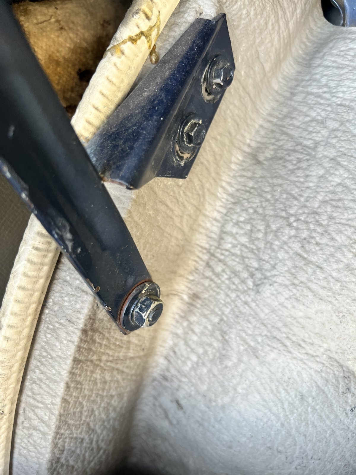

Here's a close-up of mine. The hardware matches Erik's and others, so not all were fender-type screws.
The stop brackets were pushed forward from their former painted positions, but there's no former impression or shadow on the plastic liner...
Plot thickens. I didn’t actually check that they were all fender bolts. They aren’t standard bolts though, and have a clear cavity on the head.

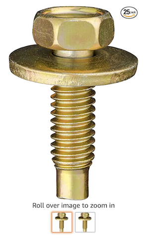

I don't think a raised lip is necessarily a characteristic of a fender bolt. I think fender bolts are characterized by having a captive washer...
...because they are used in applications where the bolt goes through an elongated hole that is required when fitting a part that needs adjustability (like a fender). I've seen various types of bolts, bolt heads, washers, and finishes.

The community has spoken, I will paint the bolts and washers. I did notice that some trunk support arms have split lock washers and some appear to have wave washers, the parts book lists a Spring Ring which I think is a wave washer but what is pictured in the diagram looks like a split lock.
The stop bracket appears to have no wave washer, I will follow this direction as well.
Fully in line with the consensus that seems to develop; painted body color over yellow CAD from factory.
My car has been fully restored in the 90's before I tore it down again. It still had the original bolts, though without paint. I start to think mine had their paint removed in the 90's.
