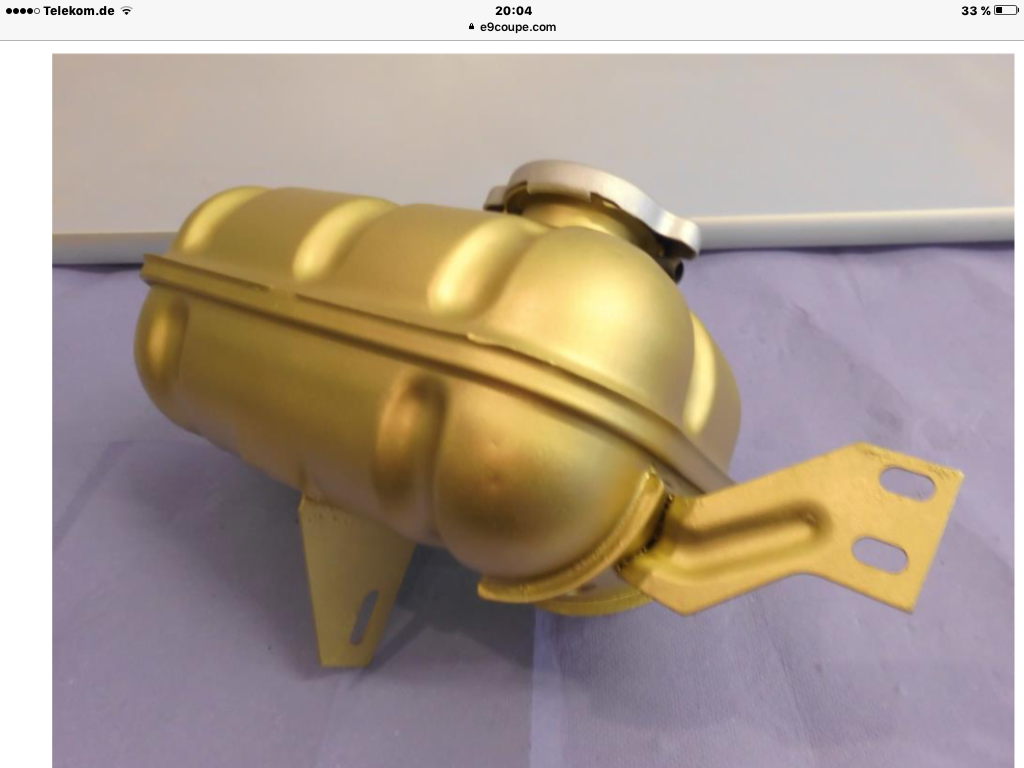

Overflow Tank Painted or Unpainted?

How about powder coating?
I was going to powder coat mine, but then came to the conclusion that the powder I use needs 400 f to set and the solder holding these tanks together can't take that much heat.

i think the color of the car makes a big difference as to which looks best. take for instance a black coupe ... i do NOT think the black tank looks good. i think either a polished brass or a new, white plastic tank with blue BMW coolant looks best.
on a polaris silver coupe, i like the polished brass.
on a ceylon gold coupe, i like the black

Oneils asked me to upload his picture. Looking good!
My mechanic felt bead blasting might dimple the brass. Used paint remover and love the results. A new virgin white brake fluid reservior and cap/sending unit on the way. Cost including shipping $37. Thank you Don.
