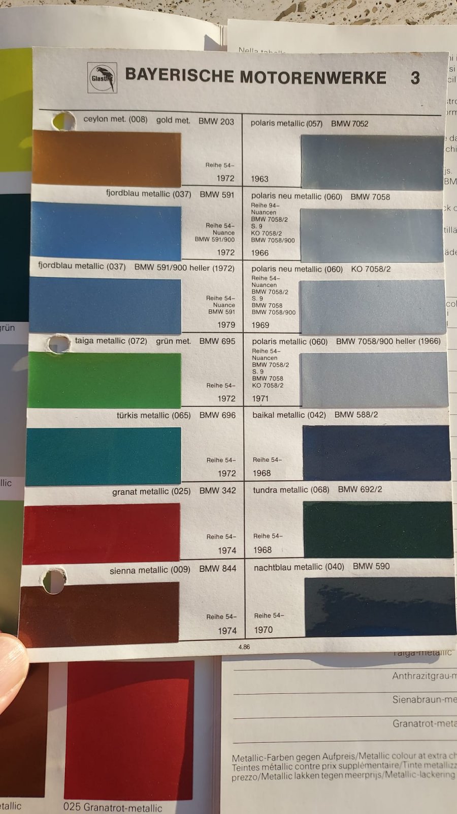

BMW calls Polaris 060. Any good paint shop or auto paint supply can look up BMW 060 and find a formula, whether it matches is another matter. That is why you do several ‘spray outs’ to compare.

to my surprise there are 4 Polaris in the GLASURIT sheet

Hello, I am using shop But I have to give him the color cod I can not trust the car paint to match the paint it is to old of the paint
Hello, I try that I have a 2002tii Malaga color and 3.0csi Malaga color I let the painter to order the paint and painted when he deliver the 2002 and I look at the E9 to me 2002 new paint is darker than 3.0 to me my E9 is like soft and lighter and very nice color but the 2002 it doesn't look like BMW Malaga now it is completed and I am stock with it that is why I want to buy the paint my self try small area then start the paint job but I tell you he dos amazing job he is very good at his job.
