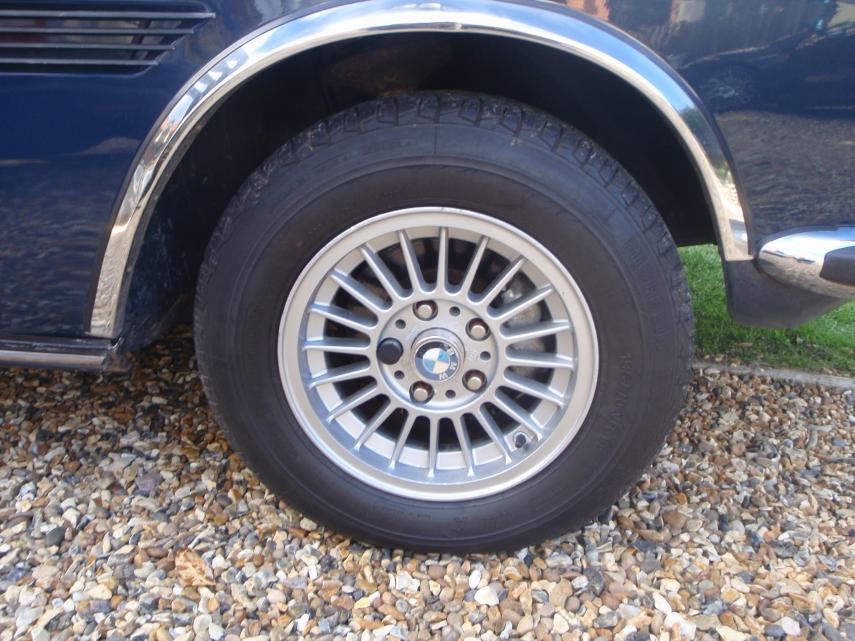

My wheela are already painted silver, but the centers are not black. Any suggestions on how to mask the silver and just leave the center circle to paint black?
