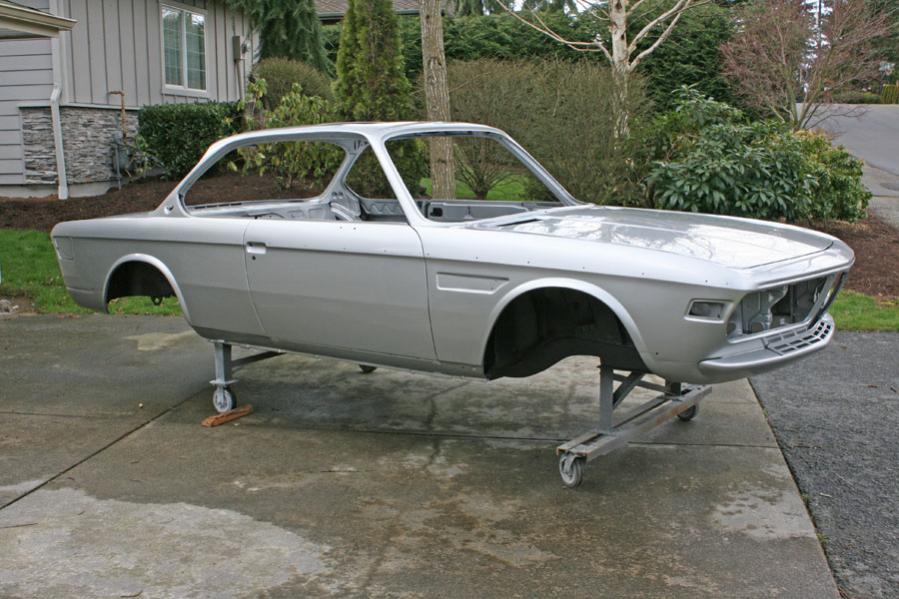

Milestone reached yesterday: I finally got the car body back from the body/paint shop. Here are some pics. I Installed the trunk and hood torsion bars last night - easier than I expected.

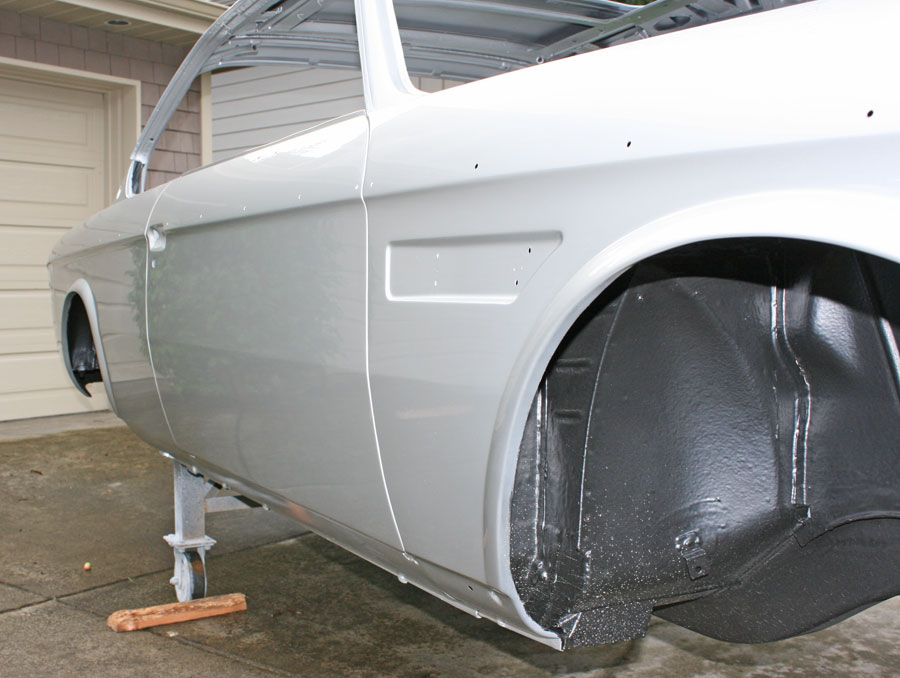

The angled tab is for attachment of the plastic volvo fender liner. There is also one mounted at the top of the arch (welded to the side of the vertical inner wheel well reinforcing fin) to hold the liner against the top of the fender. Previously I had them screwed into the base of the 'A' post, but wanted to eliminate that hole and allow a small gap between the backside of the liner and the 'A' post.
The mid body horizontal highlight line looks crisp & straight with proper fad outs at the ends. The front of the hood is level in relation to the header panel. Someone obviously knows what their doing or you started with a near perfect body --- I am impressed. VERY NICE JOB. ~ John Buchtenkirch

Textured finish is the same all the way around the base of the car (front and rear, and both rocker covers). Here is a close up of the front corner. It seems a good match to the existing. We picked a horizontal line at the leading edge of the nose to make the transition from texture to smooth. At the front sides and rear valence there is a change in the sheet metal where this transition occurs.
They used the 3M Ultra Gard Coating No. 08964.
