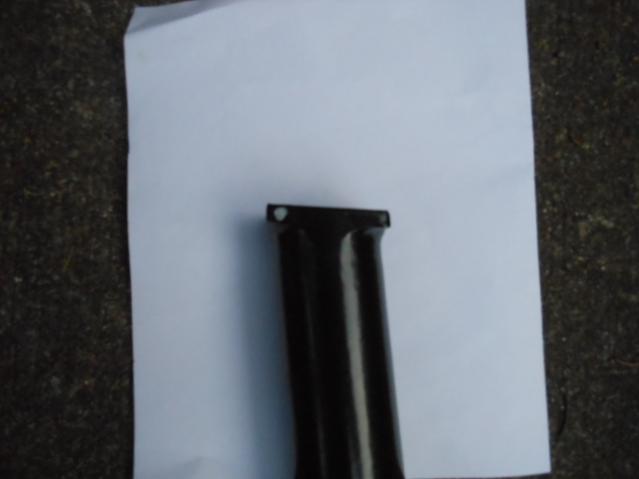

Thanks for the replies,I will be using the OE aluminum block.I am still confused about the proper orientation of the angled plate on the end of the shaft.Should the edge that angles outward(marked by dot in photo) be at top of bumper when assembled or on the bottom or ??? Thanks.

Looks like no one seems to know how to orient the dot, and Pamp is apparently on assignment somewhere where there is no internet access so he can't advise either.
Do a trial fitting of the tubes with the bumper so figure out which way the dots go. My sense is that it won't make much difference.
