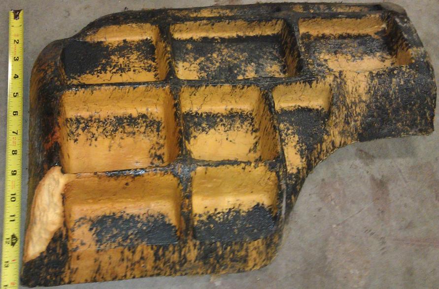

Chris,
I measured ~57 cm along the floor from the center of the seat base. This is an approximate number since I measured with carpet and sound deadening material in place. The angle is about 50° from horizontal. Note the piece actually has a slight curve to it which you can see in the photo. In the photo of the footwell you can see the imprint left in the 1/8" foam padding from the grid at the back of the rigid foam moulding piece. Of course you set up with be a mirror image - assuming your passenger side is on the left.
Another option for fabricating a piece similar to aalto suggestion is to cut out an 1/8" piece of plywood (which usually will have a slight bend to it). Trim it to fit. Apply plastic wrap (clingwrap) to the metal surface of the footwell (or some other material that keeps the expanding foam from sticking to the metal surface of the car floor). Spray in a bunch of this foam, allow it to expand a bit and then press the wood into place, essentially squeezing the foam to mould to the car's shape. Let cure and then trim off excess and pull the whole thing out. You may need to add some foam to the back side if there are any larger holes or gaps. Remove the plastic wrap from the car floor and you are set. You will want to make sure everything around is well taped off, since this stuff is quite messy and will stick to just about anything.

Here are some pics for reference that have been posted on previous posts.
I bought a replacement drivers side foam from cs-werk.
