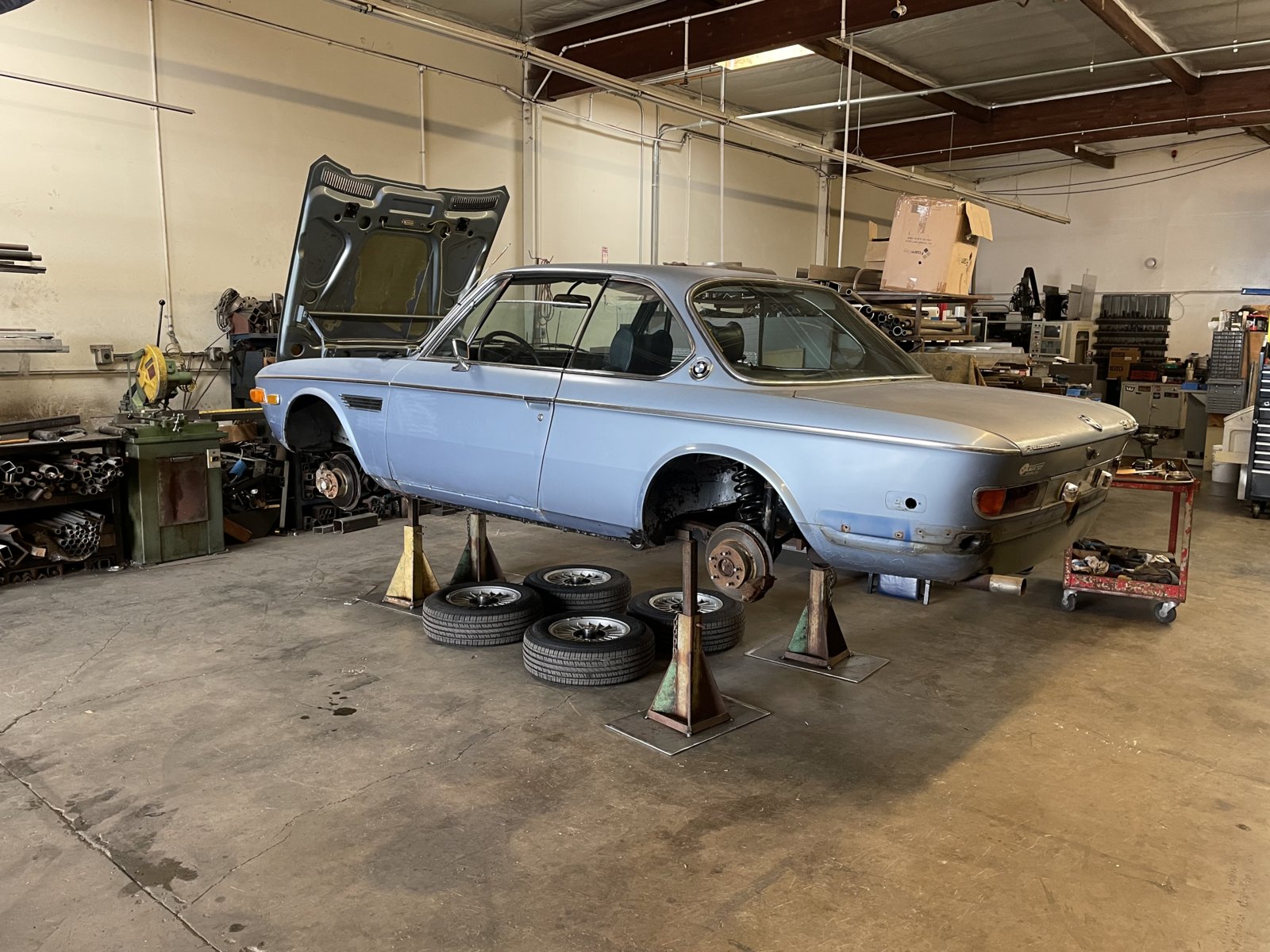

As much as I'd like to keep it completely original. The goal is to keep it stock, but more Euro stock, by removing the federalized bumpers, reflectors and U.S. emissions equipment. The more I inspect this car the more stunned I am at the lack of wear and abuse. It's so original the ignition buzzer is still connected and working. So irritating. So original.
The plans are to remove the Federalized bumpers (sold to Russ thank you) and replace with 1972 Euro chrome bumpers (thank you Mike Pelly). Replace the entire 3 spd automatic with a Getrag 265 5 speed. And then repaint the exterior of the car in the correct shade of 037 Fjord blue. The motor runs exceptionally well short of a massive lean surge with the Zenith carburetors worn accelerator pumps. Rebuilding the Zeniths is job no. 2. (removing the federalized bumpers was job no. 1).

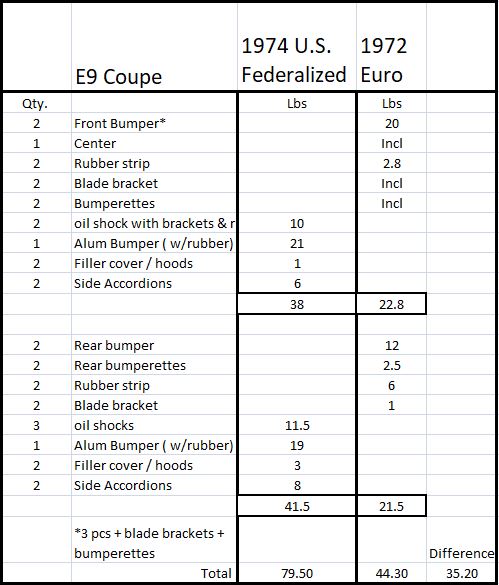

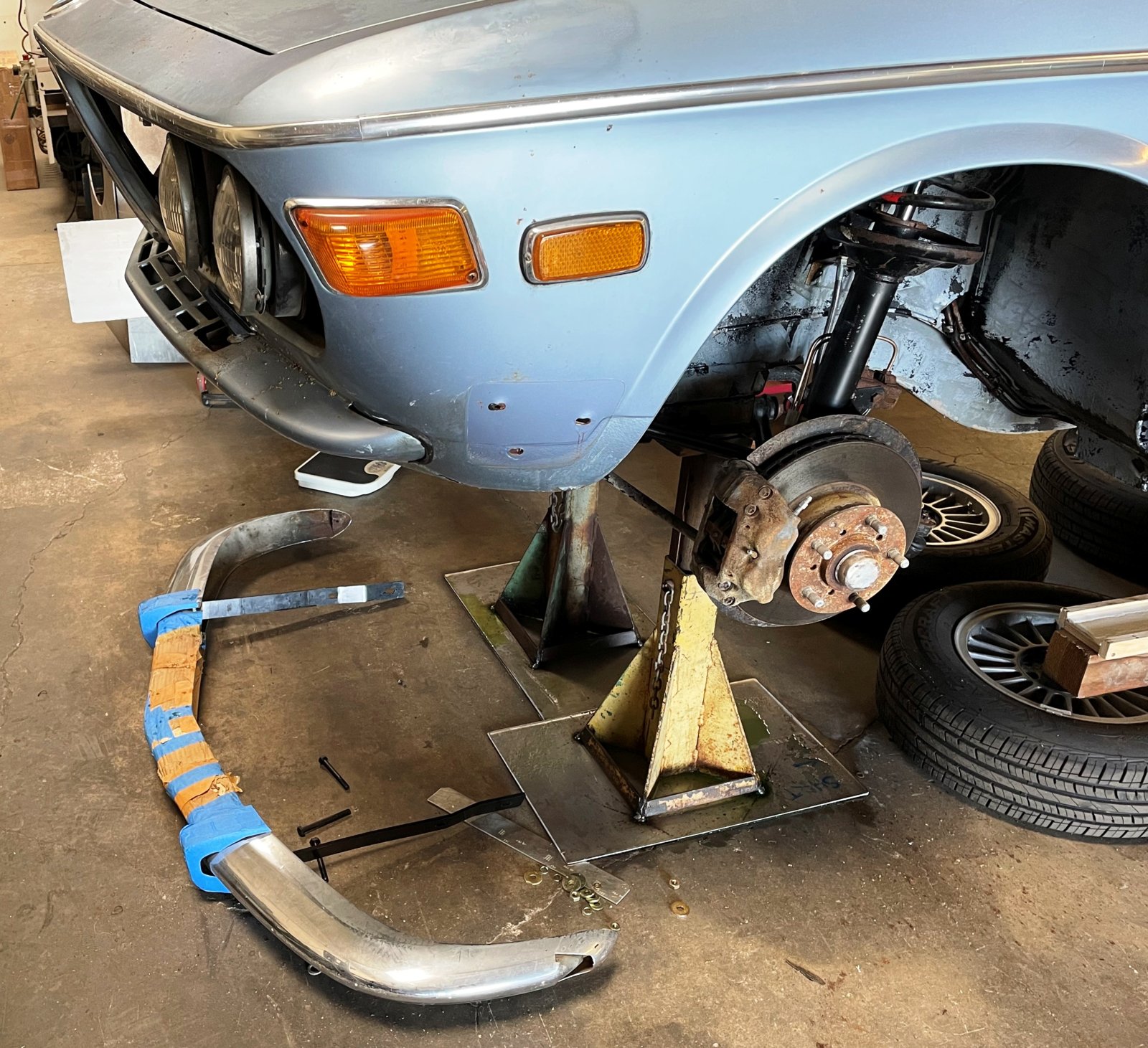

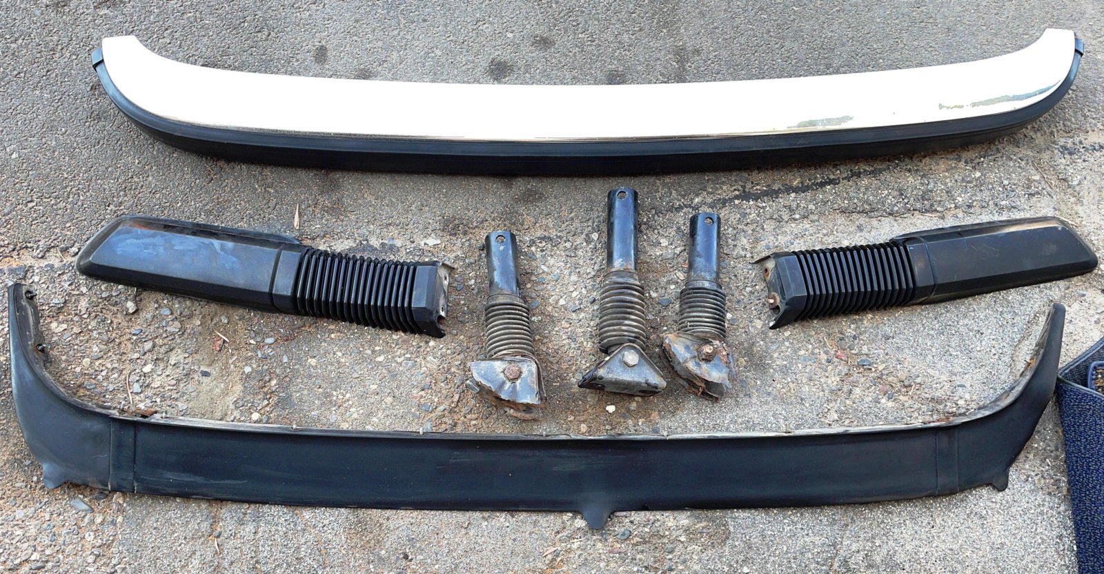

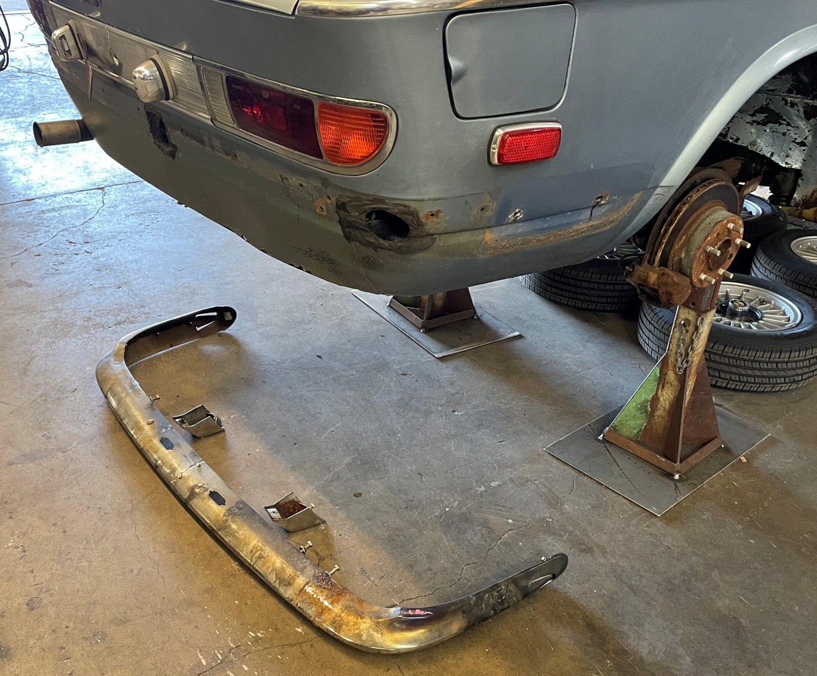

I've always been curious what the weight difference is between the U.S. Federalized bumpers and the earlier, original <1972 chrome bumper version. I had a good opportunity on this project using my uncalibrated bathroom scale. Federalized = 79.5 lbs vs. early chrome at 44.3 lbs. Full details attached. At a 35 lb delta, I am a bit disappointed as I thought it would have been closer to a 100 lbs. Visually it remains a 400 lb. difference in my eyes. Details attached.
I presume you used the stand on the scale and subtract your weight method. That is what I do, which sometimes prompts my wife to ask why I need to have car parts with me to get on the scale.
Those are some monster jack stands. Like to see the the jack that gets the car high enough.
Having done this same swap earlier this year I can attest that the emotional reward far out weights the actual loss in curb weight.
Curious about the level of rust now that you have had a chance to inspect the car. It looked pretty dry in the sale photos & you do wonder if there was much truth or effect to the reports of rust-prevention application at the factory for the '74+ coupes. Plus the after-market stuff that was mentioned on this car. How does it look?
