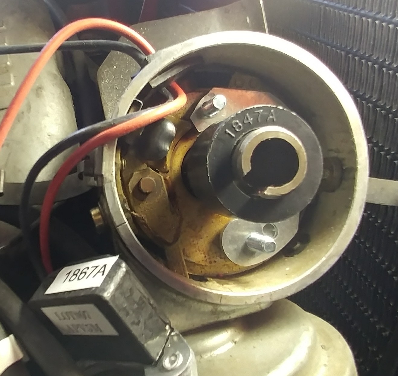

Remove the rotor, if a 16mm socket will slide on the shaft, you have the smaller distributor. If it will not slide on, it's the big one.
any idea which one (Petronix unit) fit your's?
16mm socket fits over my dizzy shaft.
1867A, the magnetic piece doesn't fit over the dizzy shaft.
