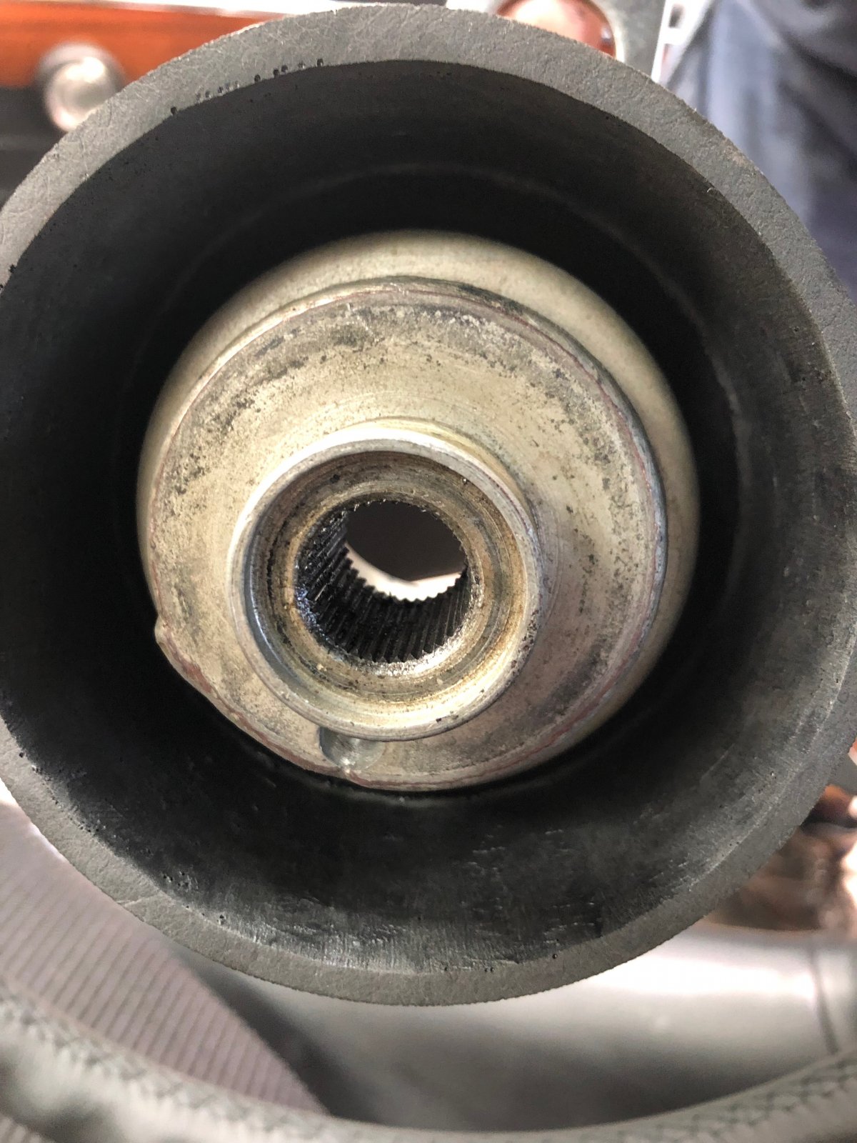

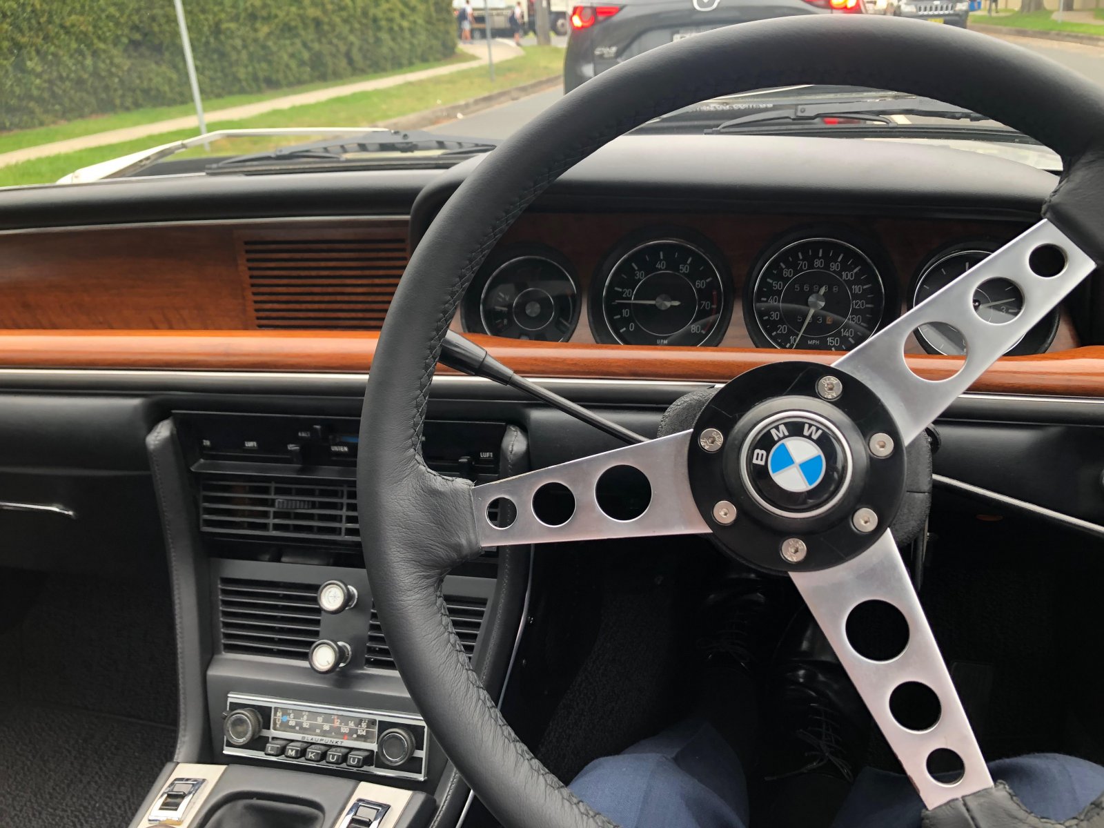

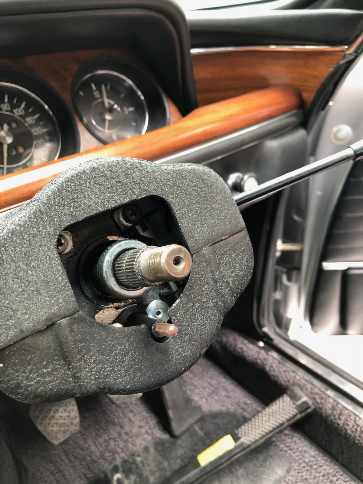

As part of the restoration we replaced a lightweight momo with a Petri and while the horn works it stays on.
The auto electrician thinks there is some sort of disc missing from inside the HUB - anyone had a similar experience or have some pictures so we can see what he means?

this is a simple one, you are missing the copper ring at the base of the steering wheel hub for the plunger to make contact with. check with Keshav or Wlakek ... one of them has remade this piece and by installing this on the base of the wheel should solve your problem
