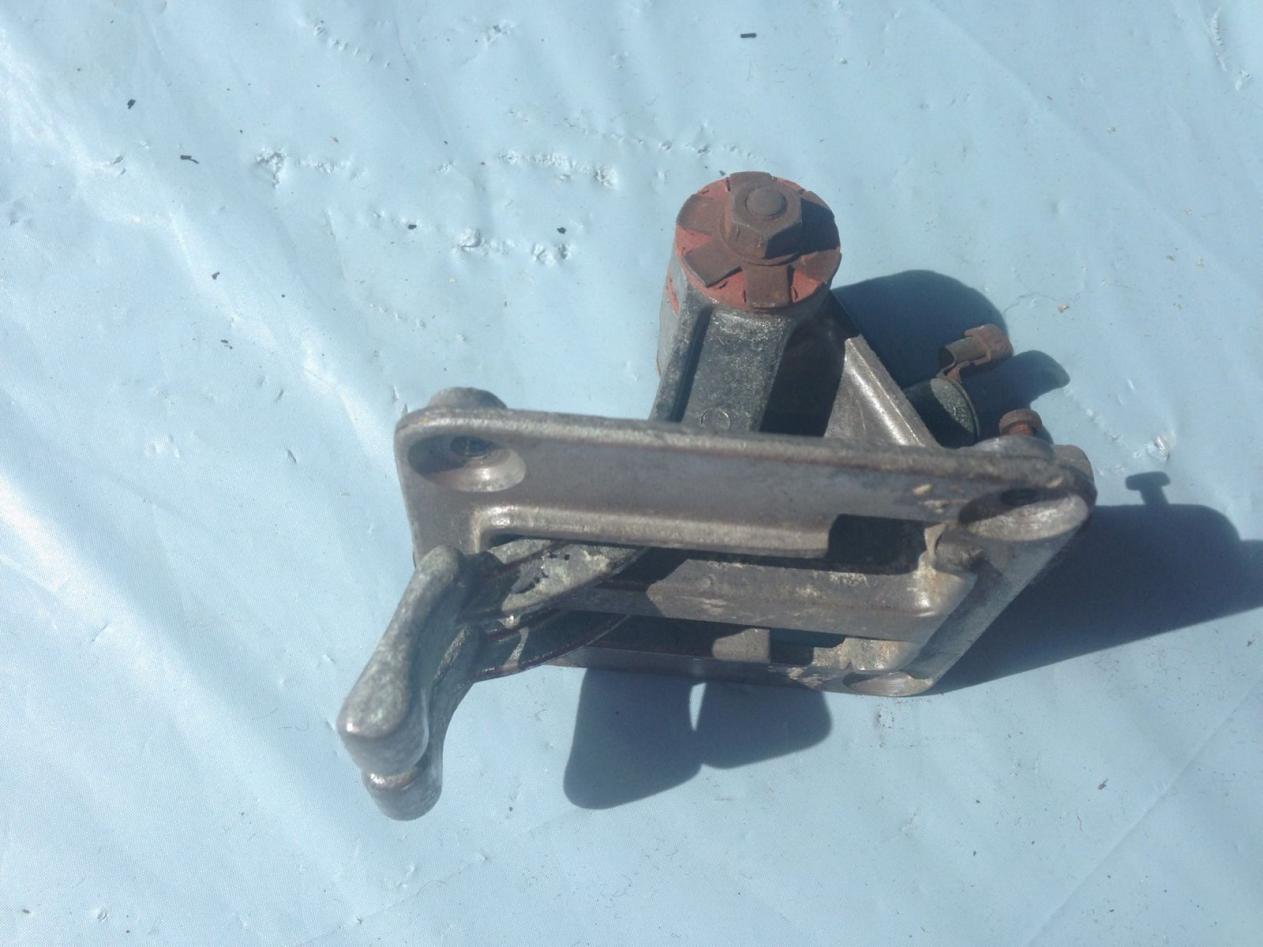

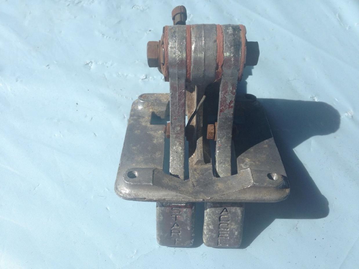

Didn't have to on the Alfas. The factory provides a nice lever assembly with adjustable friction washers. You pull back the "start" lever and it pulls the cable that actuates the enrichment devices and holds them in the full or partial positions.
I did have to install a choke cable on my 2800 CS to accommodate the manual chokes on my 32/36 DGV down draft Webers. But of course, those have a conventional choke butterfly at the top of the carb and a cam that advances the main butterfly shaft.
Do the Alfas have a mechanism to increase cold idle throttle opening? Or is the cold start enough to keep it idling till warmup?
That's a good question. That lever assembly I spoke of has two handles, one that pulls the enrichment device levers on the two Webers, and another that pulls on the gas pedal. That second one will increase the minimum engine speed, but it's kind of a coarse adjustment: either regular idle or 1,500 rpm. See photos below, which show the handles in the fully pulled out positions.
In normal operation, I just use the enrichment device. The idle speed does come up a bit, I suppose from the additional fuel. But the big benefit is that the engine doesn't stall and idles fairly smoothly while it is cold. So yes, the cold start is enough to keep it idling till warmup.
