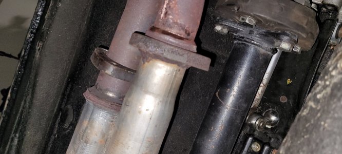

Right now, the car has a M30B35 with the original exhaust manifolds (due to the ~20 degree output flange twist vs the B35 units) and original dual downpipes with an O2 bung. So I'm hoping to use the SuperSprint downpipe to resonator coupler without issues. I figure I'll have to re-make things or make an additional stainless section to go between the S38 header output to the stock downpipe exit location.

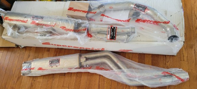

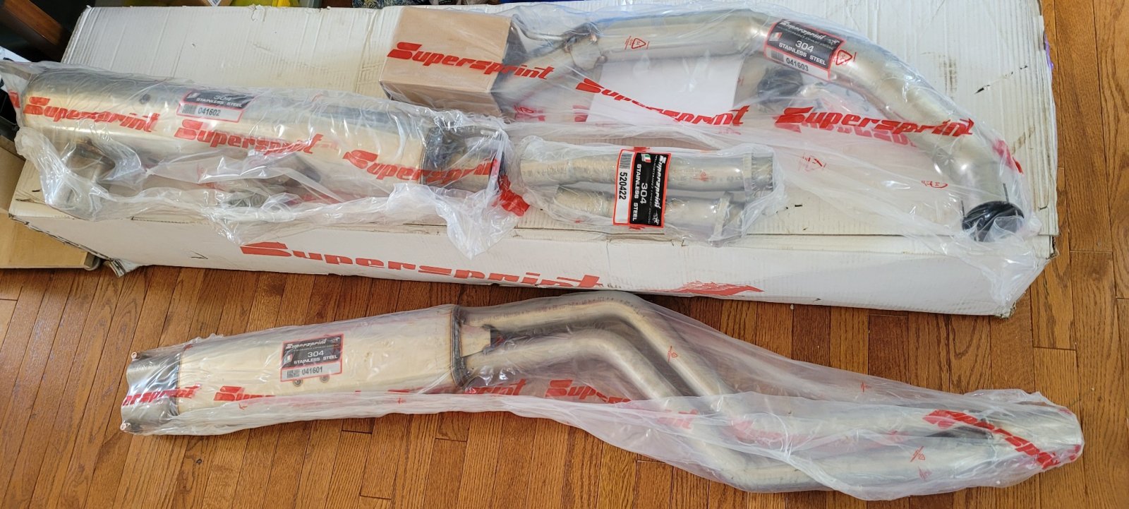

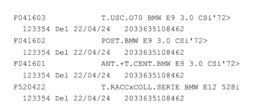

Here's all the parts I ordered, for a complete post-downpipe system. They arrived on Monday, but of course I got a cold on Sunday night, just in time! I did manage to get the car all lifted up on Jackstands and ramps yesterday, though, which should give me enough creeper clearance. I don't have a lift (garage ceiling is too low for a 2 post) so this will be interesting, particularly since the original system was thrown together with a mish-mash of parts.
Current link to the E9 system: https://www.supersprint.com/ww-en/supersprint-performance-sport-exhaust-bmw-e9-30-cs.aspx

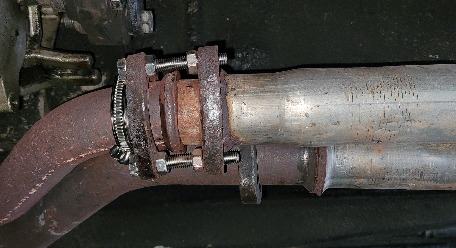

Bit of a wrinkle: I can't seem to get the old system off. I have attached a picture of the joint with the bolts removed. Any suggestions? The downpipes are the rusty bits. Rather surprising since they were new. I already pulled the hangars from everywhere else, so this is the last joint on the old system.

OK, have a plan-
I'll get a U-clamp to put behind the downpipe flange, some extra nuts and bolts, then use the flange as a 'puller' to push the exhaust end off. I don't want to use a torch because of gearbox oil leaks in the area and I am working on a creeper with limited height.
Well, I got the system off, but unfortunately my plan failed.
Here's how it came together:
I ended up torqueing it so much that I bent the bolts. So something else had to be done. I went for the nuclear option and used a jigsaw. Once I got the system off, I could see the old shop had welded the downpipe to the tube, so there's no way I could have gotten it off.

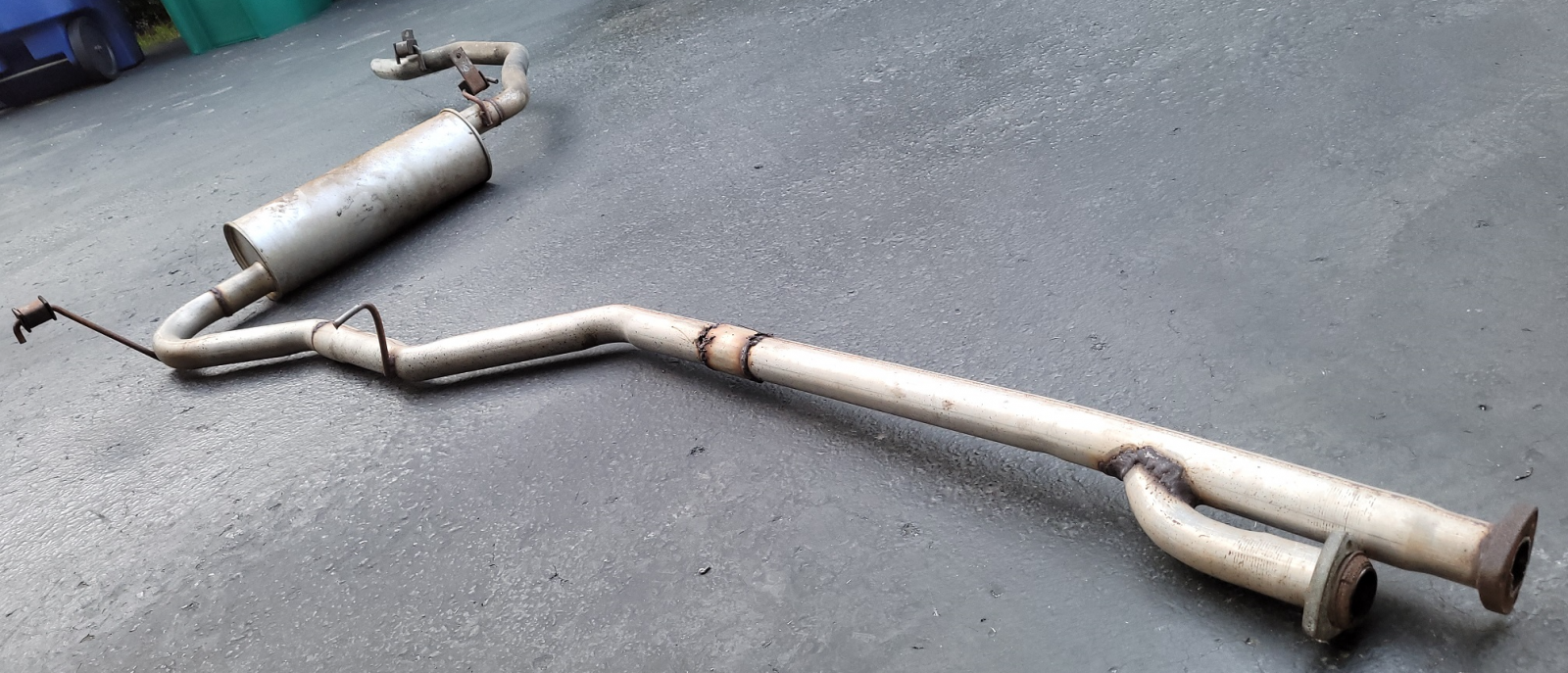

Here's the old system removed:
Now I need to snag a couple of the torroidal gaskets and start putting the SuperSprint system together.
