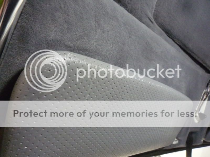

Here is the visor. What color had Grey originally if it wasn't used on Silver cars?
Original colors of--
visors and headliners were all white regardless of exterior paint color. I do understand that CSL's had visors that were 1/2 white--when in the up position--and 1/2 black when folded down--believe it was to minimize reflected glare.
The original orange parts books confirm that only one visor was provided for non-CSL coupes, other than accommodating LHD vs. RHD and various country requirements, meaning it was white. The CSL used black.
