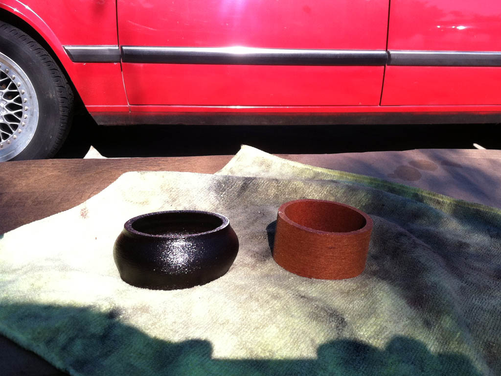

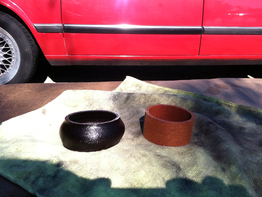

Anecdote: The PS filter was the root cause of PS squeal on my E24 once upon a time. They get old and yucky. Replace it and fresh fluid. Cheap and easy. Just do it. Even if it doesn't resolve your problem, you'll have done a good thing.

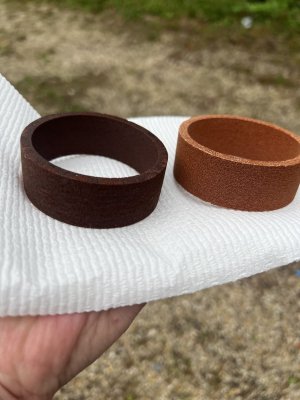

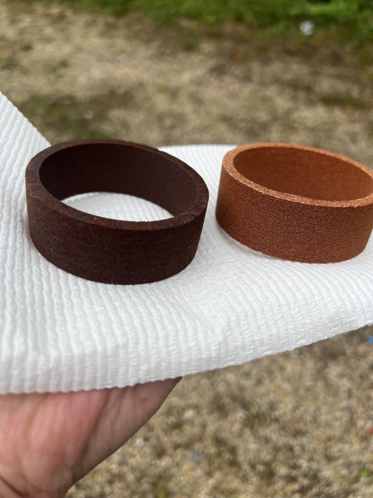

A fun "how's the filter?" The new one is on the right.

And how does your PS filter look?
Replaced the PS pump filter. It didn't look that bad. Refreshed the fluid. Still same noise, but goes away after driving for five+ minutes. When cold the noise starts again. I'm assuming belts are next?

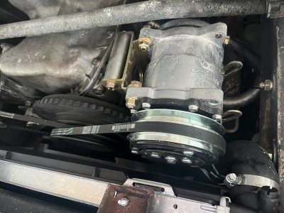

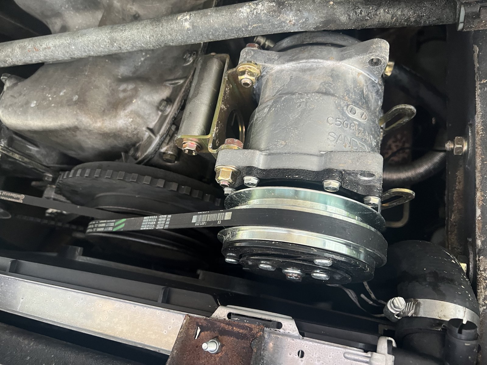

The PS pump to crank belt is a Continental AVX 10 x 888 la (It is connected directly to the crank not the water pump). I didn't get a good pic of the alternator belt. See attached. Anyone have a guess on which belt fits the alternator? I'm a good distance from the car. Again the engine is a M30B35.
Thanks @sfdon et al.
