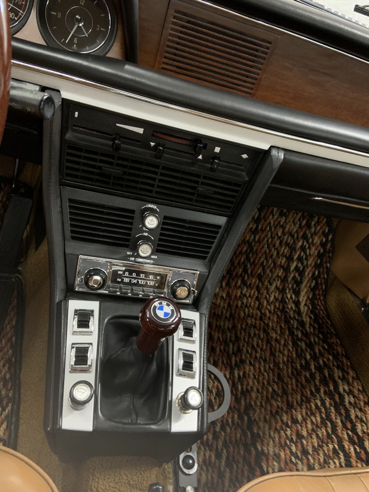

I am looking to replace the aluminum trim around the power window switches. Does anyone have a source for this? Thanks

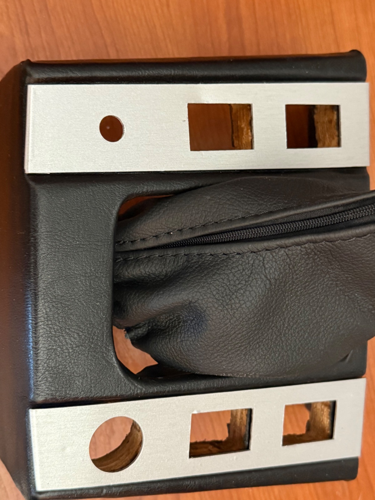

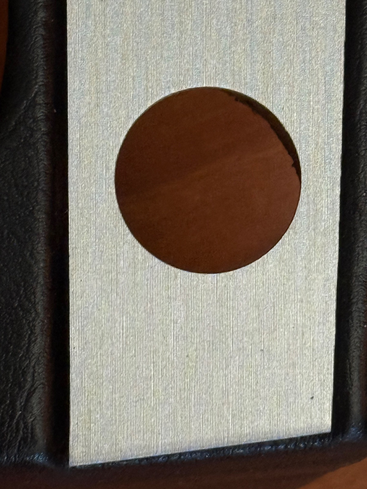

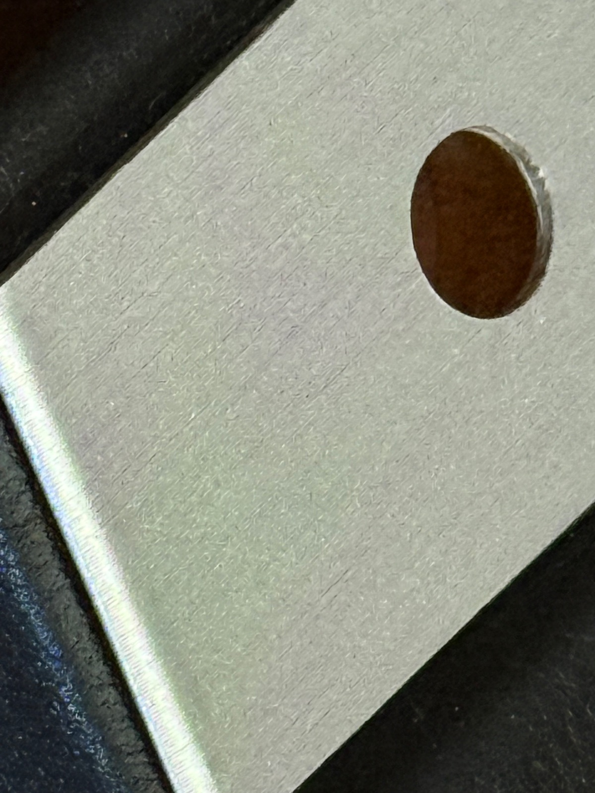

Hi,

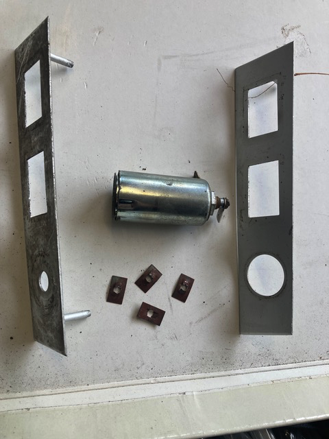

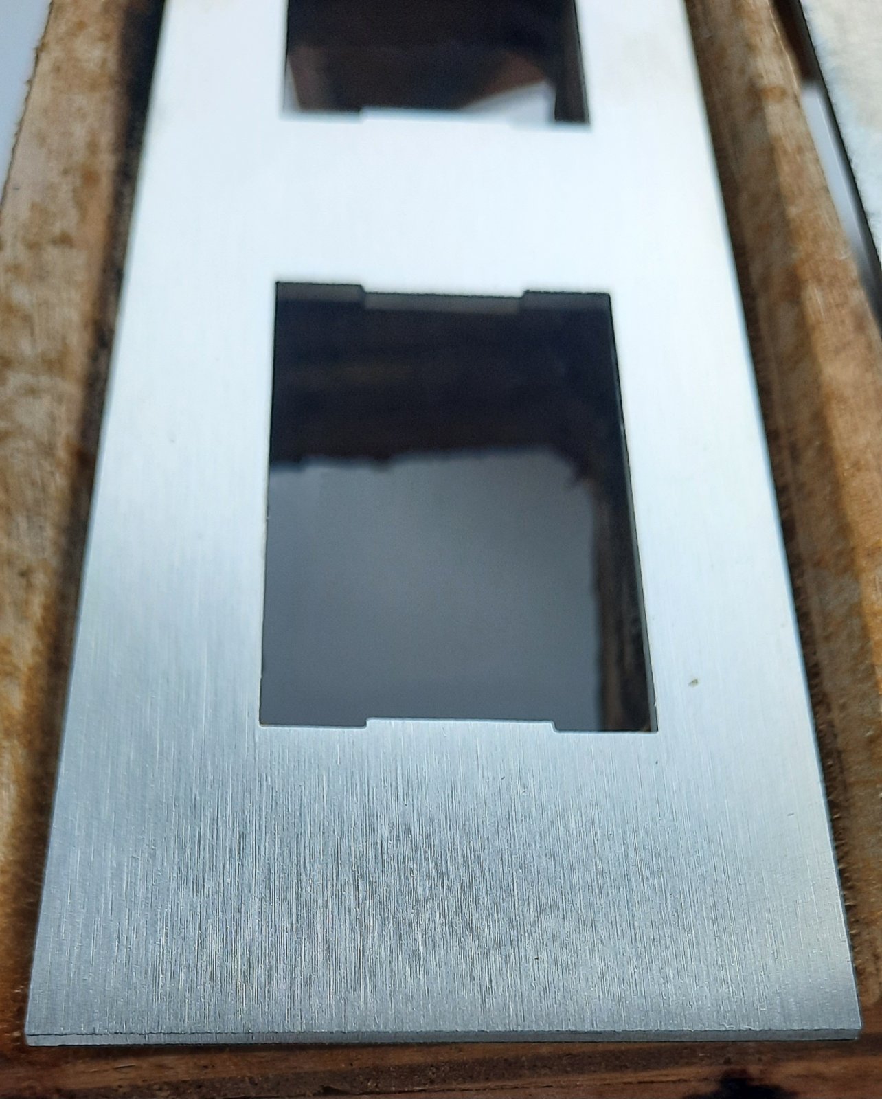

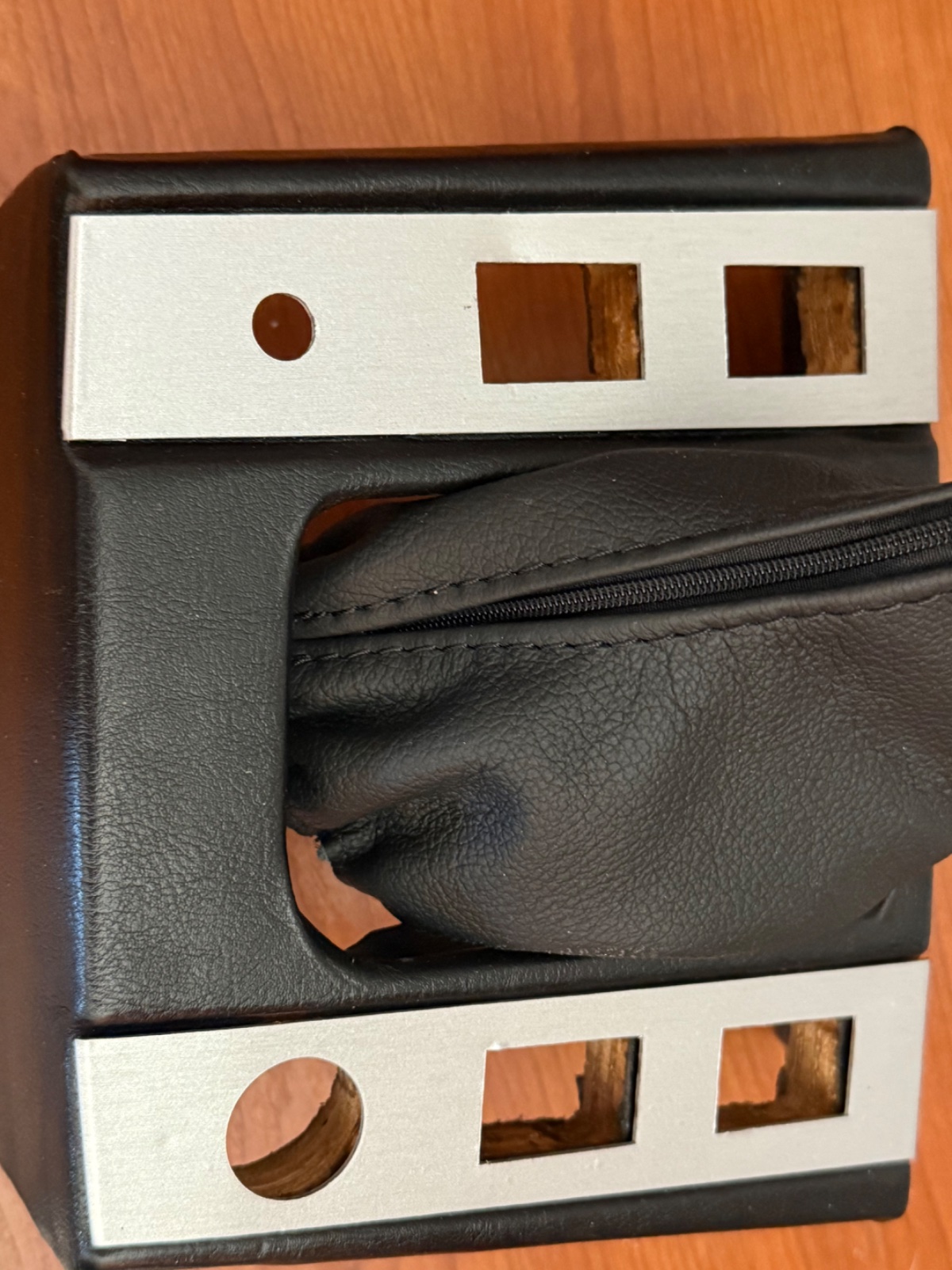

I am just trying to do a reproduction of these trims, with the help of a company specialised in sheet metal working.
Here are the first results:20240823_100940.jpg
- scanning of the original trims
- auto laser cutting the aluminium sheet
- auto bolting a M4 screw by arc welding

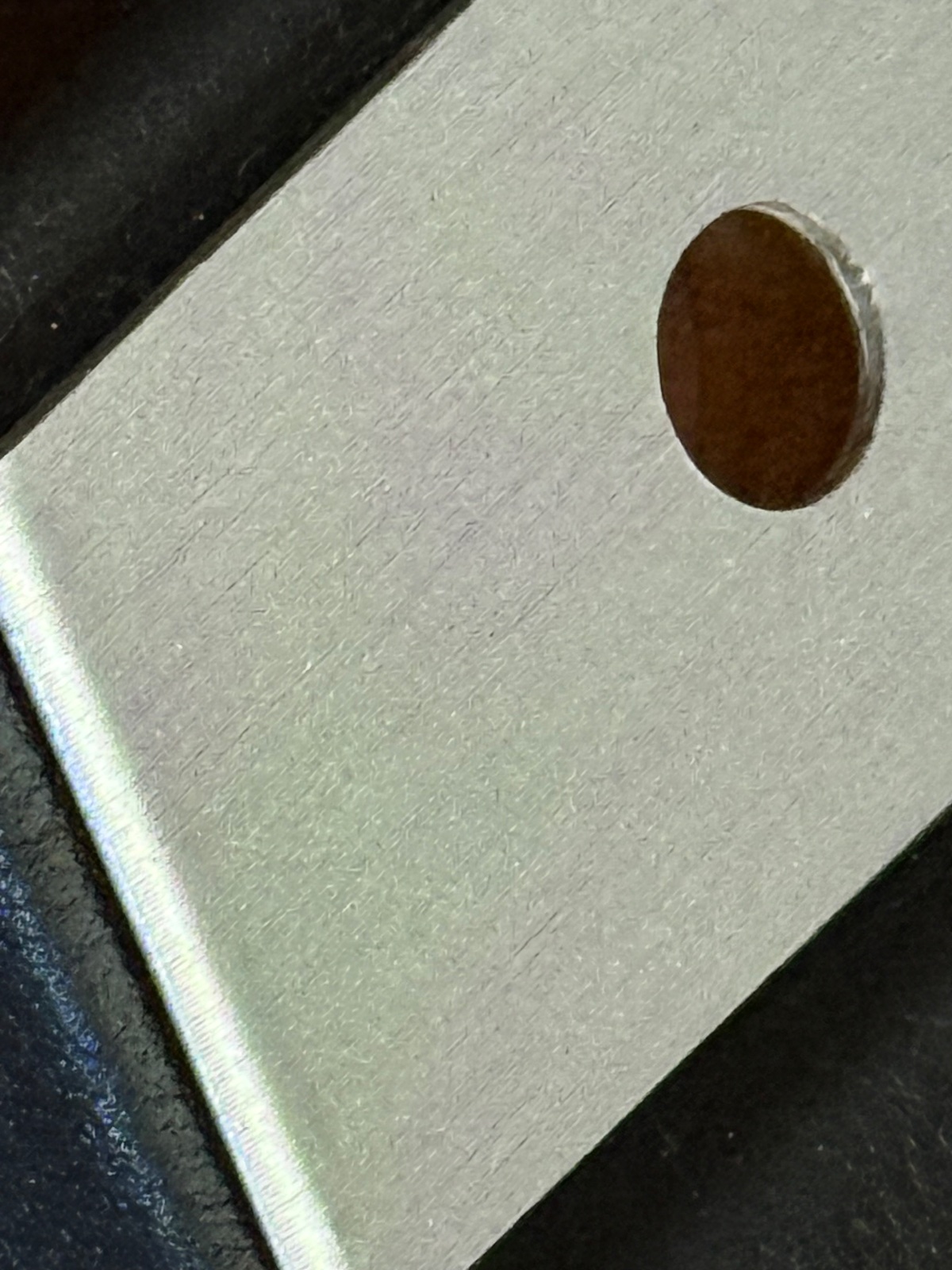

- "scotching" the surface
The result is perfect,
but the stress test revealed the possibility of the bolts loosening during mounting.
So I will give it another try using stainless metal sheets.
I will report as soon as I have the first results.

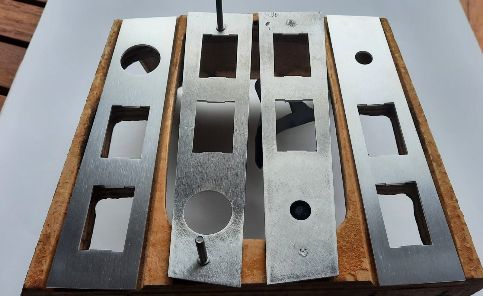

@scamluka ; I think re-anodizing of the originals will also work.
Sand the scratches out, and re-anodise. That's what I am planning to do.

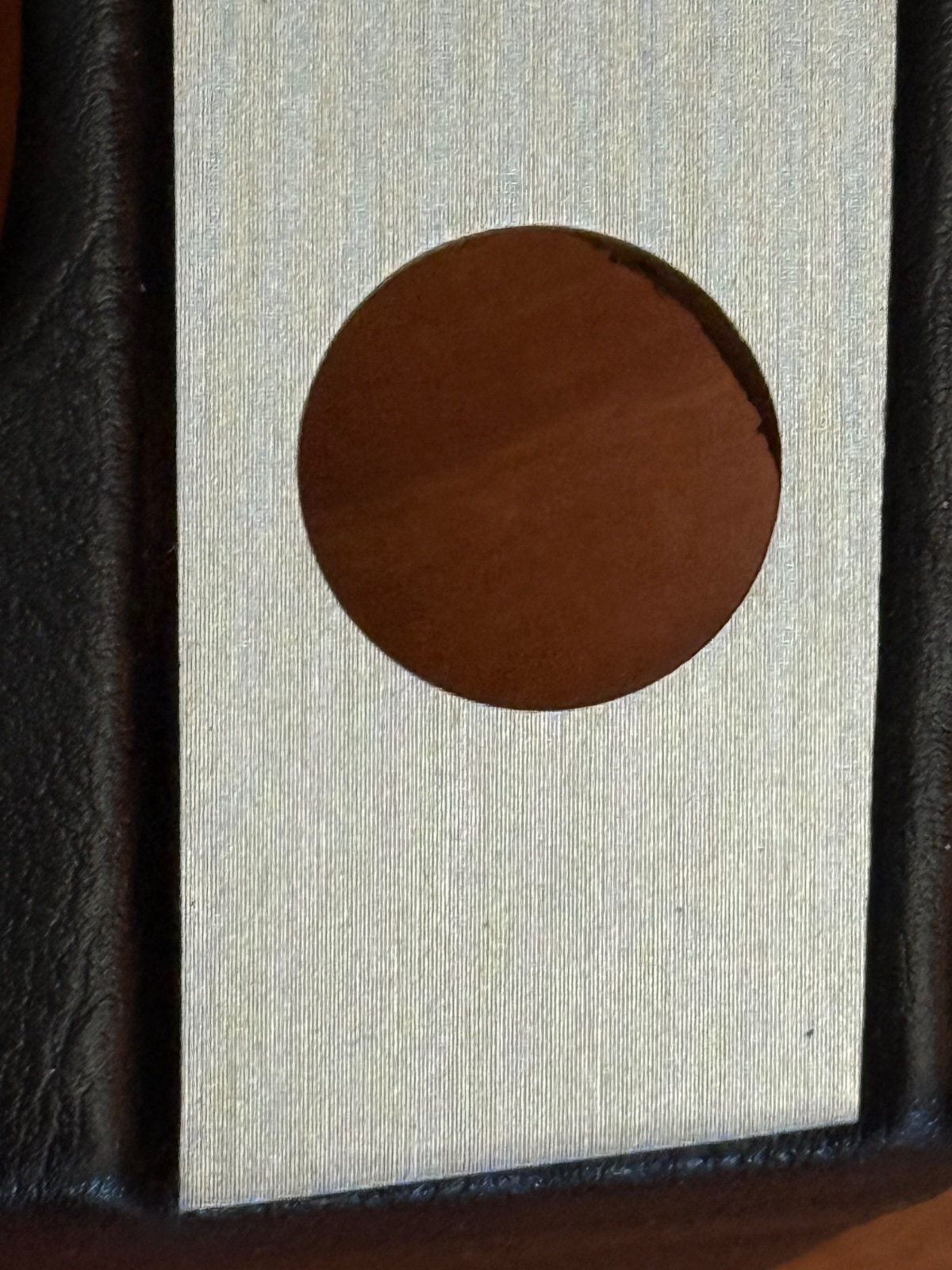

I did and it came out quite nice.
1) easy-off oven cleaner removes the original anodize
2) make a sanding jig out of wood - holes in horizontal board to accept the posts of the aluminum trim piece and add a vertical fence as a sanding block guide
3) trim is not square and you want the sanding brush marks straight so the line between the post is to be parallel to the fence
4) i can't recall final grit on the finish sand - but you will figure it out
