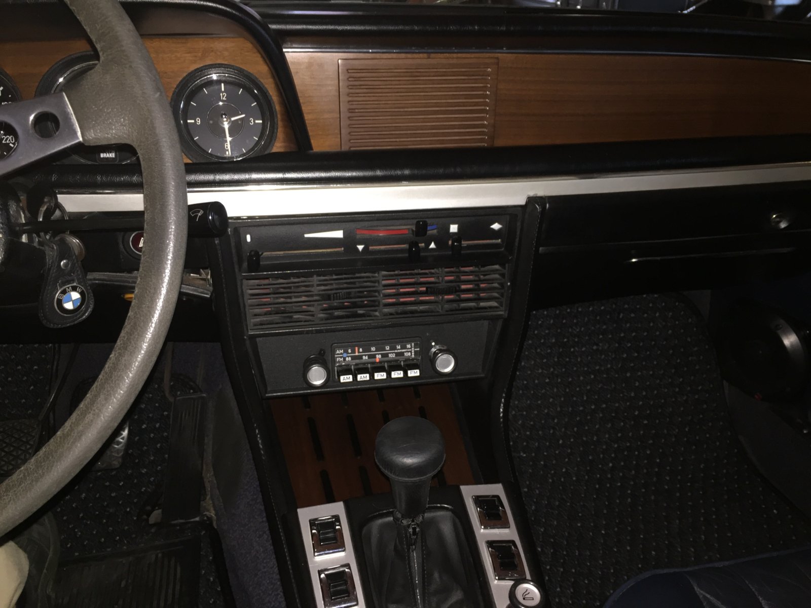

My coupe has an attractive, hand turned wood shifter. It’s fine but I’m wondering if it’s cost effective to recover the OG knob in leather? The original is split and the leather is worse than “patina.” Replacement shifters at $125 seems not the way to go. Thoughts?
