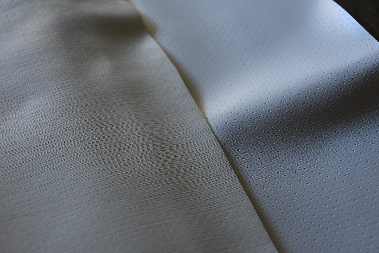

on the left is the original material, on the right from SMS
mark99
1,505
260
Kirkland WA
Chris, I think that is what you meant, the original material that we put in the car, the material that was in there had similar perforation pattern but did not have the orthogonal raised lines, it had what I would call a faint leather texture, the material in the car was thinner than this replacement, I know you have said the only pattern you have seen is as above, but it looked pretty original the way it was glued in, but no way of knowing
