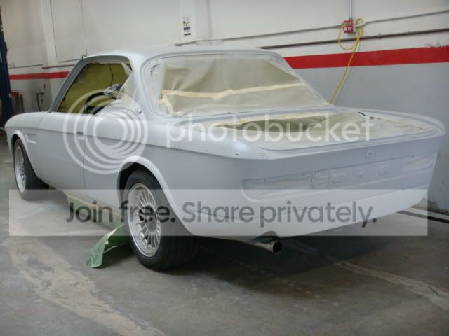

Paint stripping begins =)
Must have scraped 200 pounds off today. Previous owner must be a stock holder of BONDO :? Good news is no rust found :lol:
