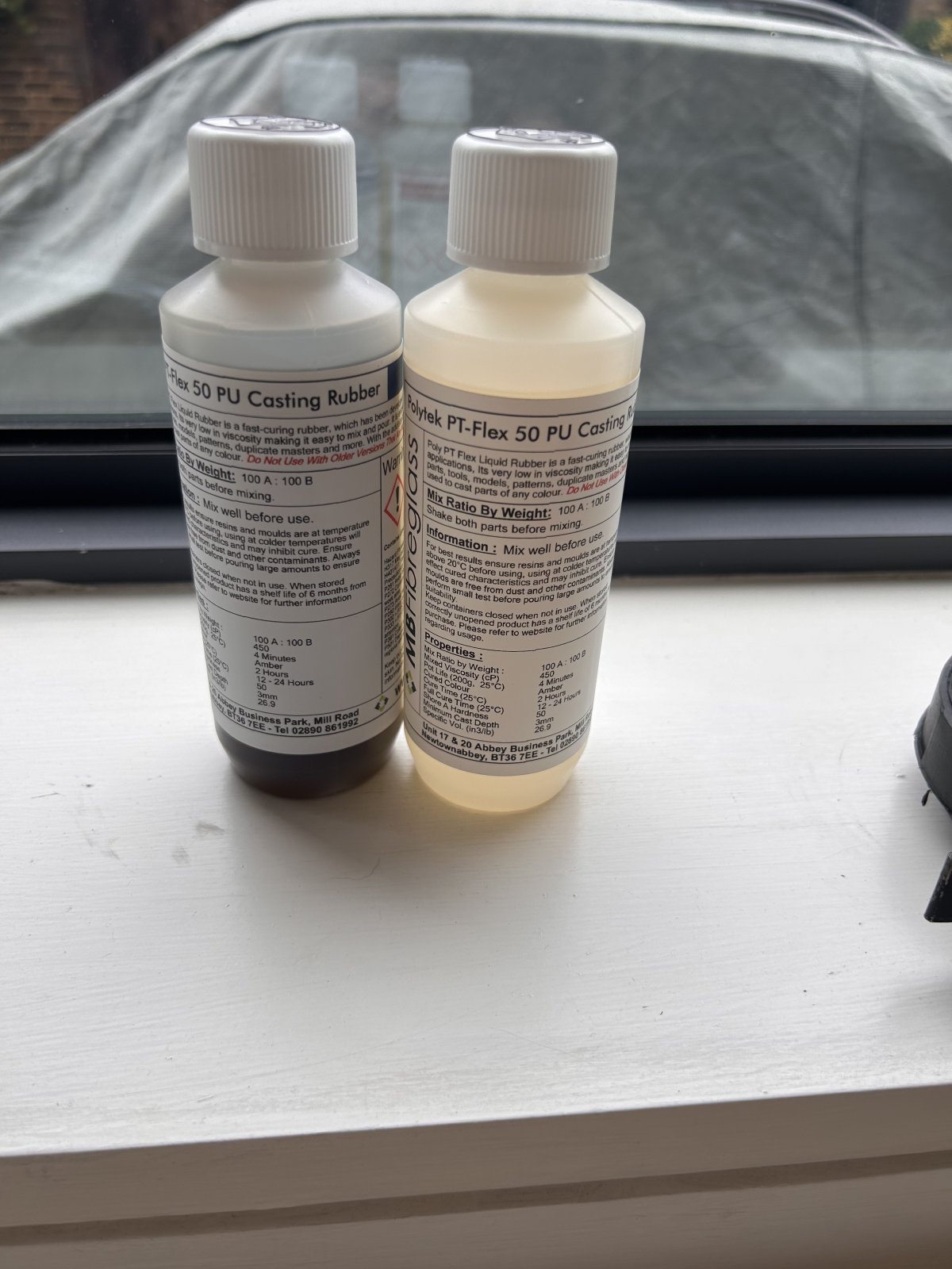

I was told however of liquid polyeurathane. I developed a cunning plan.
This is the Febi bearing and holder fresh from the box. It suspends the bearing in a sheath of rubber but is easily pushed out of true in cases where the prop shaft does not align temporarily as the engine moves on it's mounts.
I bought new mount and bearing for £23 and some liquid ply for £13. After doing some research the rigidity of cured polyeurathane is on a scale called the Shore scale. A80 is racing grade and A60 road going grade. Because I already had the existing rubber sheath I decided upon A50.
It takes 2 days to fully cure and I have yet to fit it to see whether it works. The polyeurathane should bond with the existing rubber or so I am told.

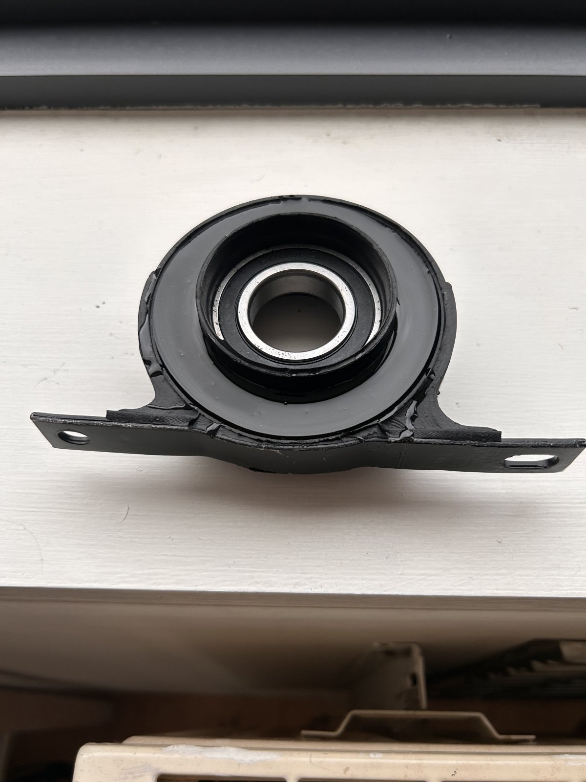

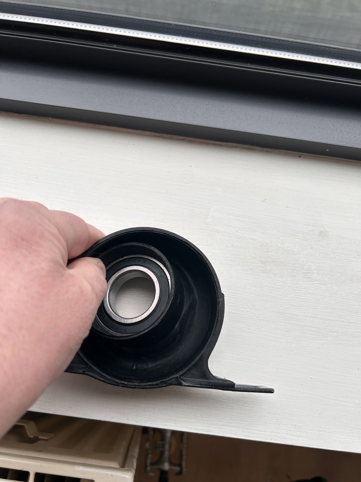

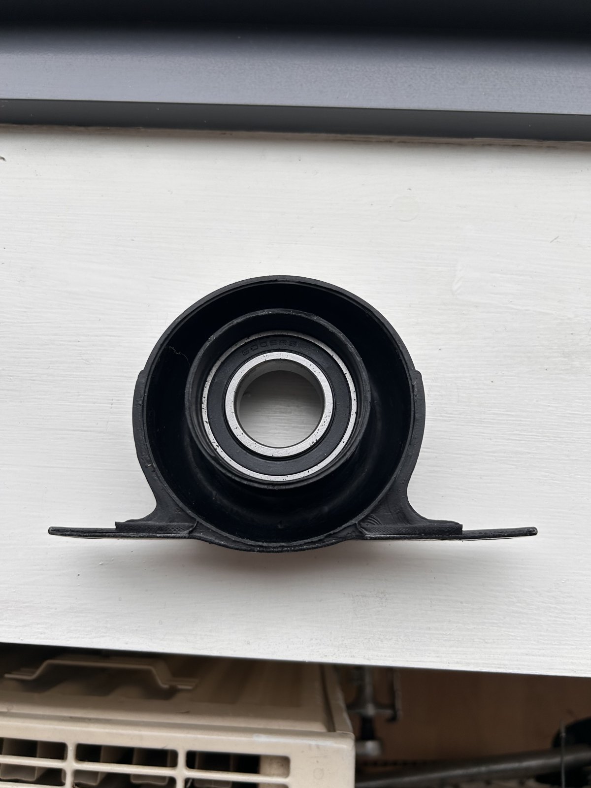

The result after a pouring which took less than 5 minutes is as per the following images.

I remain confident but cautious. I take your point on pre-loading and that was done. The mount is also new. I have 256bhp as opposed to 170bhp standard so 50% additional power means something is necessary. Either engine mounts or propshaft bearing holder, and the propshaft bearing holder was easier.
