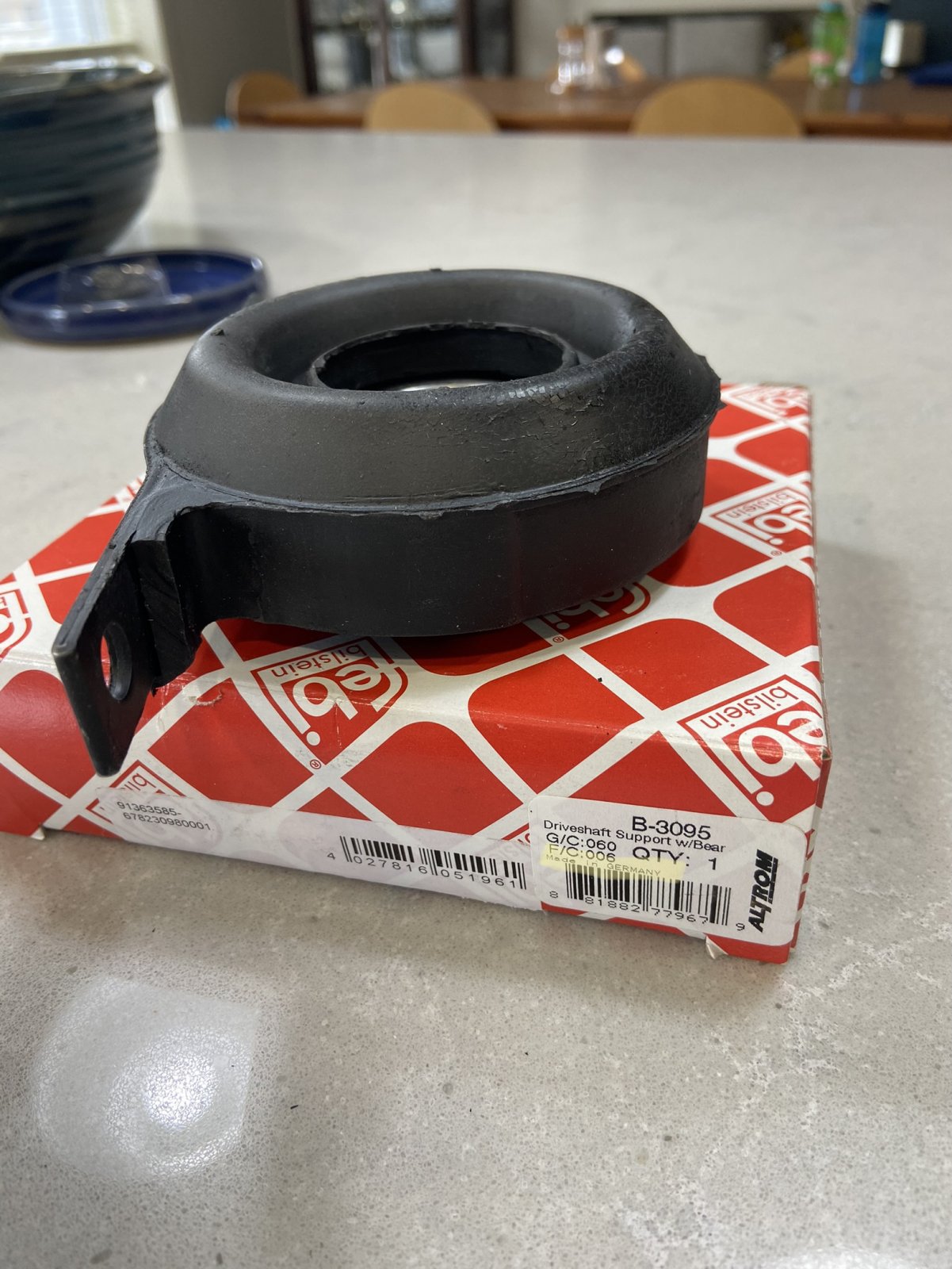

Hi there
I was wondering if from members experience, is a manufacturer of a centre support bearing prefered over another. Like is SKF prefered over Febi, for example.
Cheers
