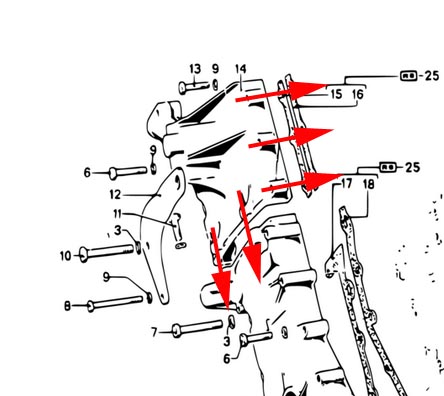

I haven't looked in the service manual to see if it references this but what's the proper way to tighten the upper timing cover on an M30? There are very few applications that have bolts that tighten gaskets at a right angle to each other and was wondering how you guys go about it. Do you tighten the bolts into the head first or the lower timing cover? Does it matter?
The key is fill the corners with black sealant, tighten very lightly on the 6 bolts going back to the head so the 2 down facing bolts go in easily. If the timing cover isnt flush the 2 down bolts will crossthread and wreck the gasket.
