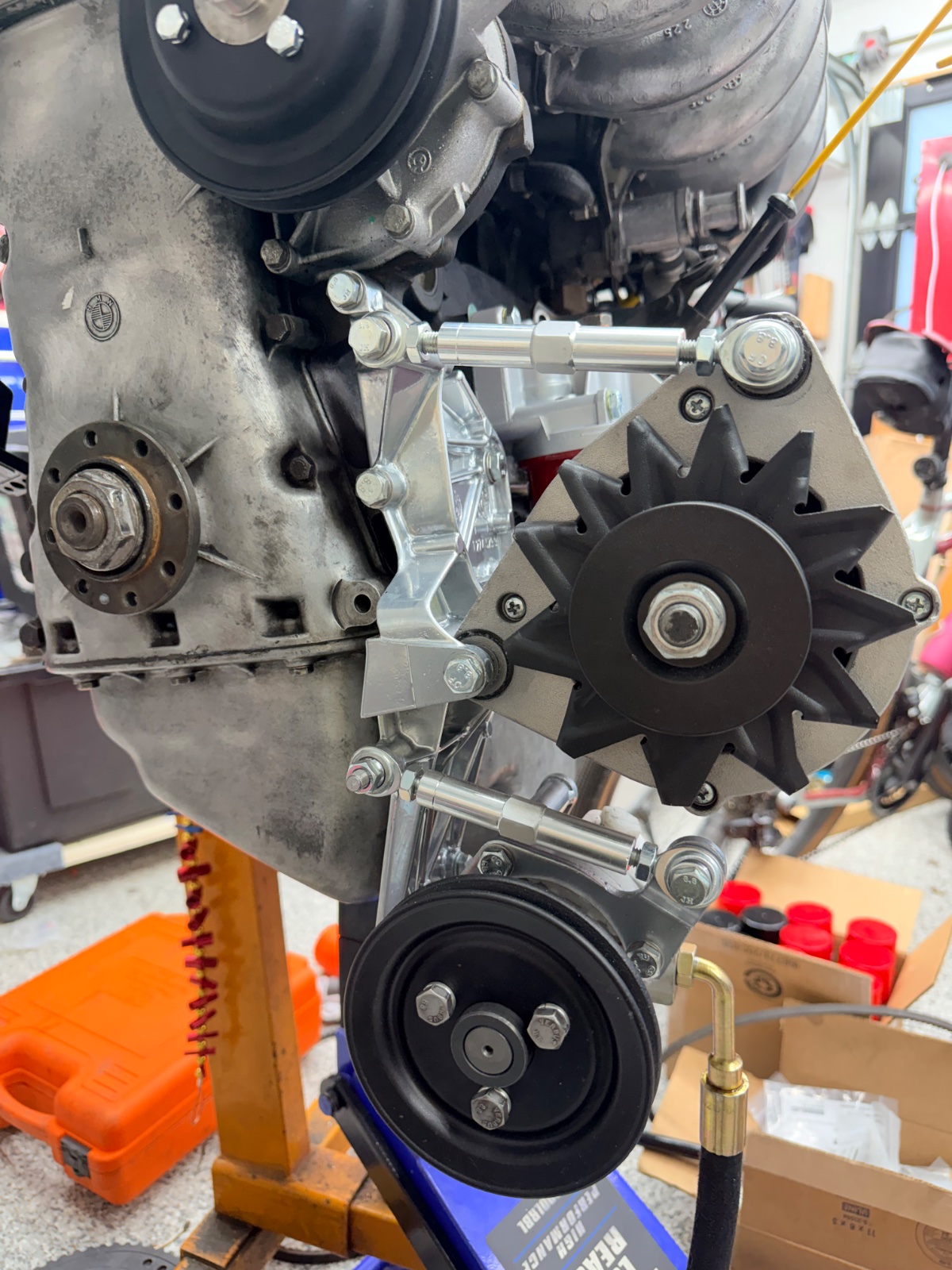

Having been (slightly) through your pain I will say that for the alternator and power steering pump adjustment brackets, I found the Ireland engineering bracket FAR easier to install and use than the castellated nut traveling along the toothed track option. You still need the bottom support bracket but these worked great for the top and are easily adjusted with then a lock screw.

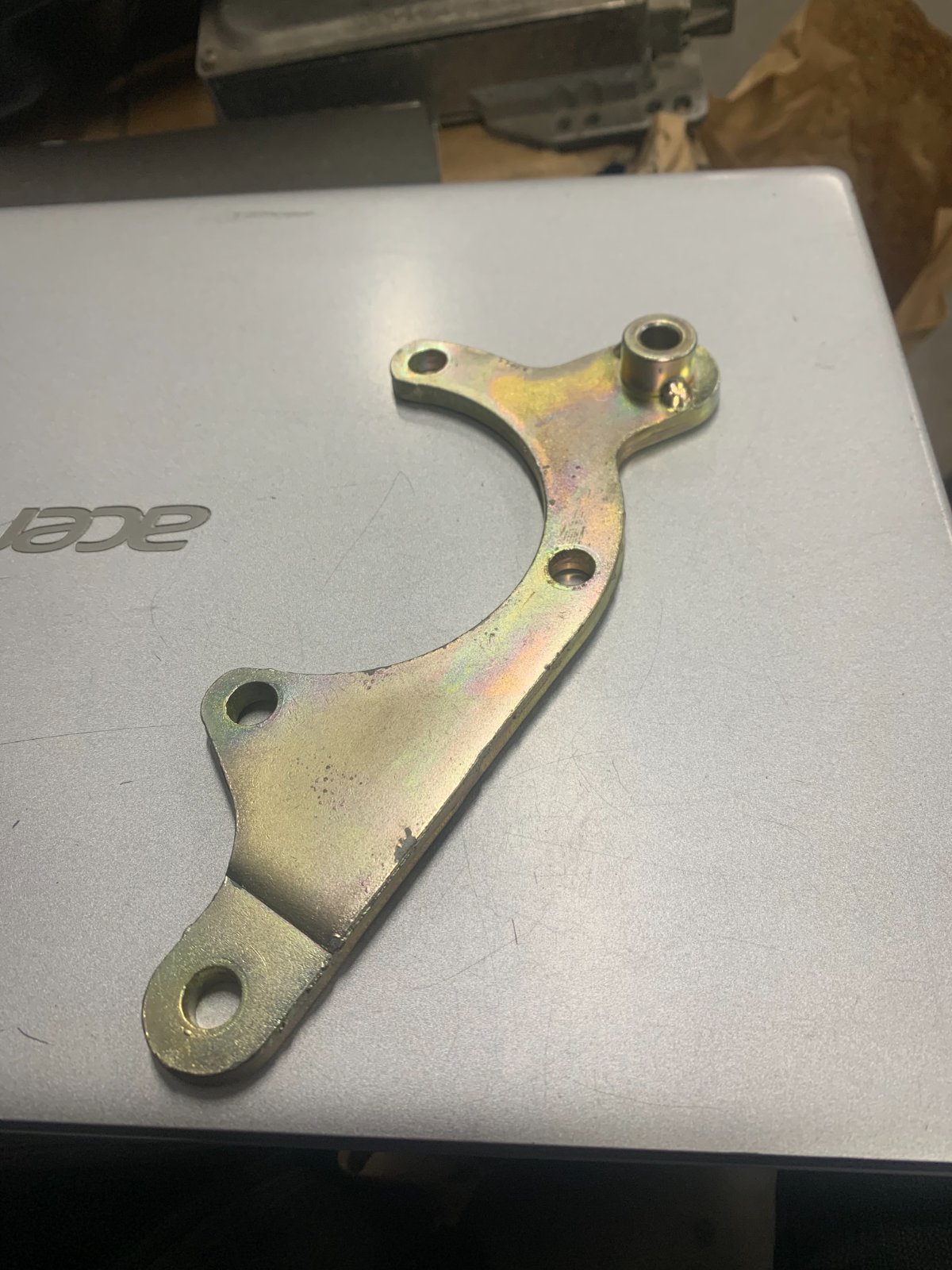

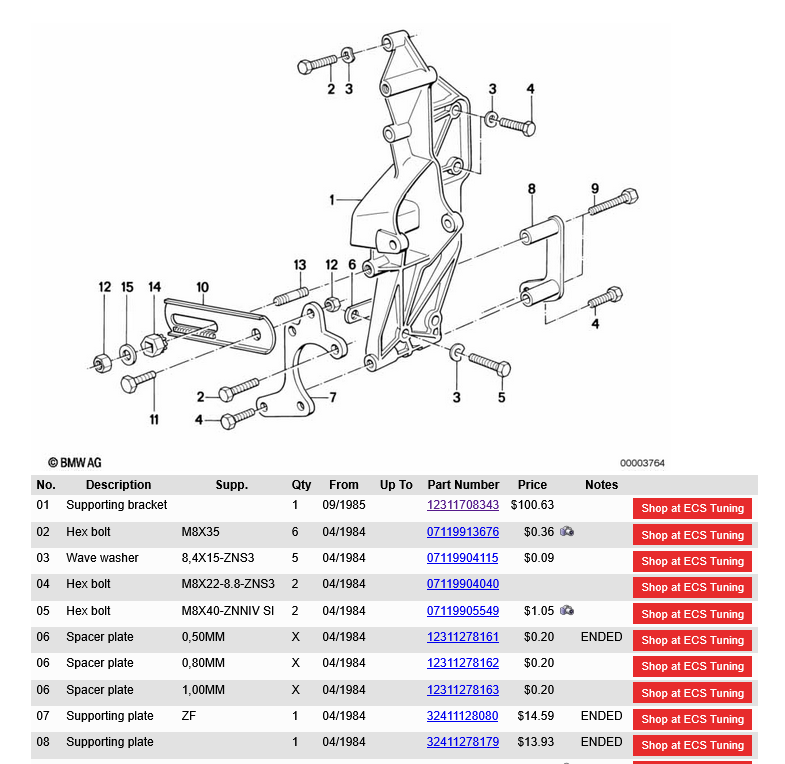

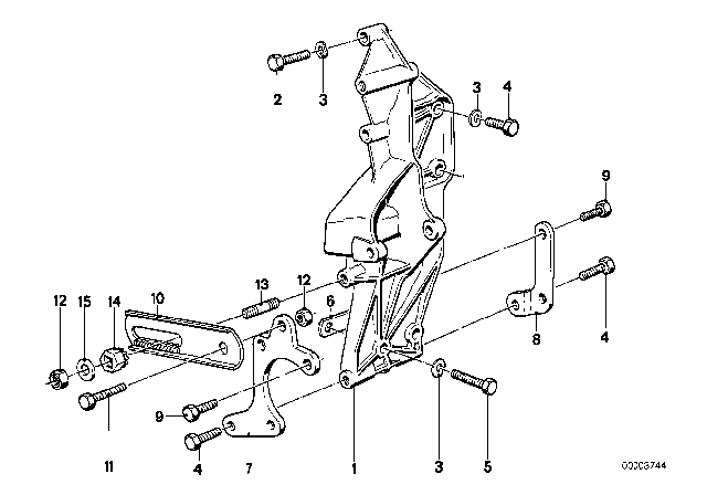

This is the PS/Alt bracket I have and it shows some different brackets from the one rsporche posted.
i know that i posted the diagram from the e28, perhaps it was the b34 engine. #8 is the same shape, it just doesn't have the extensions on the diagram i posted.

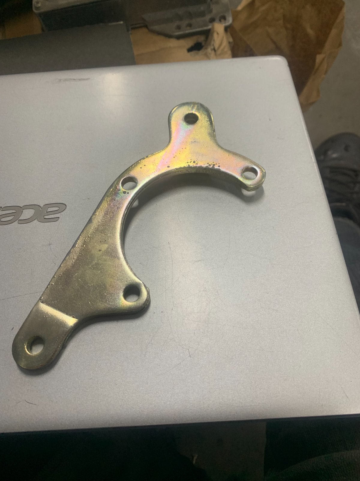

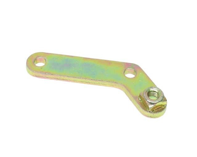

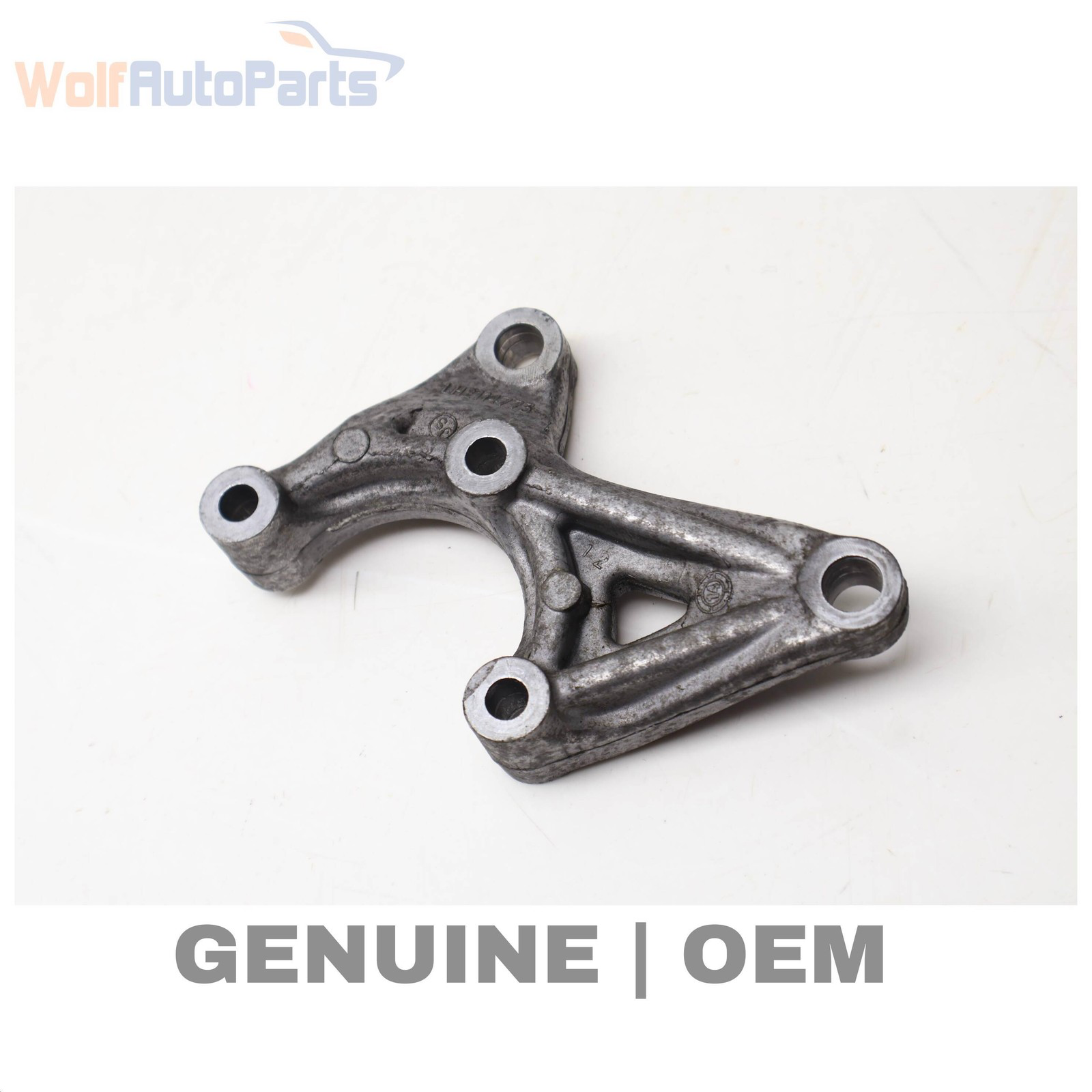

Since I've been through your pain, here are some other options. Really what you need is not this EXACT bracket, but anything that has the same configuration. At worst if the offset between engine and pump has changed you would just change the belt length. The bracket has a circular portion with three bolt locations holding the pump in the front and then one bolt to the engine. The rear has one bolt securing the pump and the other to the engine. Here's the rear (sorry links are coming through in full length)
https://www.ebay.com/itm/1559179610...gbLPf8CH3IPUflMl5nT7mT7GNyI=|tkp:BFBM-JKY6L1n
Here is a front bracket that may have the same configuration and is $10, so perhaps worth a try
Or, if you REALLY want to make sure you have the right one, you may need to purchase the cheapest pump+bracket you can find. I realize that I bought a new pump rather than rebuilding my old one, and the new pump came with the correct bracket already on there. Here's one
