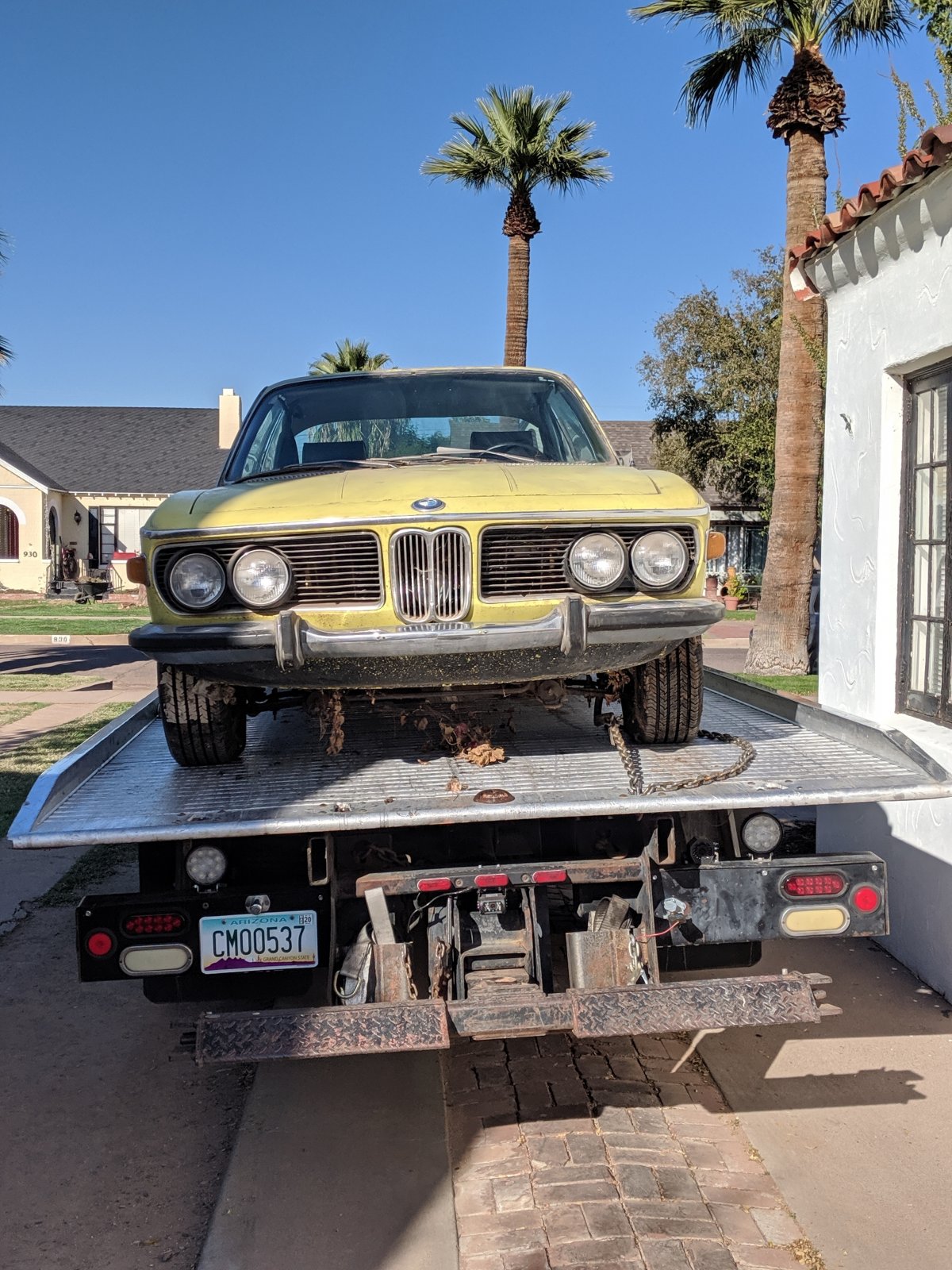

I used a flat top with tilt tray several times during my restoration. Only way to go. Cost me $80 Aud each time to go about 25 km (16 miles).....well worth the money and job done properly. Car winched on front or rear first. ;)
