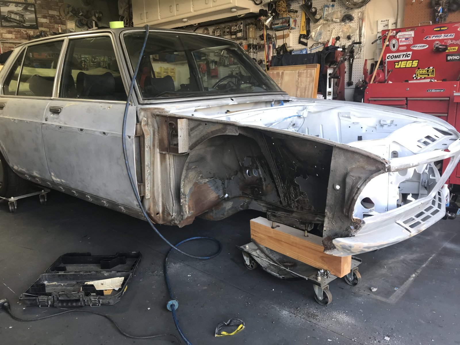

Fenders are easy to remove. You'll have the 10mm bolts along the top edge and inside the wheel wells. Then cutting the seam sealer that's usually holding it together at the top and leading edges. I just recently put mine back on...:-). Good luck!!

Here's a shot of mine from about 9 years ago...yeah, I've been bit slow...lol. you can get an idea of what you'll be looking at.

Should be a bolt or two also when you have the door open near the hinges.
