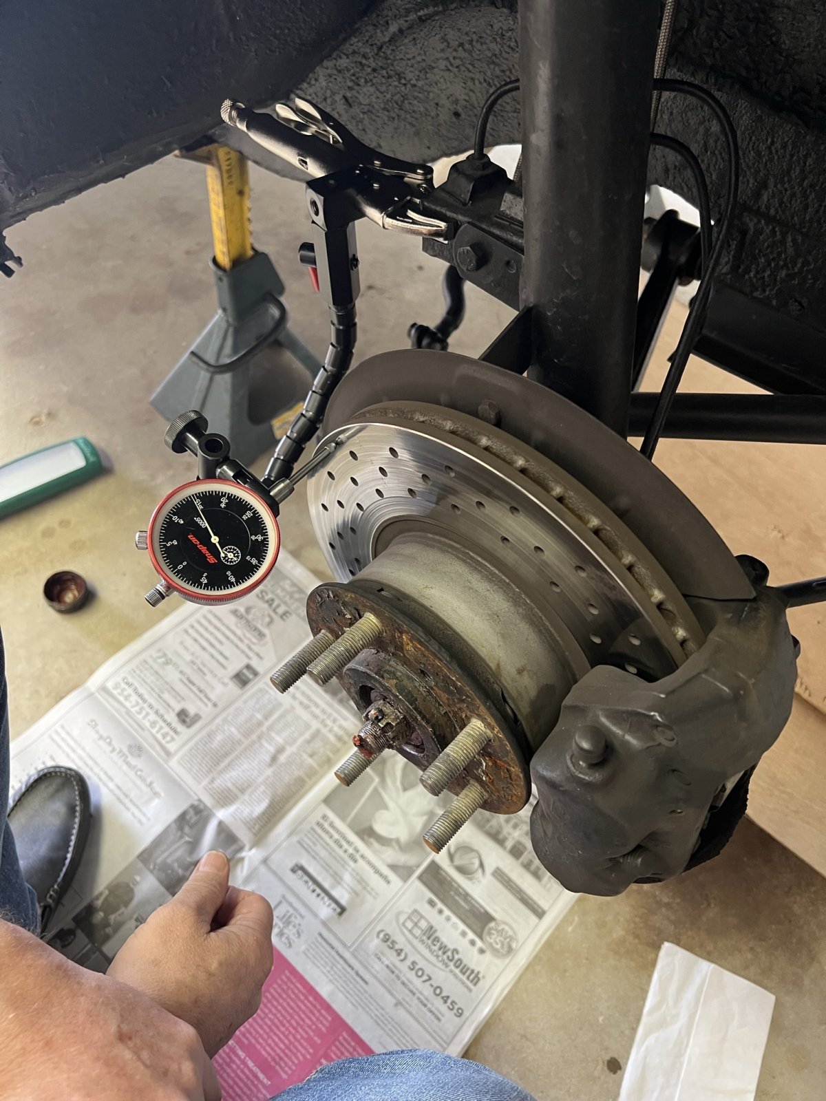

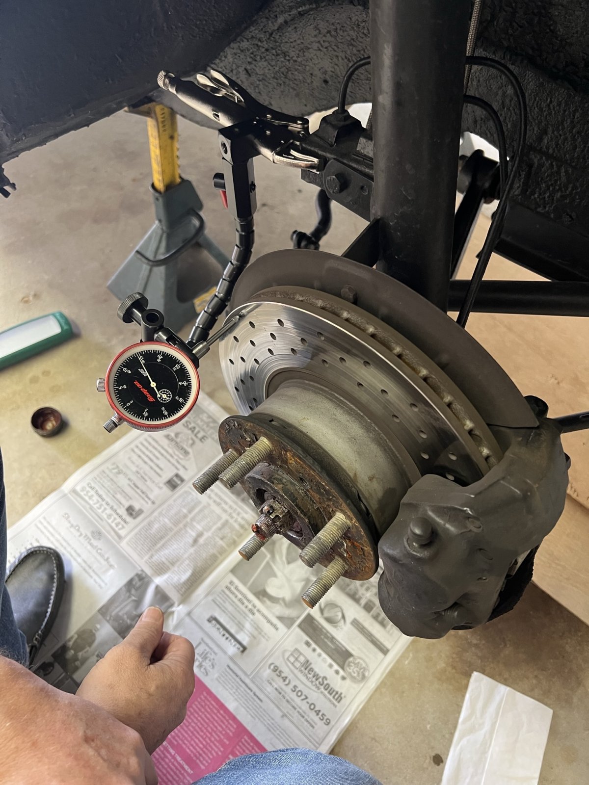

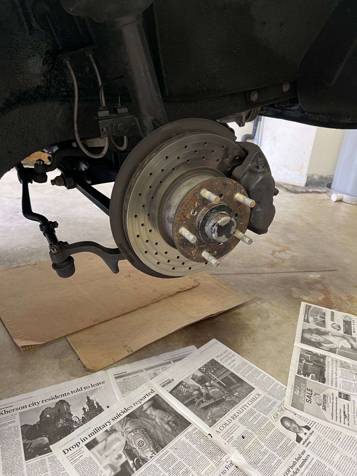

I have been driving my car with pulsing brakes at any speed. The steering wheel vibrates back and forth as I step on the brakes. We all know that means warped rotors. But the runout gauge shows only .001" deflection on both rotors. The Bluebook specs show runout max is .0079". The next thing I checked was the wheel bearings after taking the tire and pulling it in the 12 and 6 position. There was play and the castellated nuts on both sides were tightened so there is no play in the vertical and horizontal positions. My BMW expert also inspected all of the steering components and there is no play. The master, clutch, and slave cylinders were all replaced 11K miles ago.
After all of this, the pulsing is still there. The brake pedal is firm,but I'm going to flush and bleed the brake lines next. The front crossed drilled rotors are from W&N,11K miles ago.
Has anyone experienced and solved this problem?

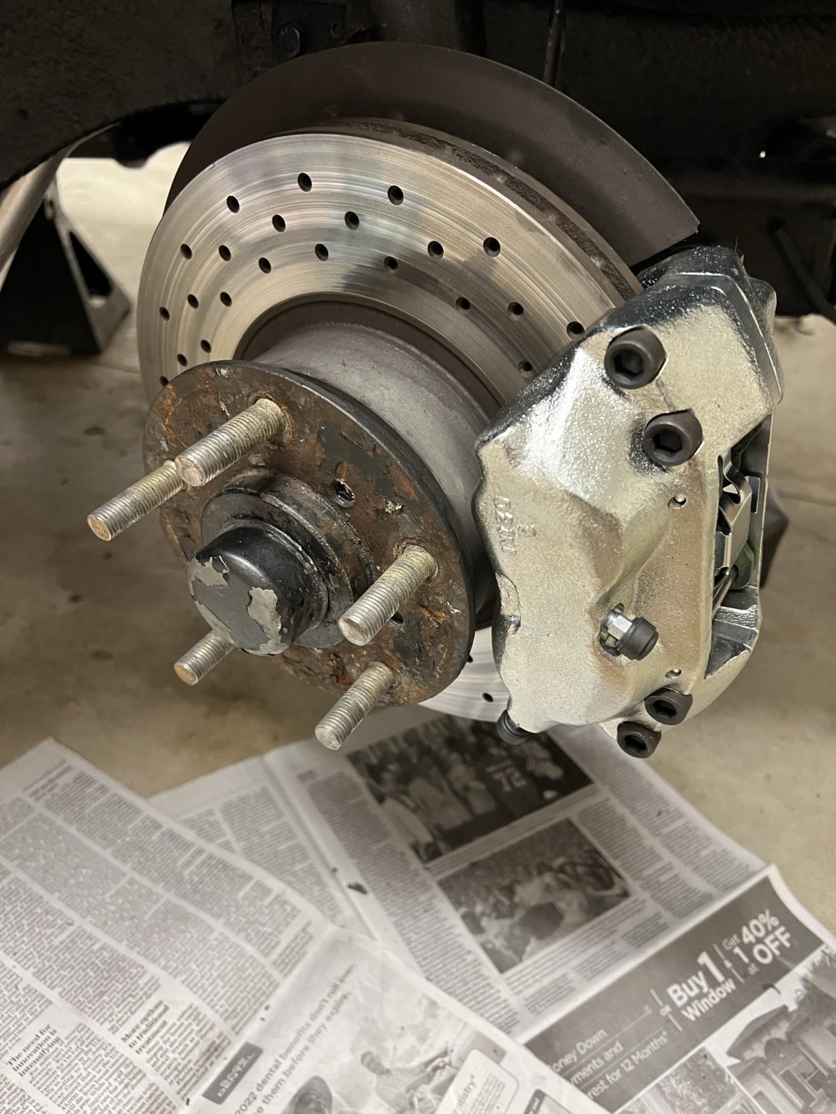

Drew, is that copper grease on the hubs or crud/rust. Unrelated to your issue but hub should be smooth and clean with a tad of copper grease to mate with the wheel rim.

Rob--The hubs have a red-colored grease in them.

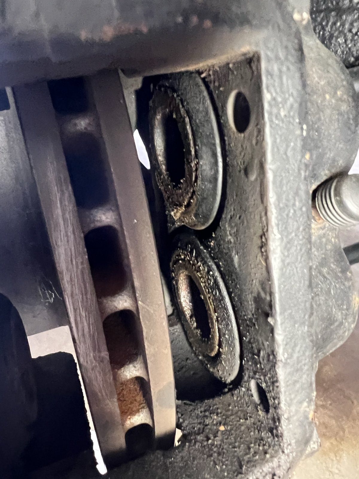

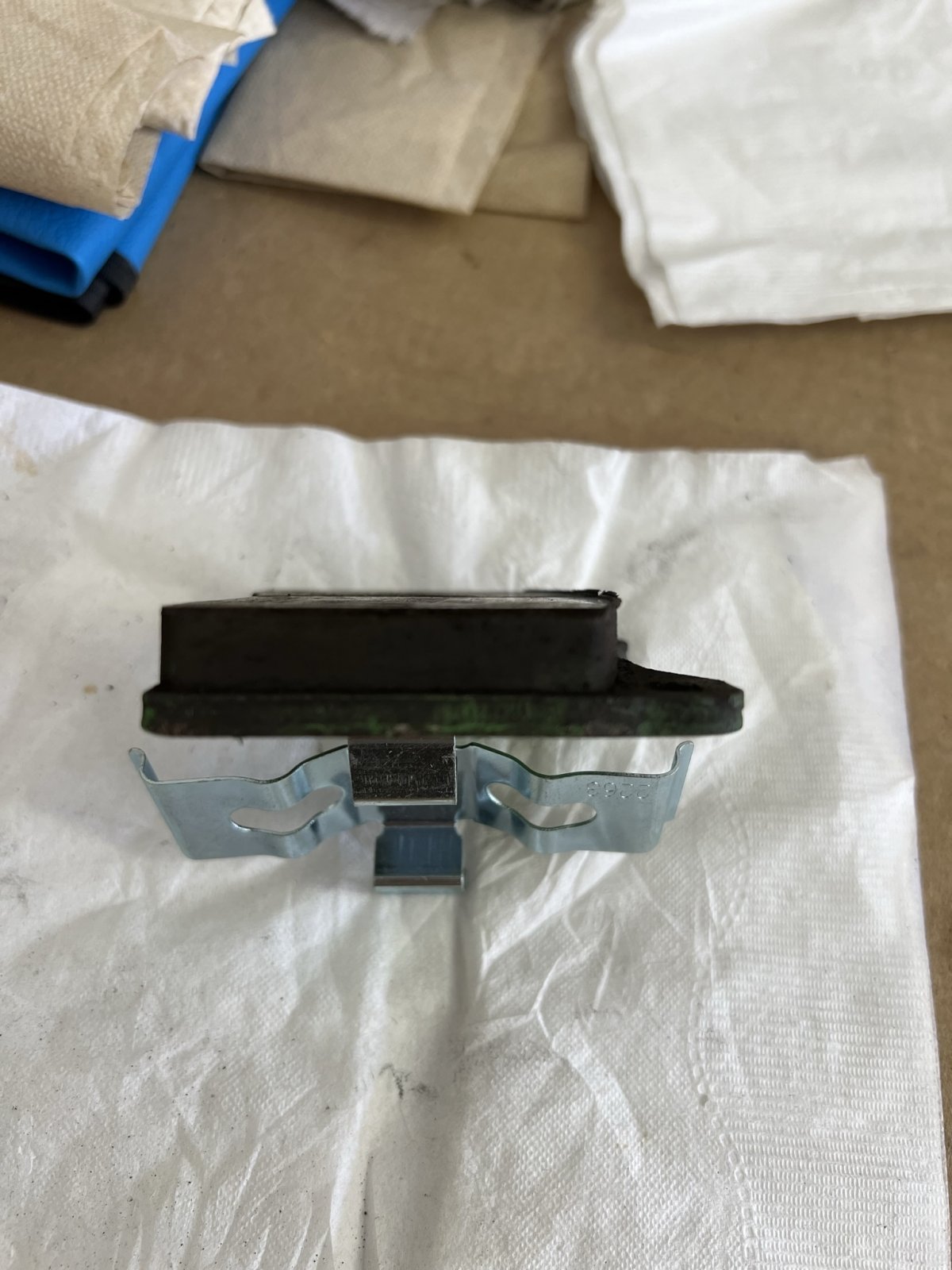

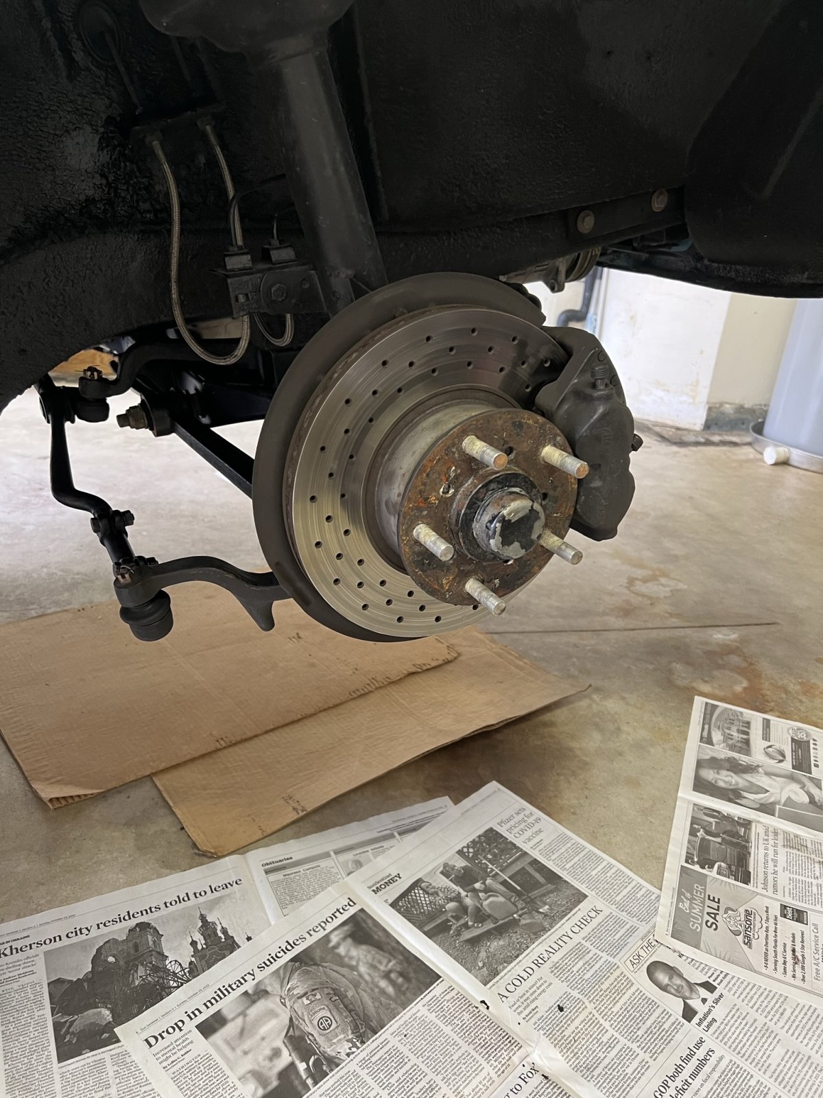

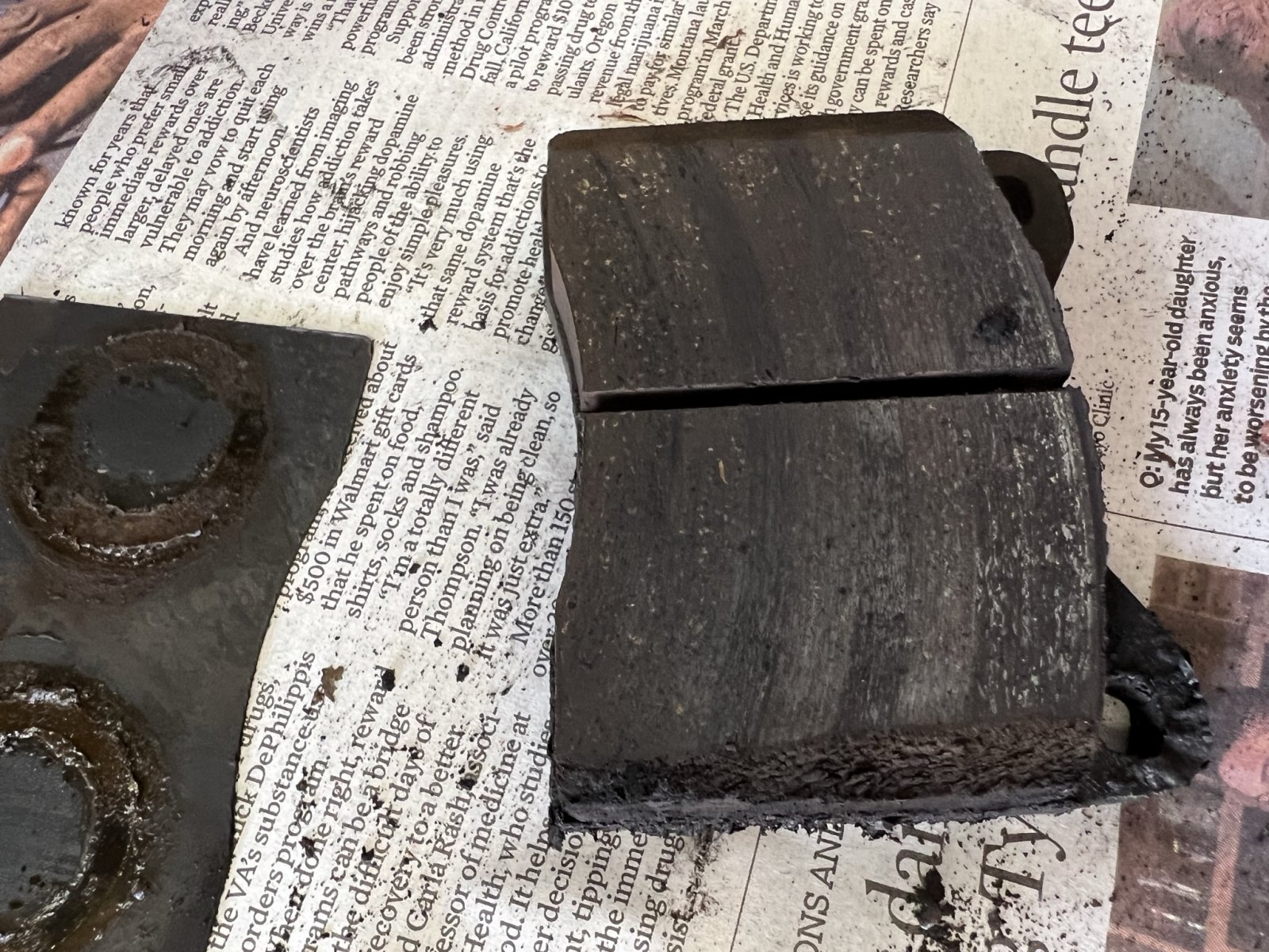

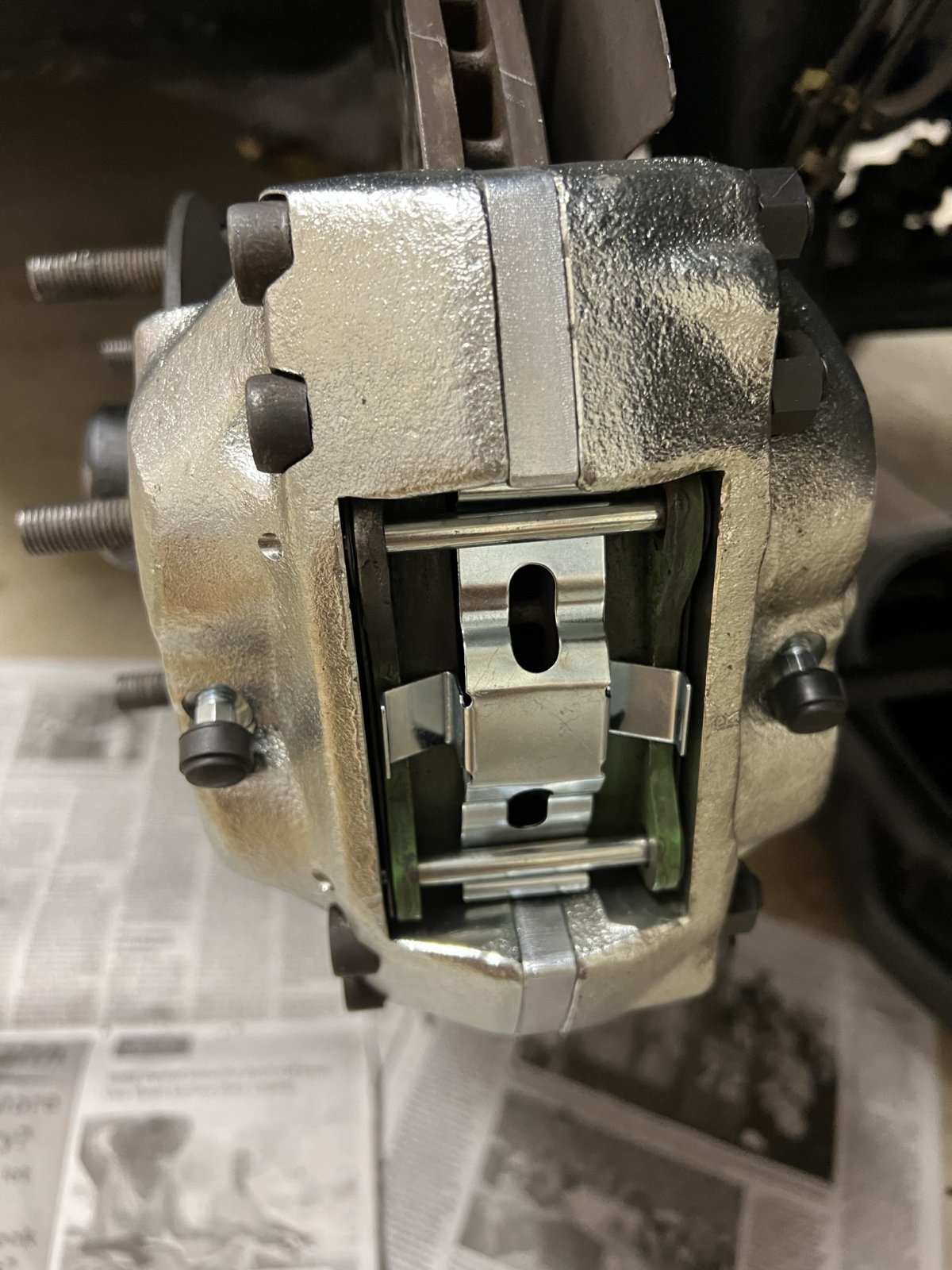

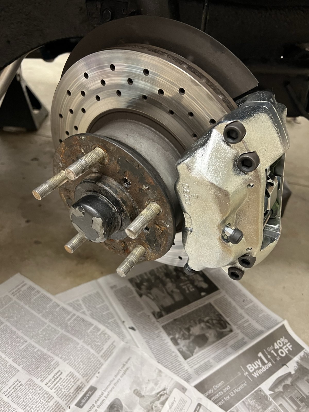

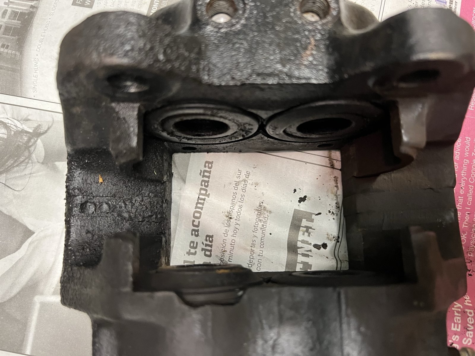

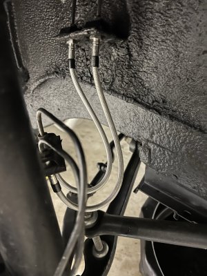

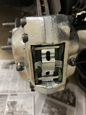

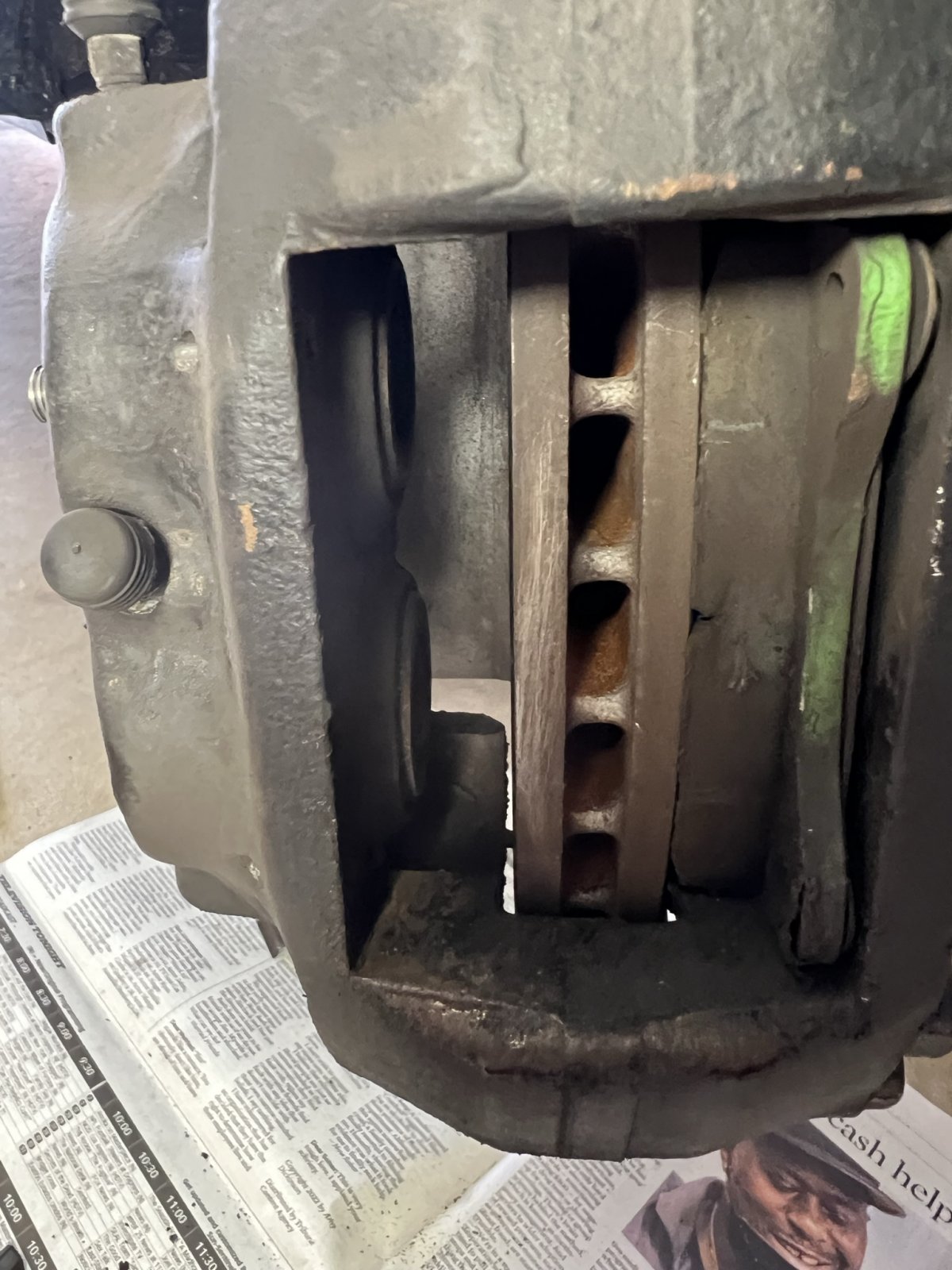

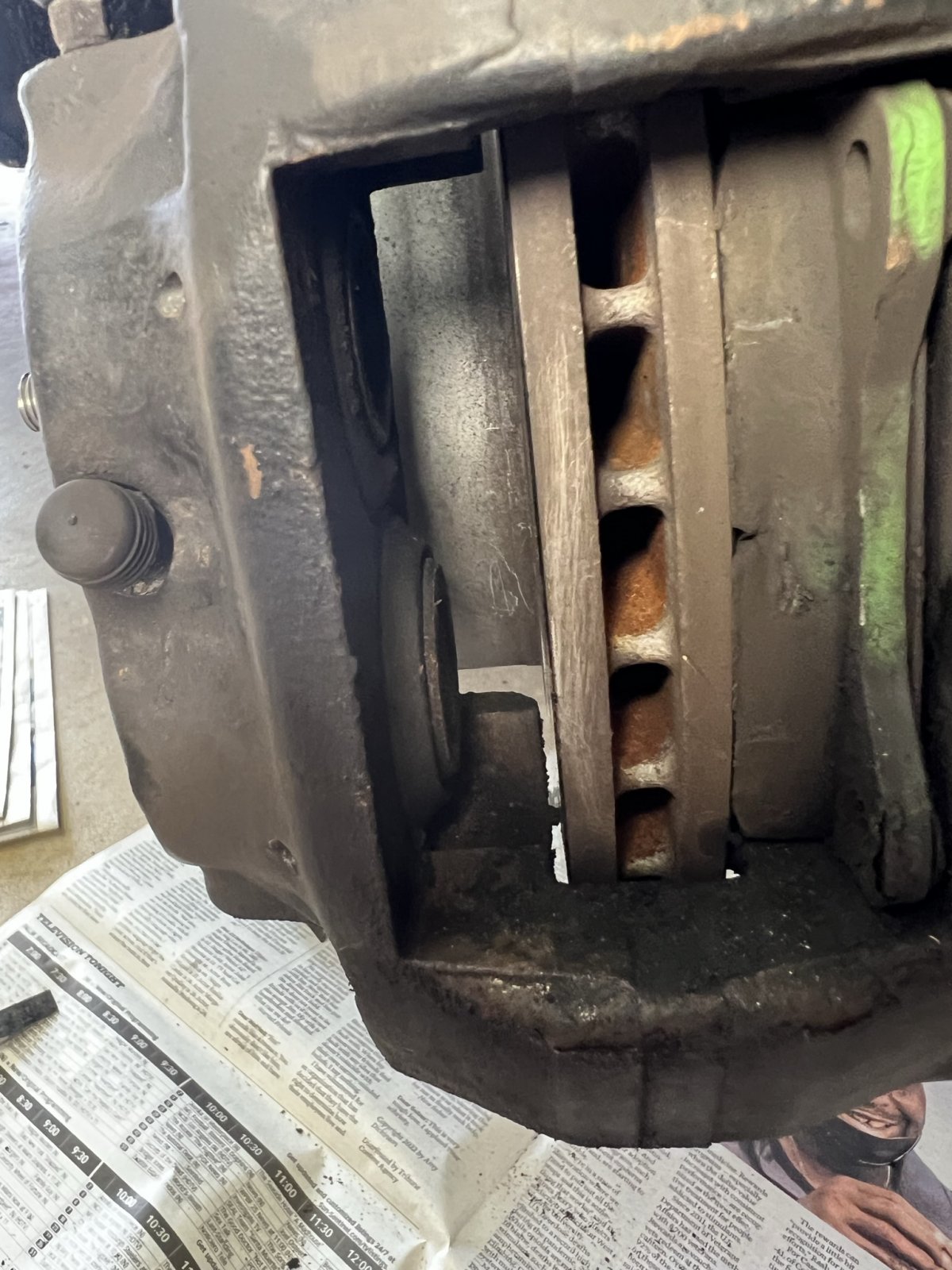

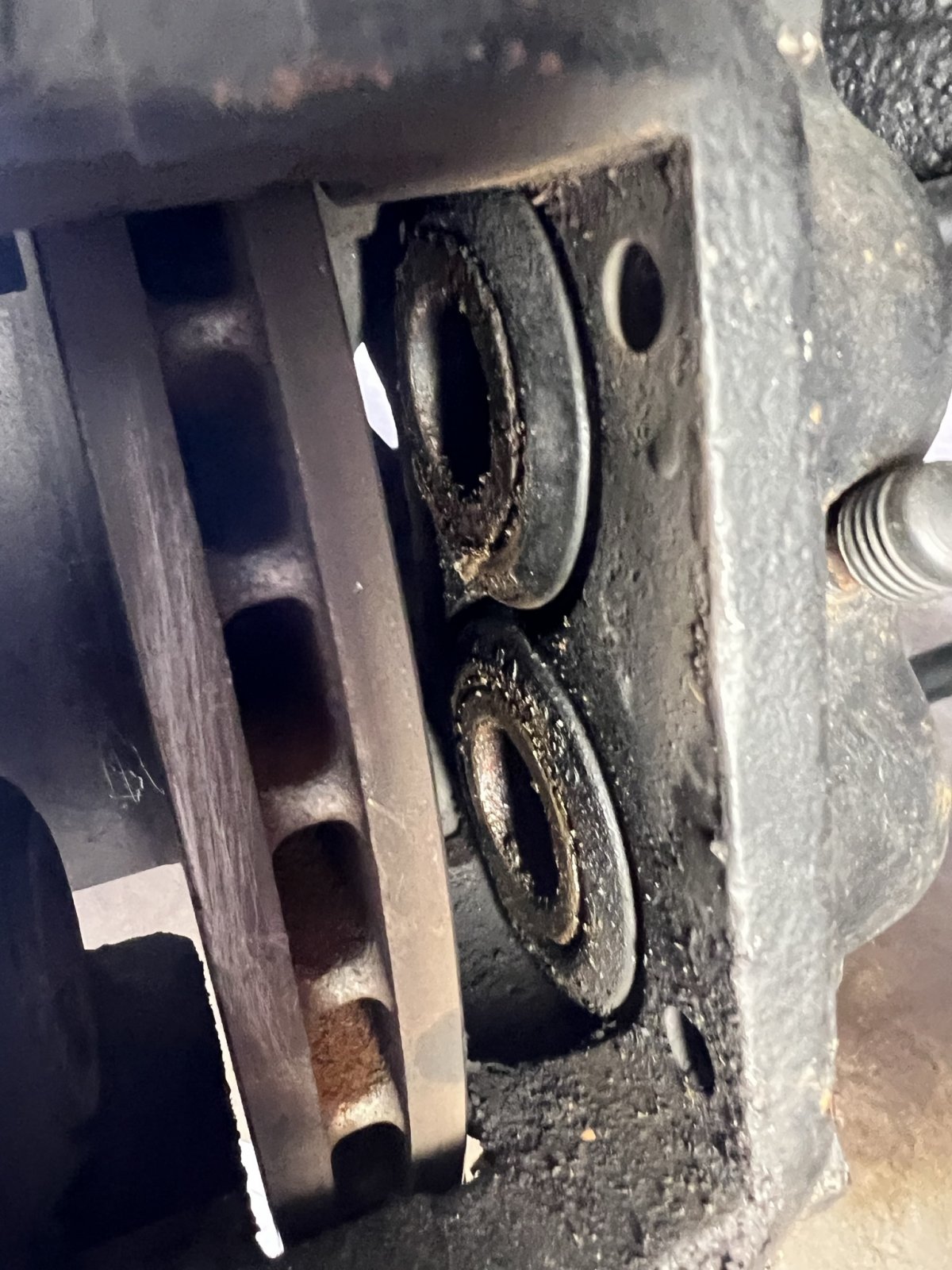

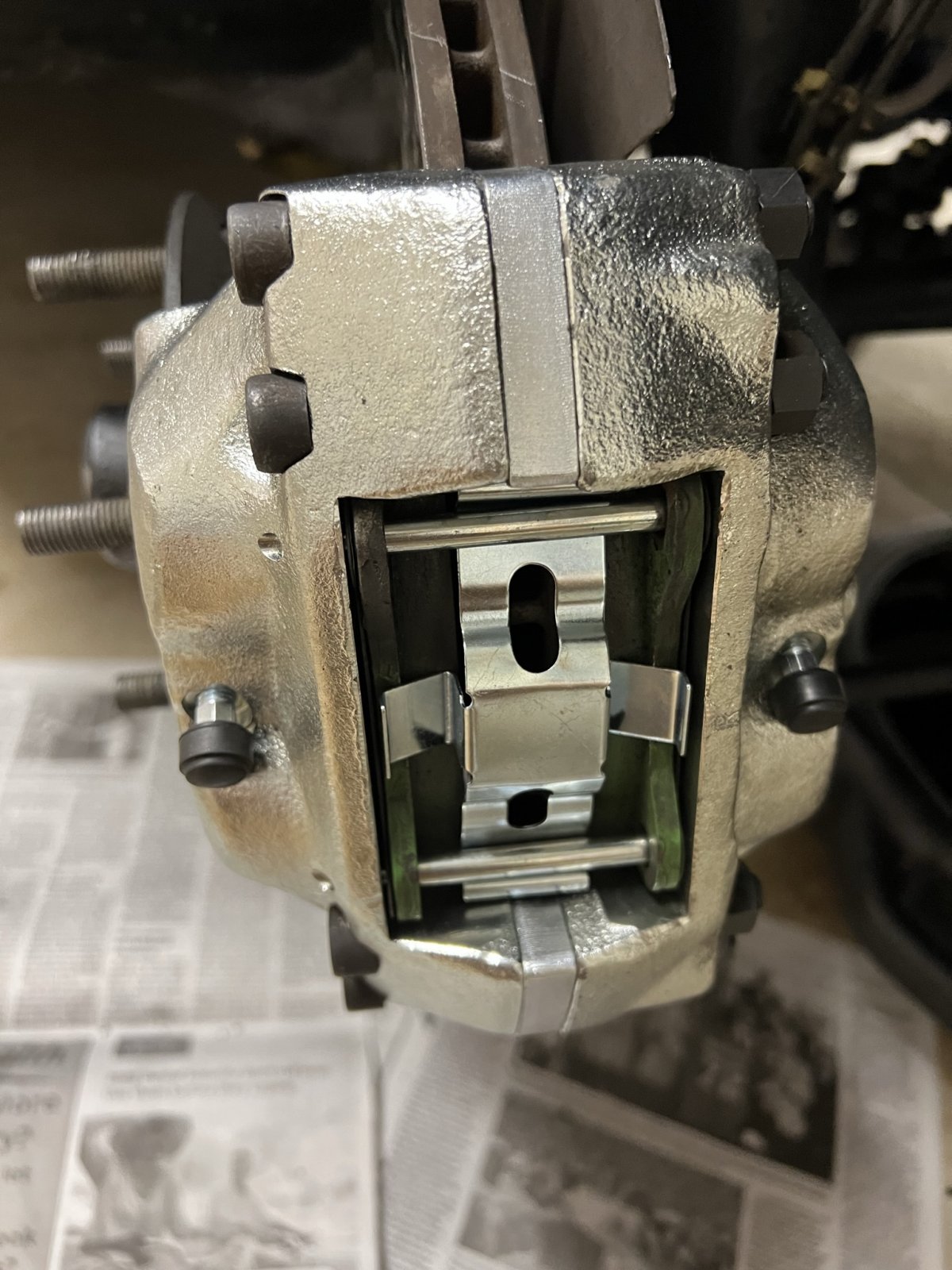

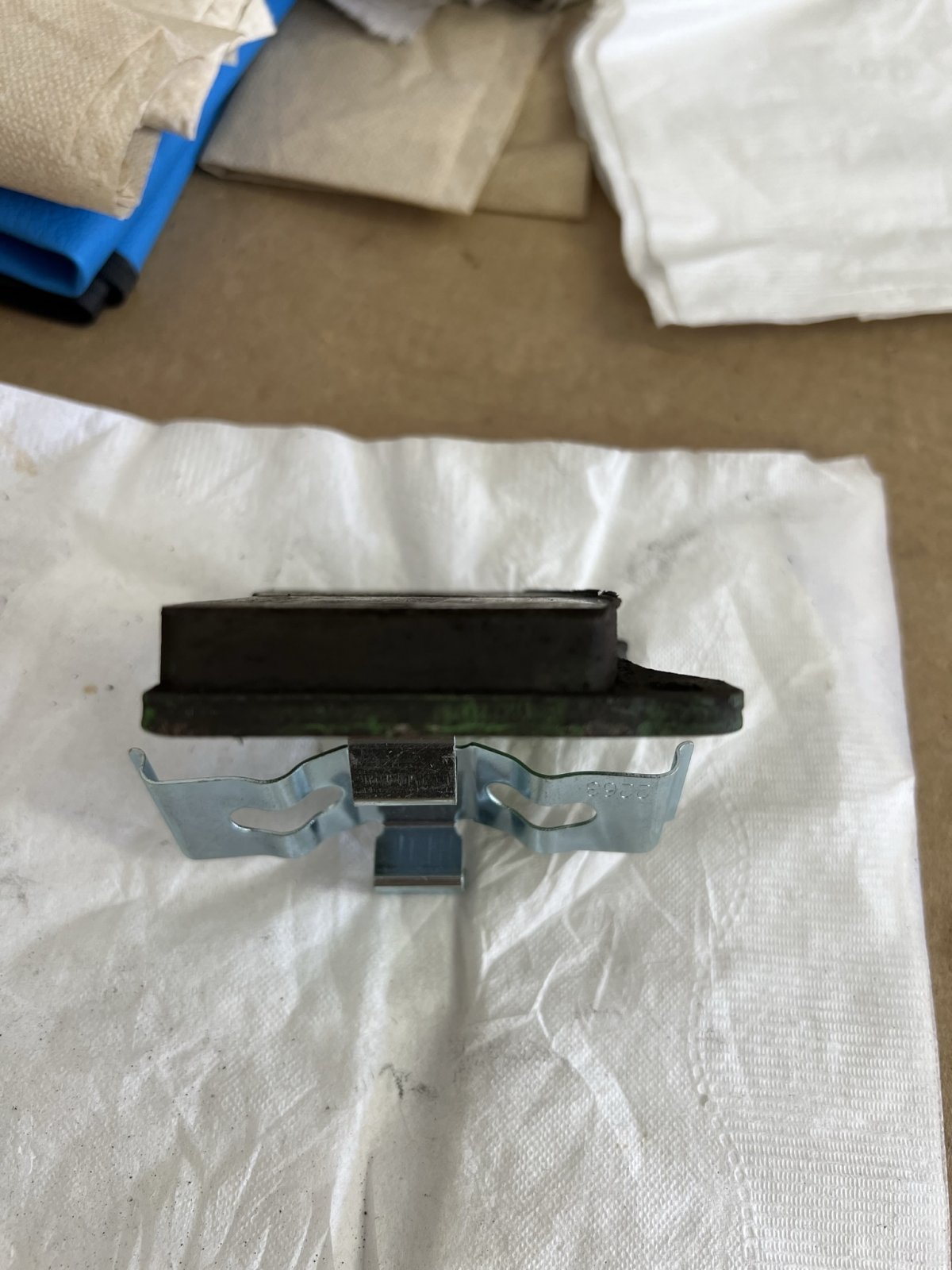

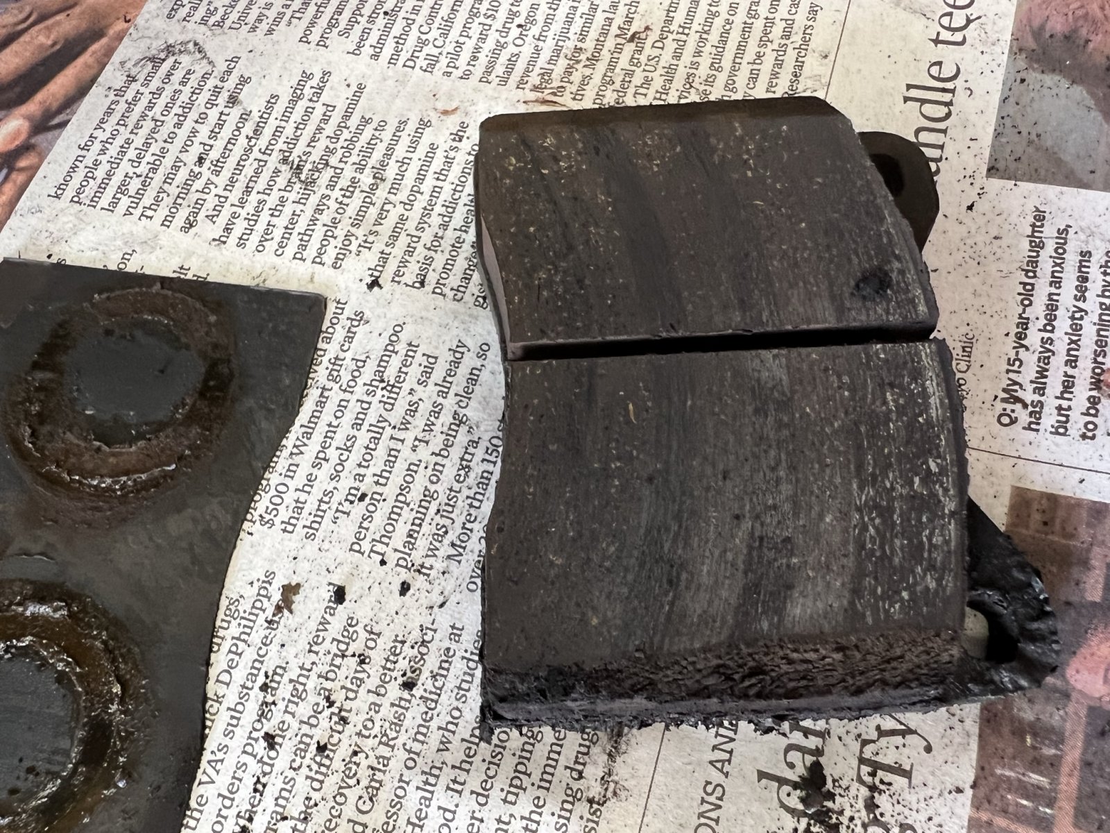

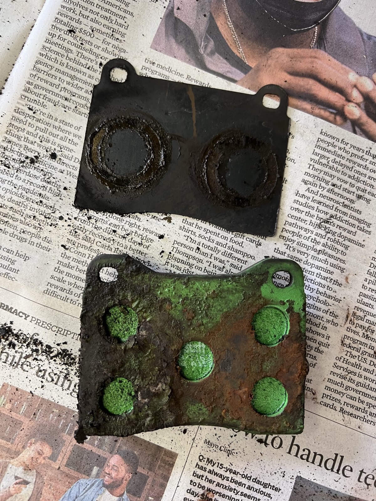

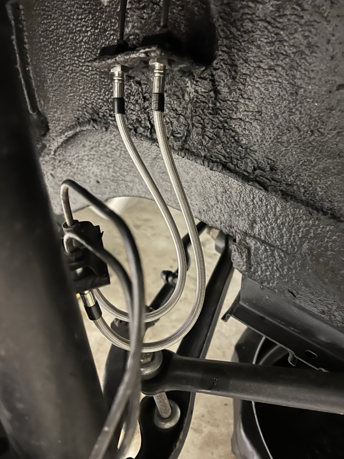

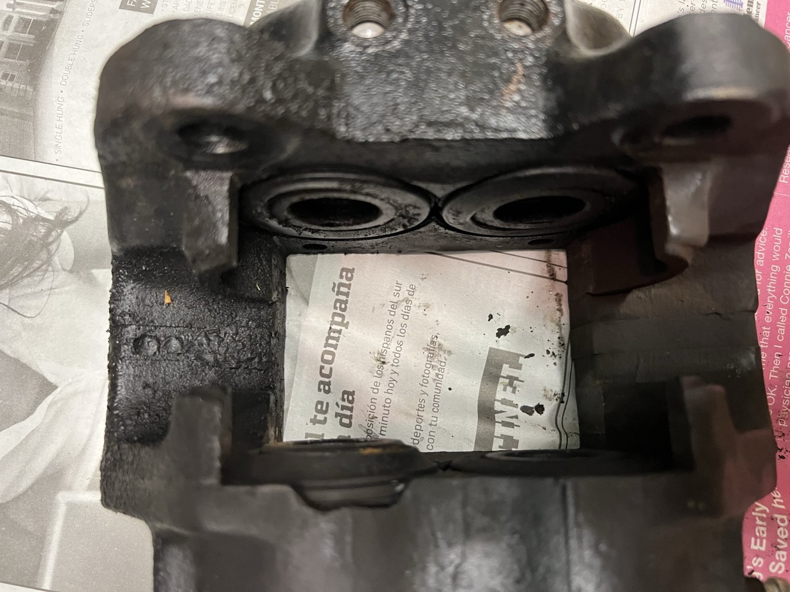

Last April I knew these brakes needed to be repaired so I bought new front calipers, braided steel brake lines, and the mounting hardware for both the front and rear pads from W&N. I also bought the Redline RL600 DOT 4 synthetic brake fluid again for the flush which I had done 3 years ago.

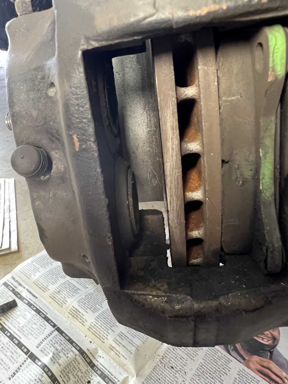

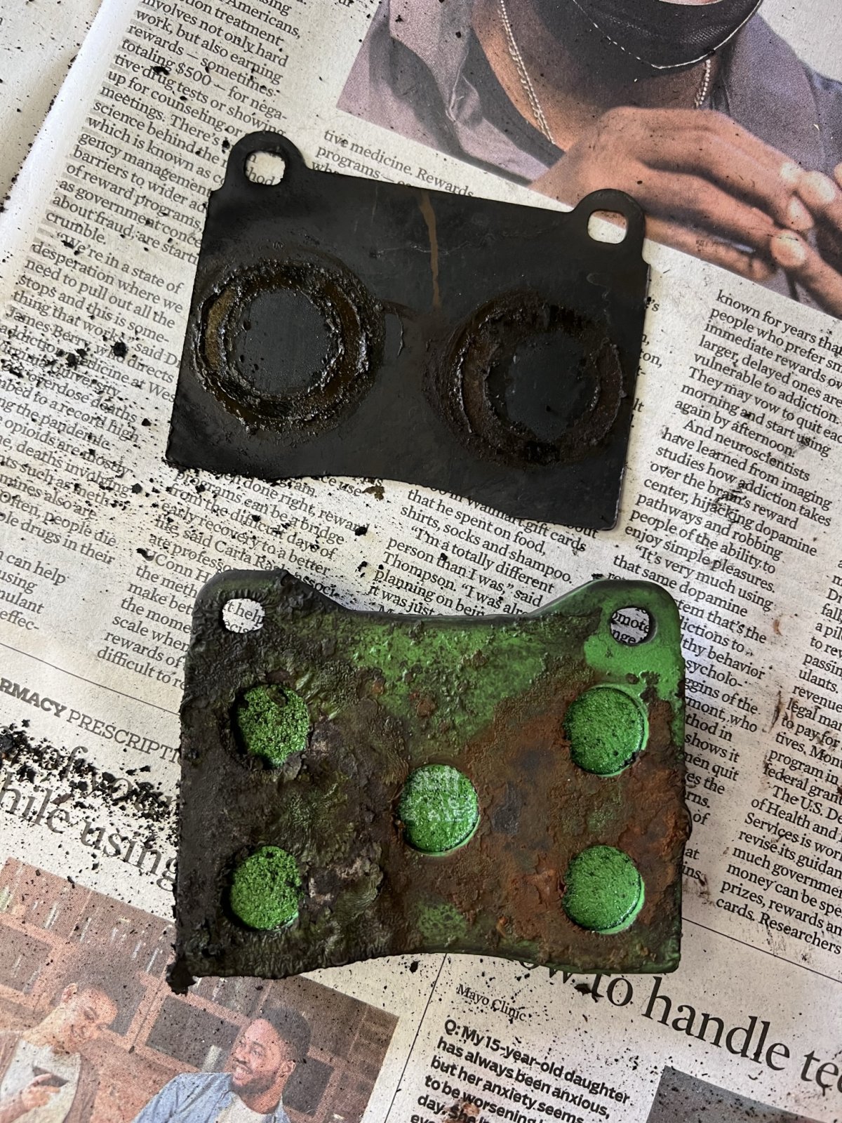

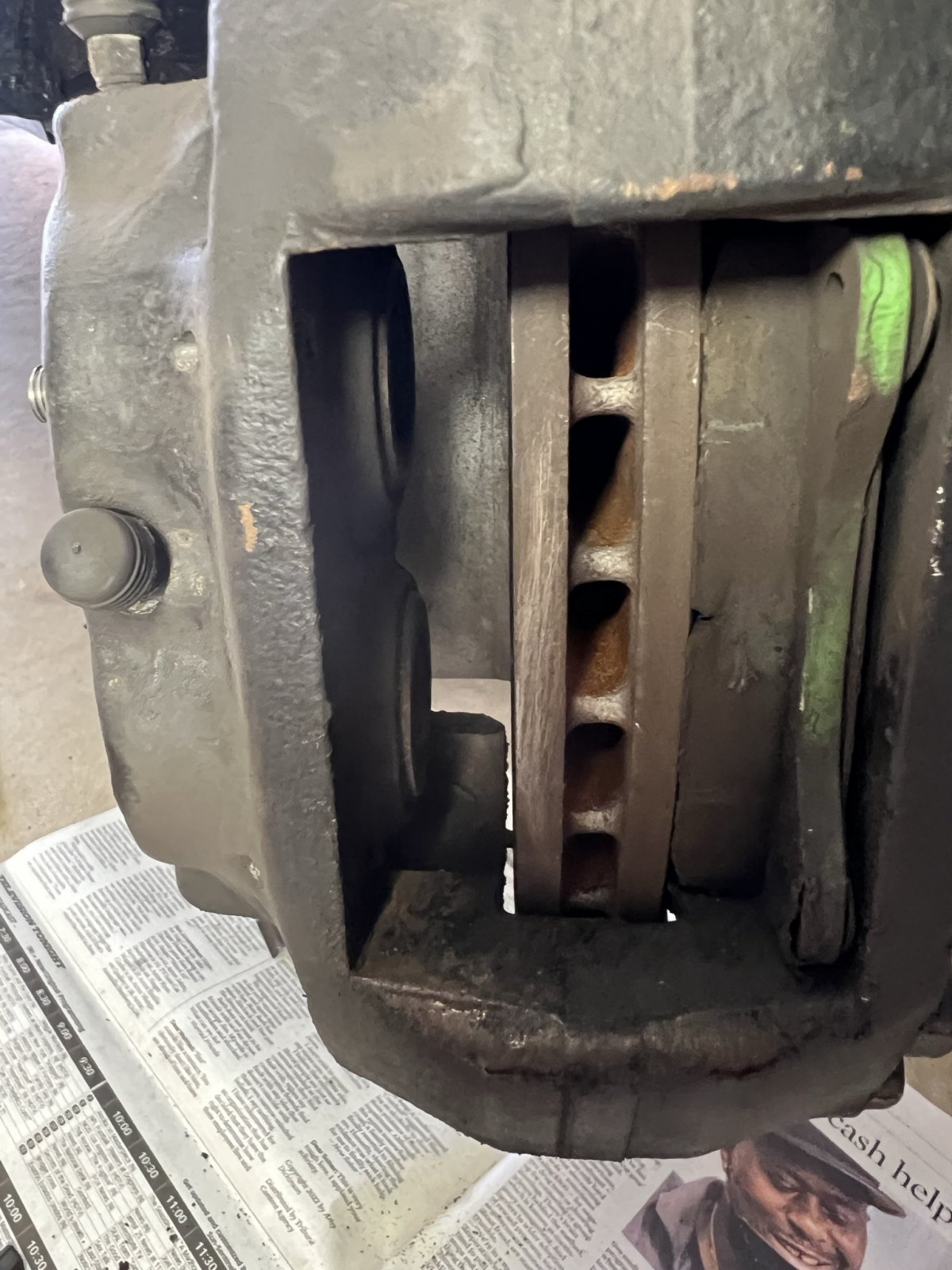

The right ATE caliper had one of the 4 pistons rusted and stuck halfway open. I figured that's where the pulsing at any brake speed was coming from. The pads were not glazed,but I used David's 25-pound metal table and 100 grit sandpaper to give the pads a nice clean surface. Then I replaced the steel hoses already mounted on the car with the new ones. The fitting is SAE 9/16" on both the existing lines and the new W&N lines. Even though I have the Snap-On 9 mm brake line wrench,it was obvious that previous mechanics used whatever they could use to grab the metal brake lines coming through the wheel well. I finally got the right caliper finished. I called David to ask him to come over Sunday to help bleed the brakes and make sure all is correct. I've done this job on the X5 and several other vehicles,but this one is different.
David pointed out that I had put the left caliper on the right side. The outside bleeder should be angled up, not down as in the pic below.

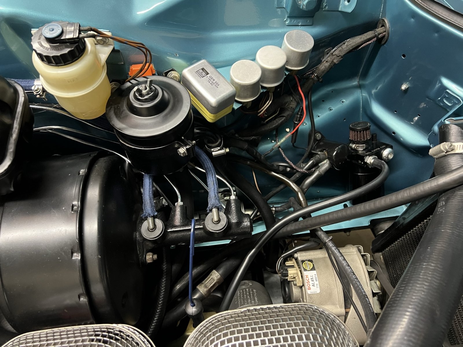

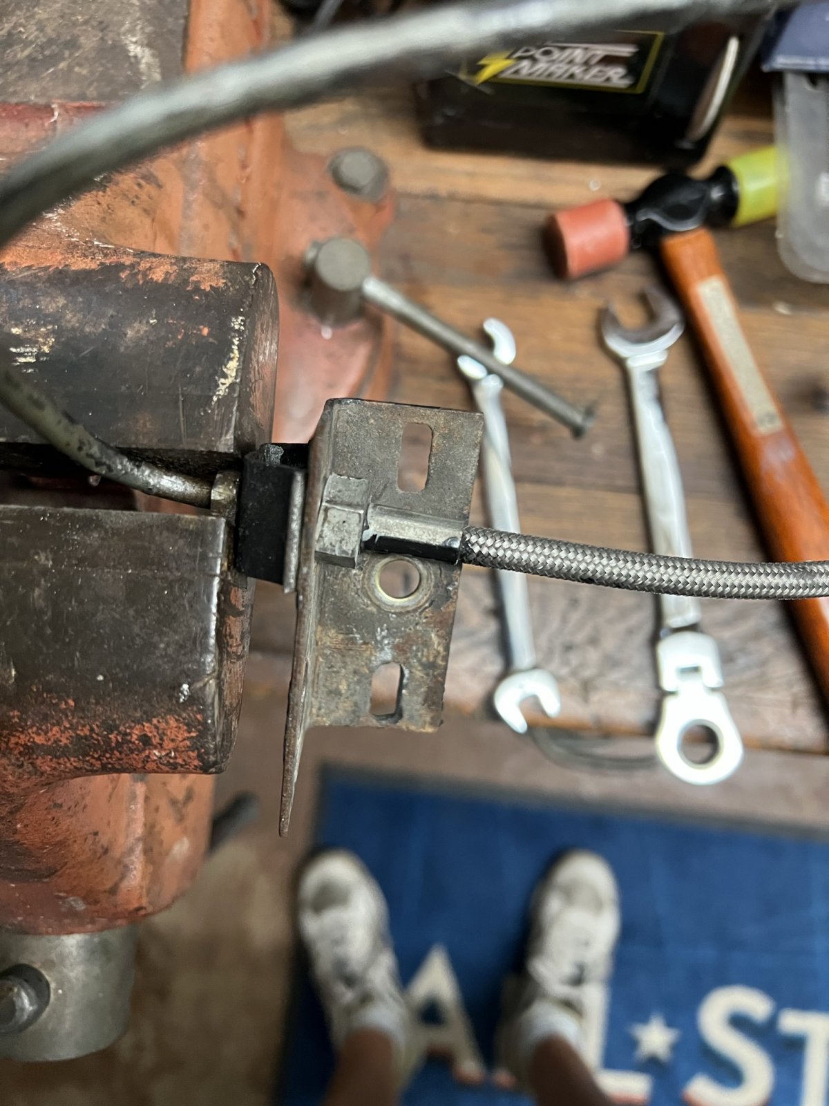

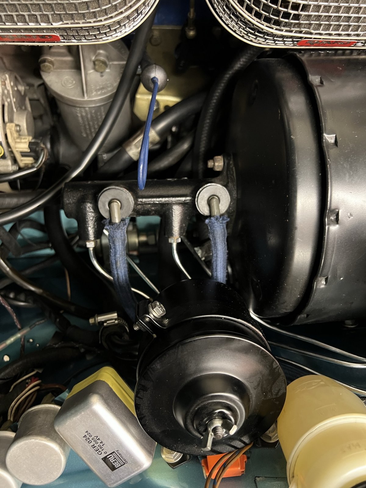

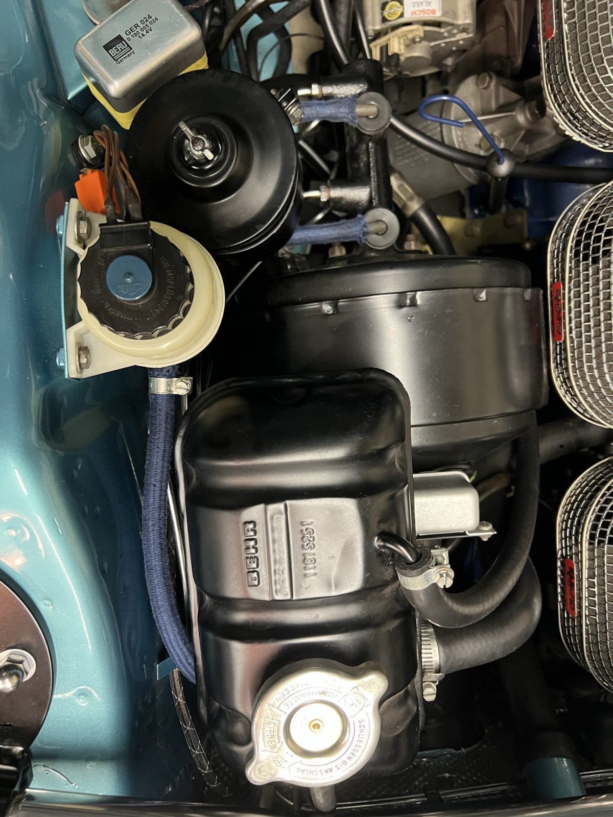

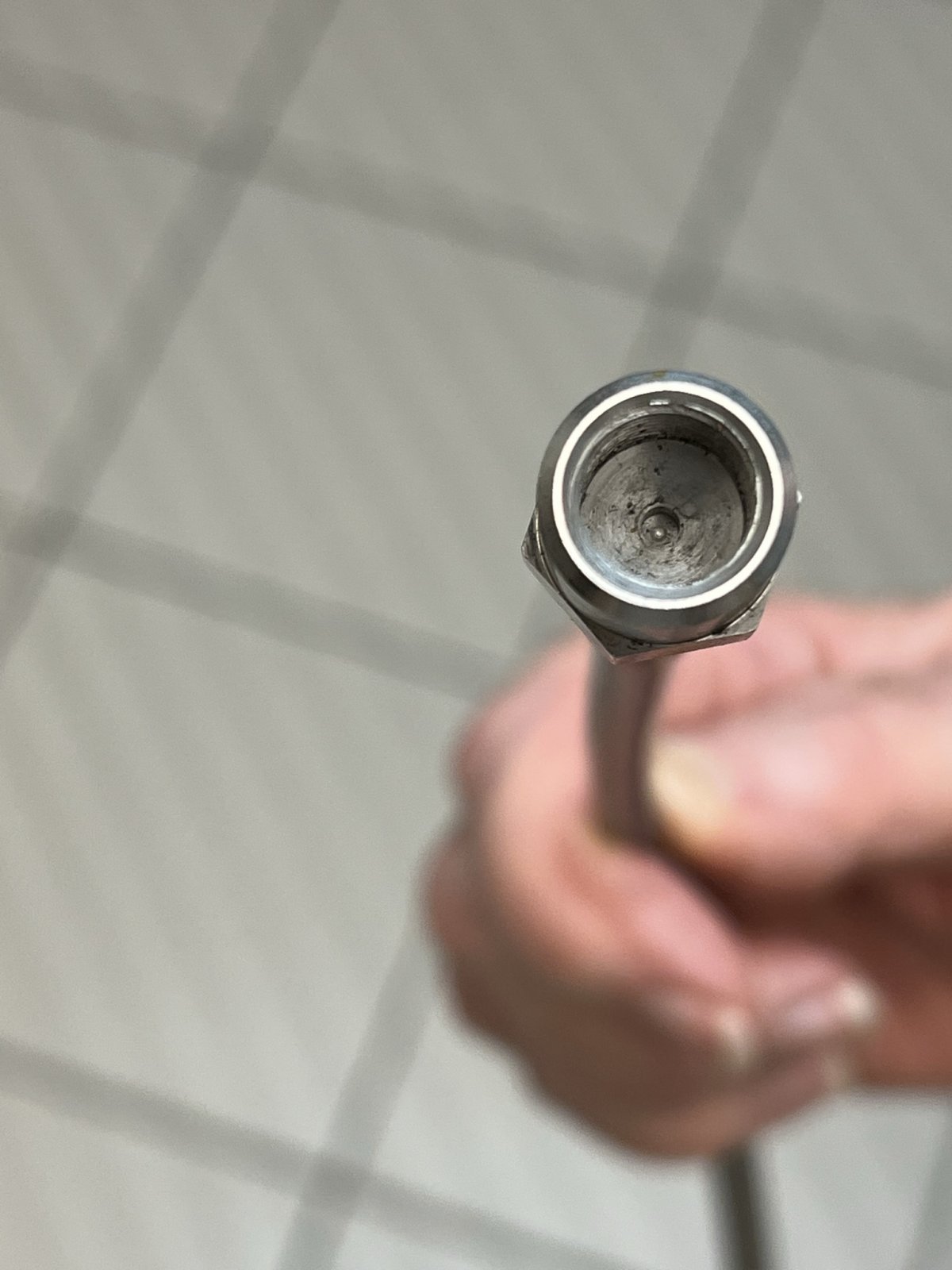

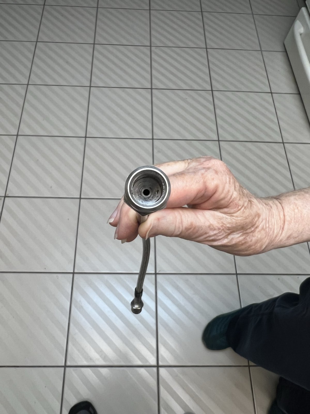

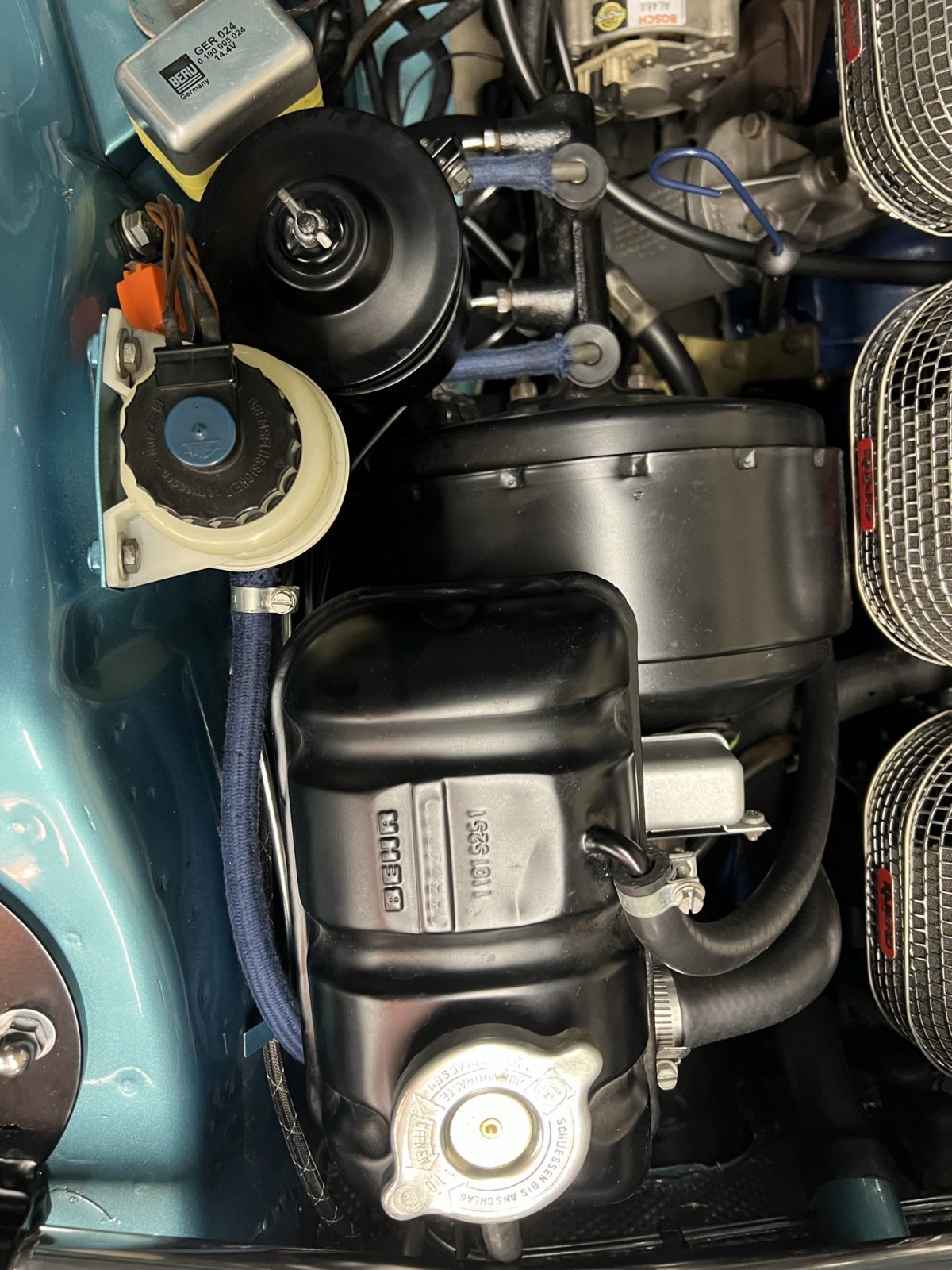

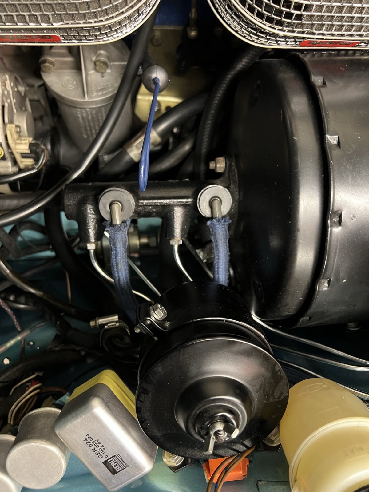

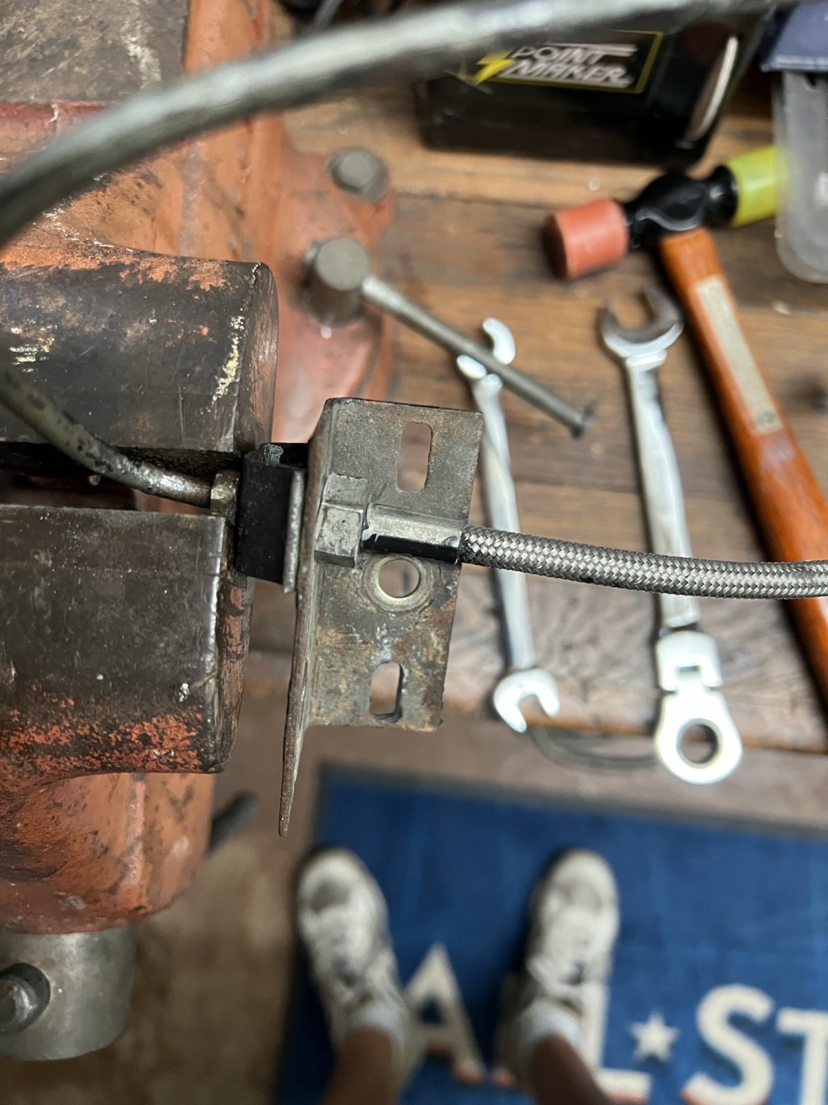

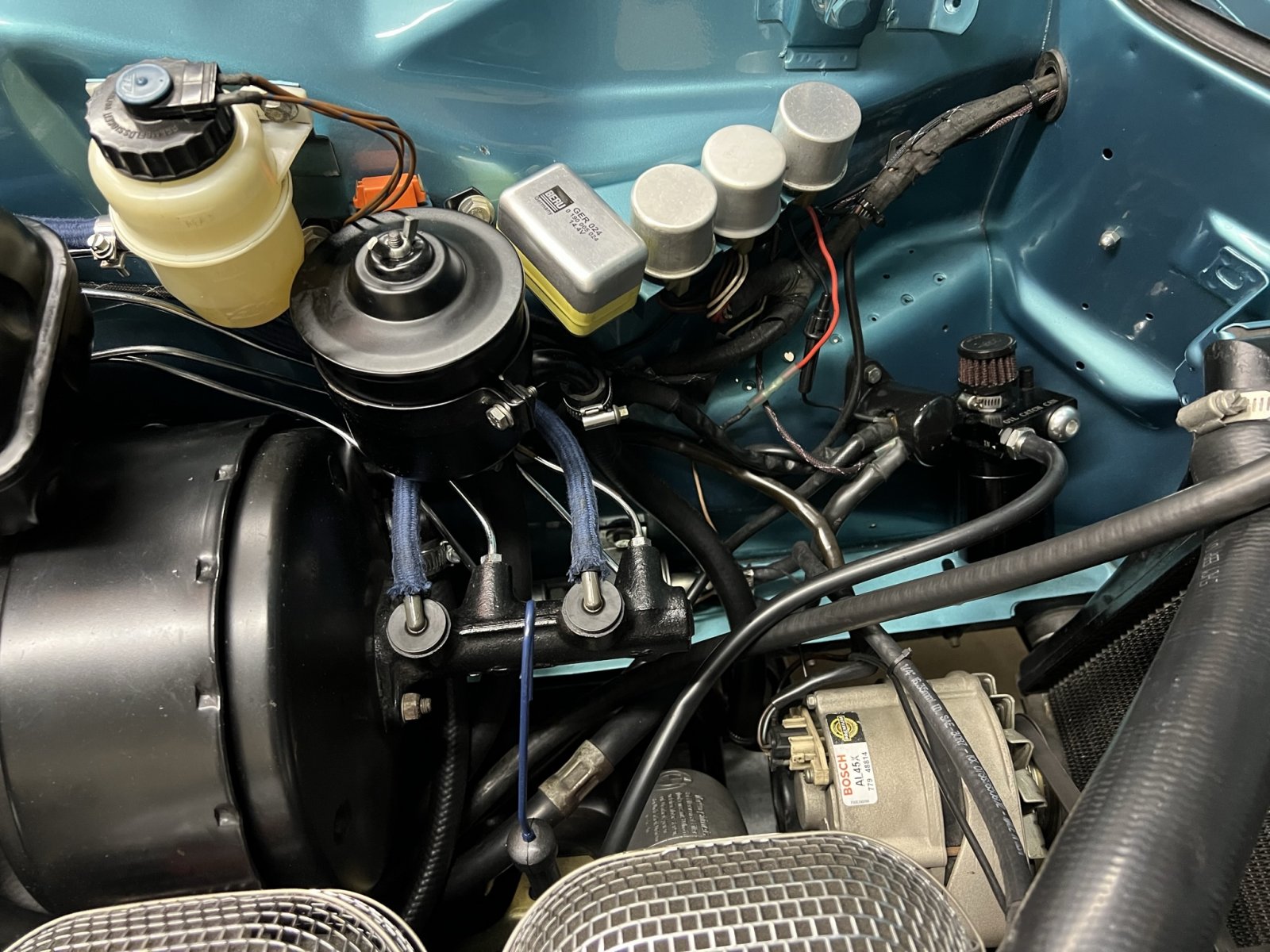

Months ago, I bought the 7.5 mm blue braided brake hose for the fluid reservoir after reading a Forum Post.. Now was the time to install it while the bottle was empty. The Resto shop used the wrong size hose to go to the clutch master. That was corrected with the blue hose.

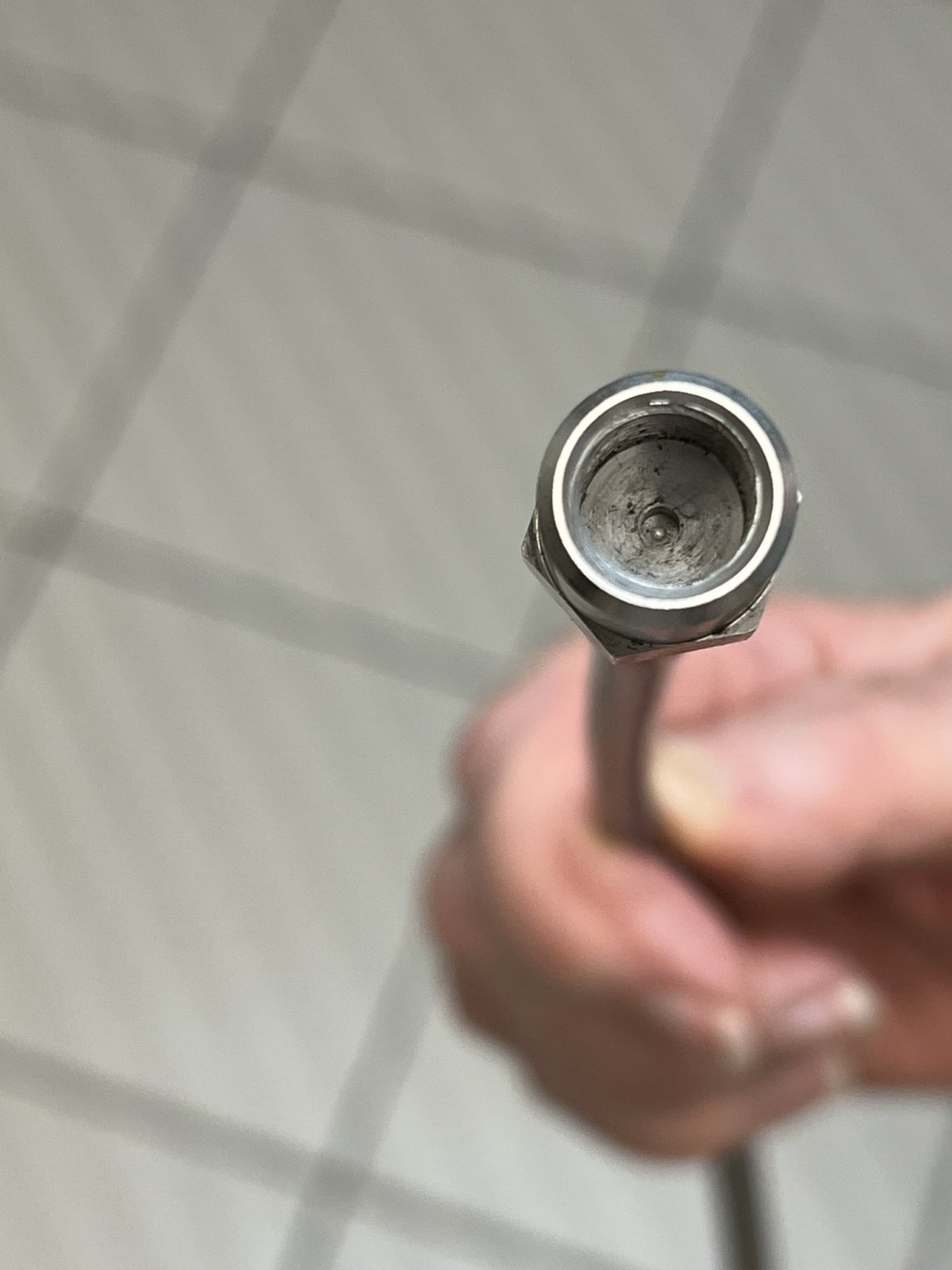

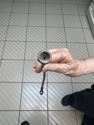

We got everything put together and started bleeding the brakes. The final line was under the front left and no fluid was going into the caliper. Just my luck that Mr. Murphy used his law to block the line fitting on one of the 6 hoses now installed. We replaced the defective hose with one that had been removed. Who'd thunk to blow through each new hose before installing them?? Here's a pic of the bad hose fitting. W&N said they would send me 25 euros for the hose.
The brakes still felt spongy on a test ride. I had the same thing happen the last time I bled them, and they required a second bleed. The car was up on the jack stands again and the second time the brake pedal pressure was correct. David also adjusted the free play in the pedal. Now the brakes have no pulsing and the car stops with no issues.

How about new pads altogether?
Steve--Buying new front pads is not easy if you want a pad that will not get your wheels black in 10 minutes of driving. EBC green pads are the only ones I could find that are lower dust. But they do dust up enough to require thorough cleaning on a regular basis. Every time I have the car up on jack stands, I remove and clean the back of the wheels.
