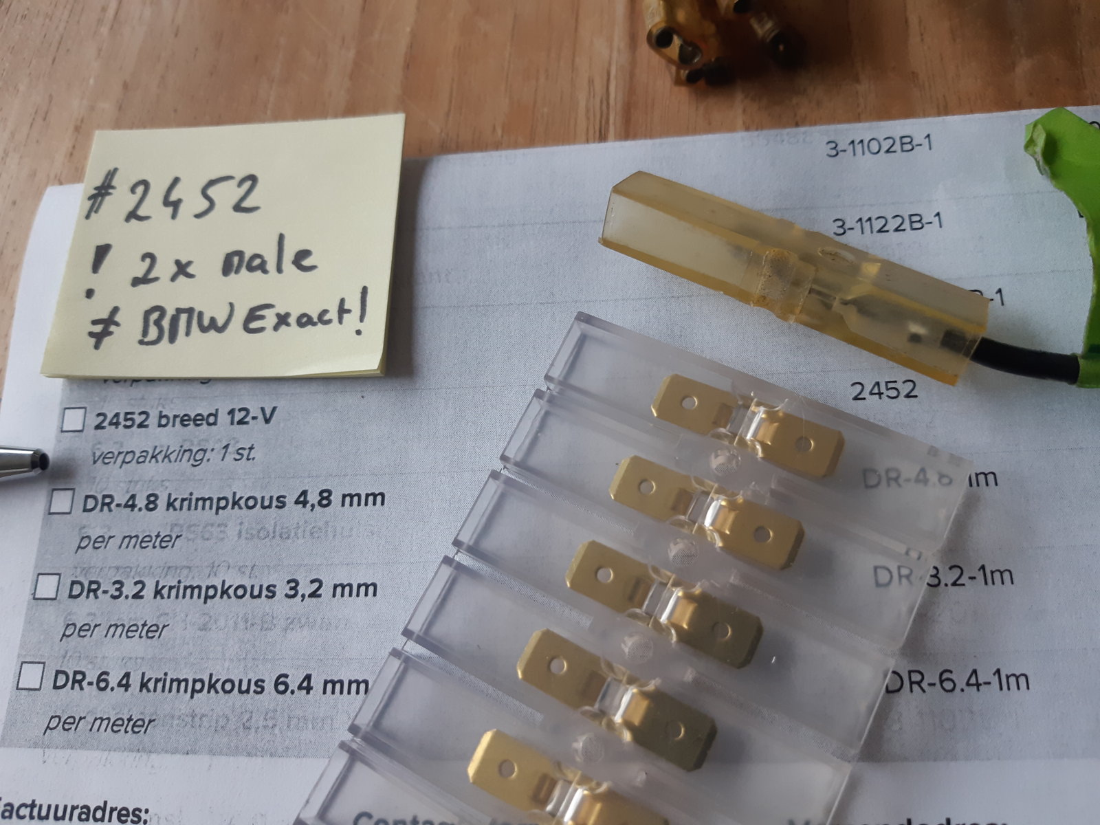

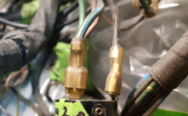

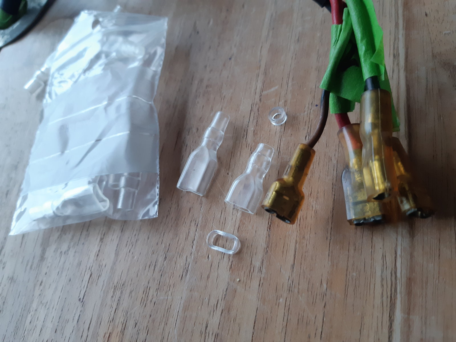

Herewith the comparison to the original parts from my car:
Conclusion:
the small PVC isolation shoes # PH- 1090-B are almost identical to the 70's BMW part. They are a bit longer, but can be trimmed if you desire.

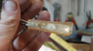

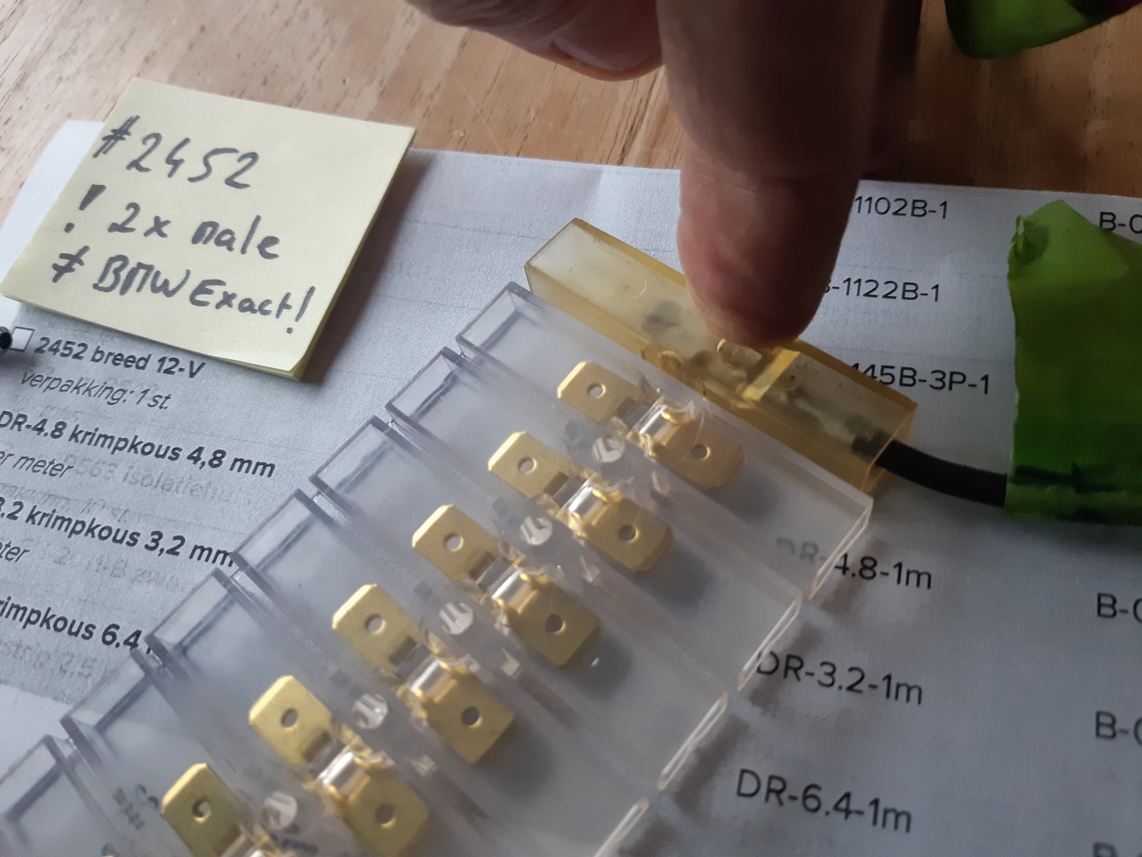

The #2452 is dimensionally quite ok, however as they have inside them 2 male spade connectors, you would need to modify the harness for it. The original BMW part has no internal connector, but a long male connector I side the terminal; this would need to be replaced by a female connector to use the RDAE connector.
