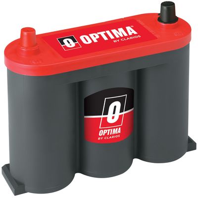

If your goal is to save weight, nothing will be lighter than a single Odyssey. But as others have said, don't take your coupe on a ski trip!
If your goal is to mount the battery under the rear seat(s), there is another alternative: two, 6V Optimas wired in series. These are rated at 800 CCA, so mechanical fuel pumps, cold weather, weeks between starts, etc. should be less of a problem. The only downside is that these things are fairly pricey.
Good suggestion, thank you Jay. But yes, at $187 each that gets right up there!
