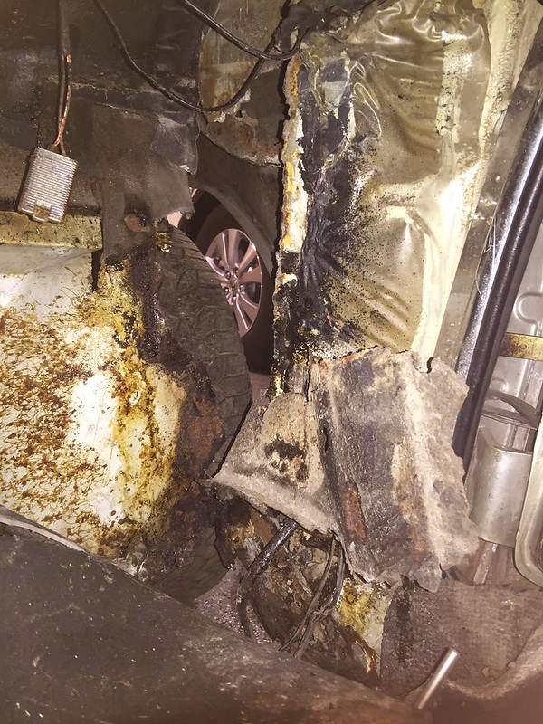

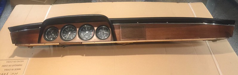

Devil’s advicate.
This was the hole in the kick panel underneath the dash on my parts car. Note you can see a good bit of the passenger front tire along with the car parked next to the e9.
This is the dashboard from the same car:
What is the key here? No water intrusion on the windshield seal whatsoever. The rest of the car was Swiss cheese.
